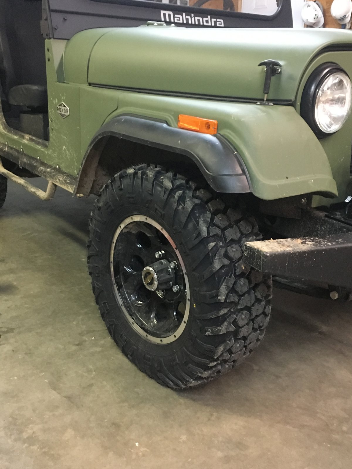

We picked up our 2019 Roxor last Friday and what stood out to me was the tires the dealer had on it. The vehicle is the Army green unit that I could not resist. The tires really made the truck look aggressive. After researching the tires they are designed for UTV's.
Great, the Roxor is a UTV, wink/nod.
The tires are made by (Motovator) and are 30-9.5x16R EFX. They have a lot of sidewall tread so when I dumped the steering stops they rubbed on the springs bad. Have 1 1/2" spacers coming to hopefully rectify.
In the meantime, is anyone else running these tires? The reason I ask is they really make the vehicle ride nice. The load rating is 1250lb at 15 psi. I currently have 20 lbs in them and it makes this leaf sprung vehicle ride tame.
I don't think the tread will last on the highway but for off-road traction and comfort they're like the old Honda Big Red tires.

I just put them on mine replacing the BFG T/A KO2s. I really like them. I’m running 1.25 in. Spacers with no rub. My stops are still in place yet adjusted for better turning radius.

Thanks for the reply. That is indeed the tire. What made you choose them and what air pressure are you running? Did you notice a difference in the ride?

I’m running 25 psi right now. They ride much better than the stickers, but I may air them down to experiment. They are a little more noisy on pavement, but not bad.
I wanted a more UTV type tire so mud didn’t stick in the narrow tread grooves of the stock BFGs. I saw these on a Roxor on a Facebook page and liked them. FYI, I went with the Spidertrax spacers. They only make a 1.25 in our bolt pattern though.

Thanks again. By chance I ended up with a set and was wondering why I didn't feel the bumps like I thought I should.
They're a fairly pricey tire too but seems worth it.
I couldn't hear the road noise when I drove ours home. Thirty degrees, wind, no windshield and watering eyes made it a challenge to detect anything.
