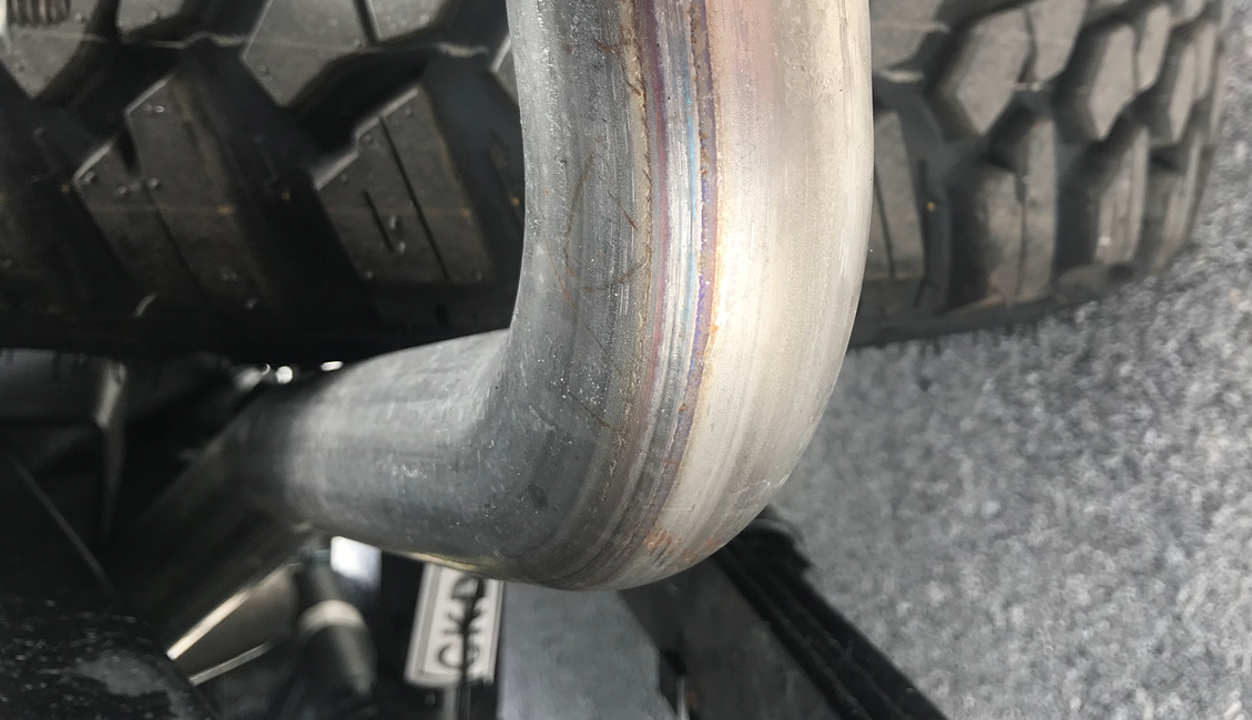

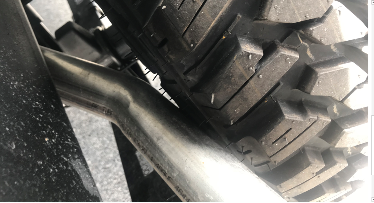

I thought I would share an issue that we noticed after swapping out stock tires for some 245/75R16 mud tires which are not much larger. The tail pipe was rubbing on tire. I didn't notice it, but it was probably too close even on the stock tires. We loosened U-Clamp and pushed the tailpipe inward and re-tightened U-clamp. Problem fixed. Just wanted to post this you can look for same issue on yours whether it has stock or different tires on it.

Thanks for pointing this out. Mine was really close also. Wasn't touching but it was CLOSE. A quick adjustment dialed it in.

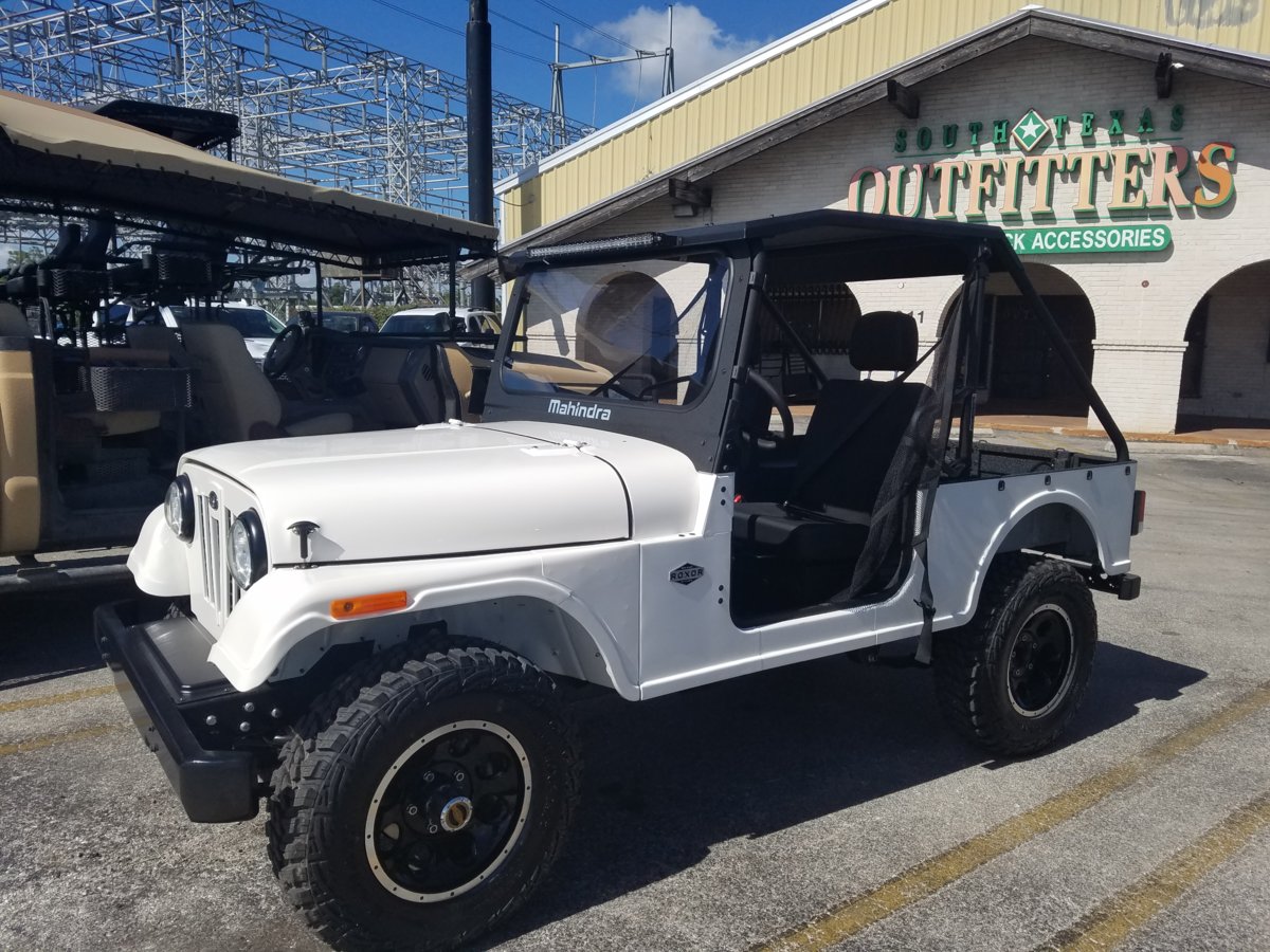

Good info! I was thinking about getting the same size tires. Do you have any other pics with those tires on your rig?

This picture isn't the best, but I'll post more when I get her back from South Texas Outfitters.

ANY other issues with tires that size ?? Thinking about upgrading to something more aggressive
Zephyr
Aug 20, 2018
15
Seguin, TX, USA
Tires are performing great with this size. Still thinking about reverse shackle for a little more clearance. Turning radias sux.
