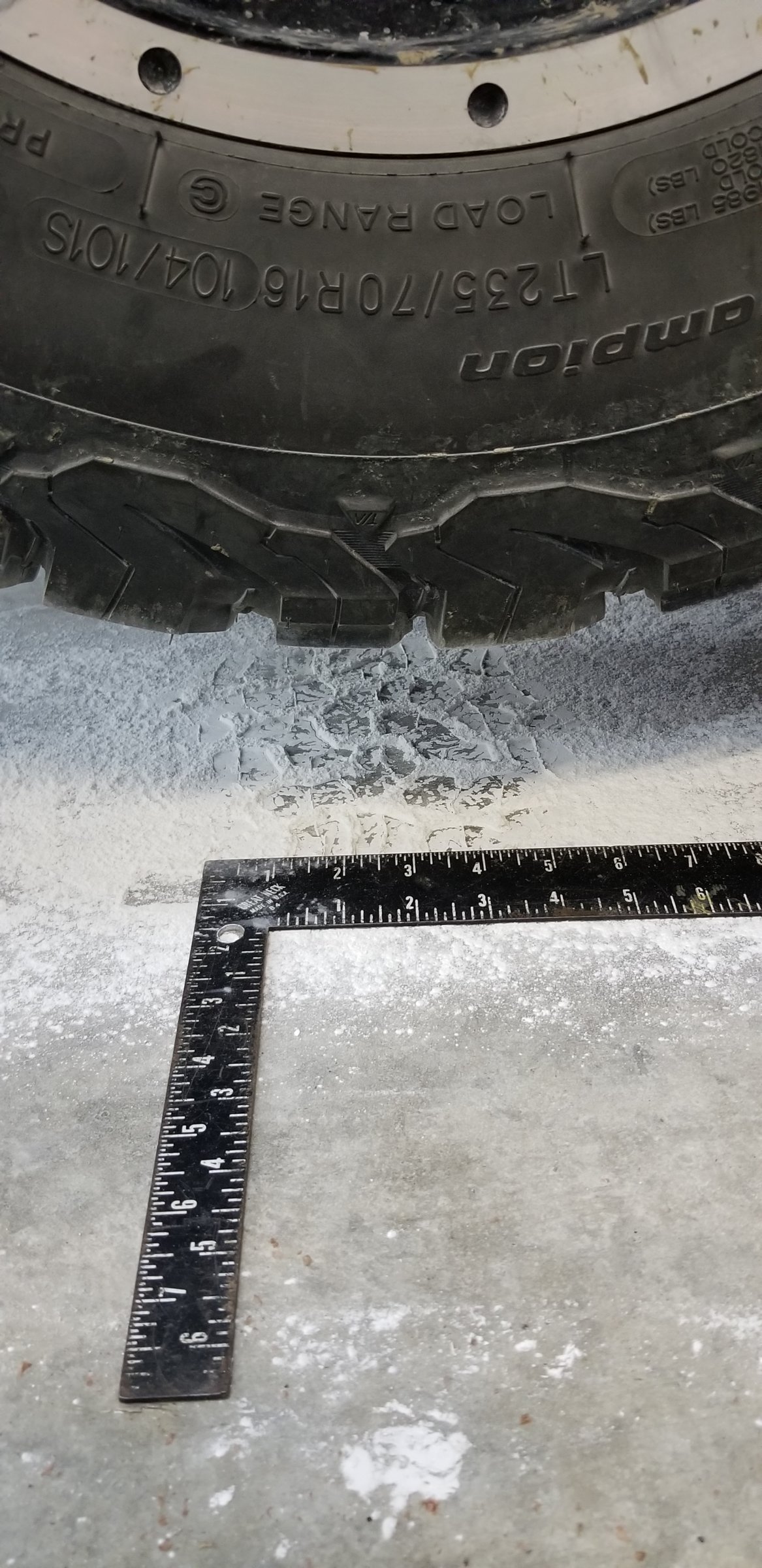

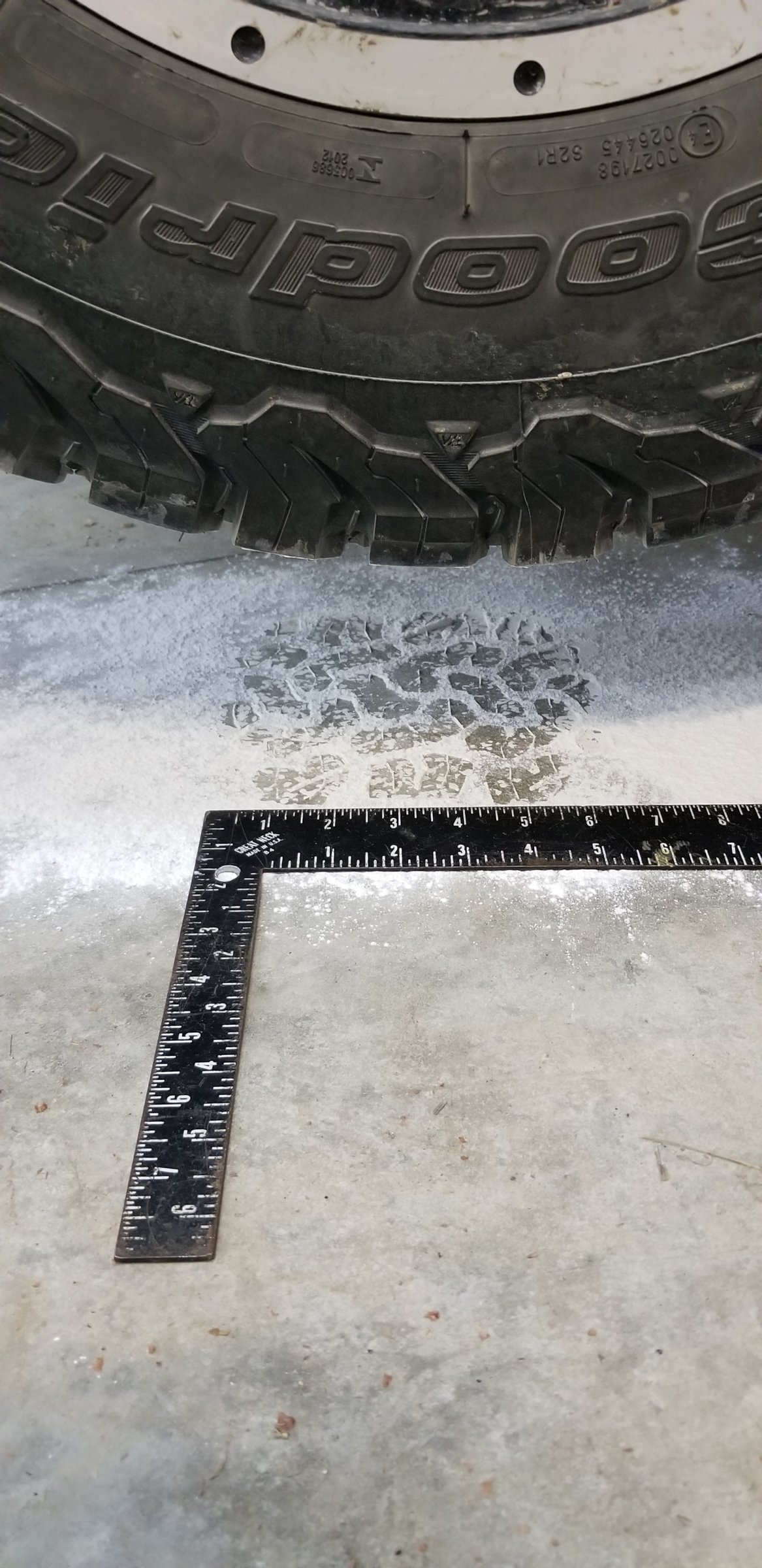

For ease I only measured footprint on the front drivers tire, since the front will have the most weight. Just used a jack and some baby powder.
At the recommended 28, the front had 5 in of footprint. The back probably had less but we will stick with 5. I lowered my front to 20 and rear to 18. This gave pretty even tire squat around. At 20, I had 6.5 in of footprint. The math is in the photos, figuring 8 in wide tread pattern.
