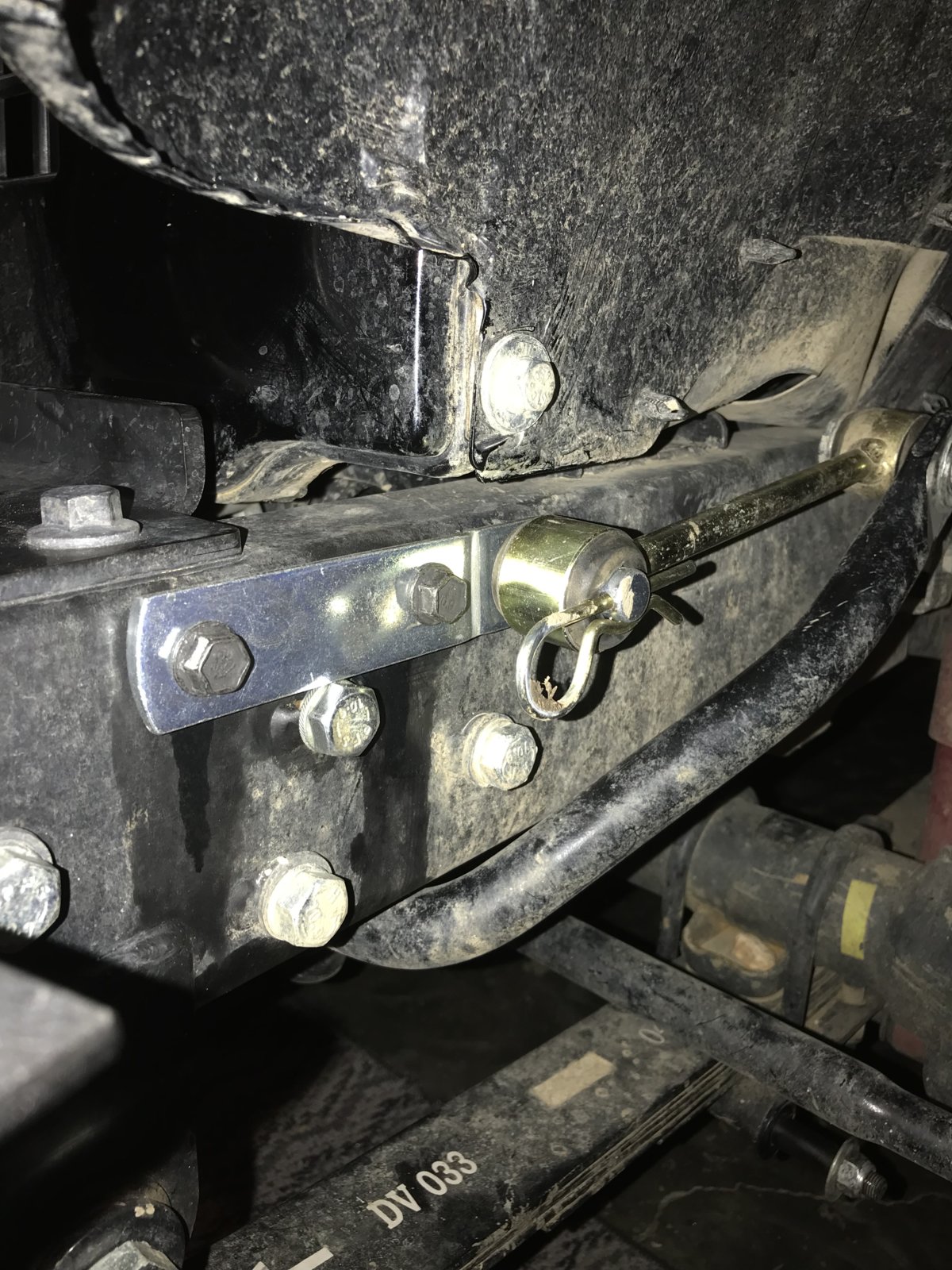

Made sway bar link brackets to hold sway bar up and out of the way. And the brackets keep the links on the Roxor so they don’t get lost! Still need to wrench to disconnect but no big deal. Haven’t tried “no links” yet but ready! Thinking brake lines and shocks will be an issue but haven’t lifted so maybe not. Running 32” tires though. Let y’all know how much stuff I break!

Here’s what I did to stow links and hold sway bar up out of the way. Switching from connected to not is a pain because the links won’t swing clear of bar. But an appropriate link that disconnected in the middle would fix that. And the connection to bottom of leaf spring pack is a weld on stud so no good way to modify to a pin?
At least all the pieces are there so won’t get lost. And really only a few minutes to put back to stock. Put bracket on both sides. Tapped for M8 bolt
