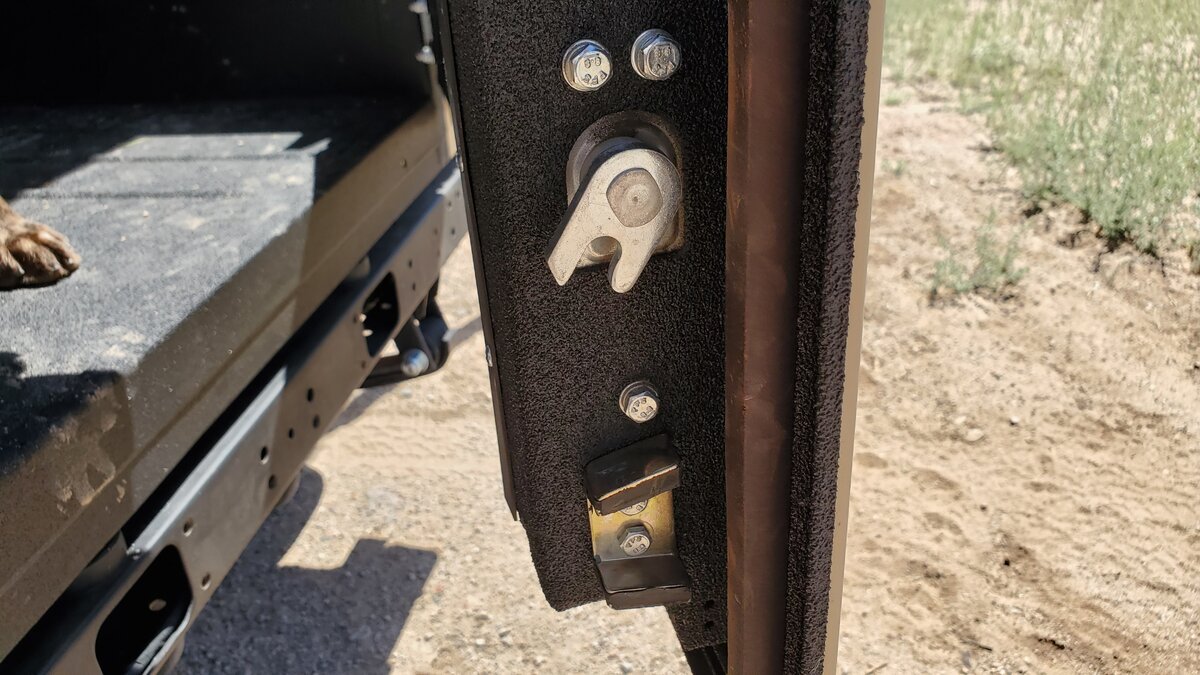

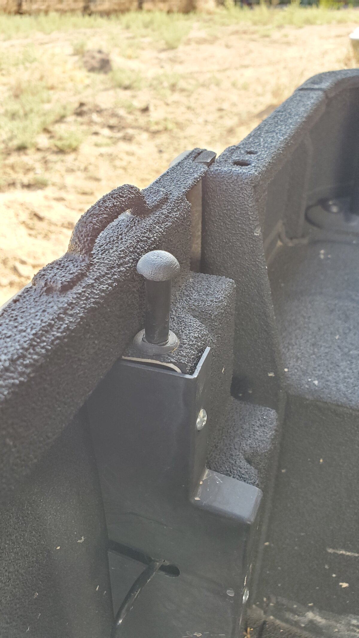

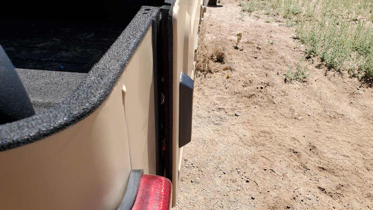

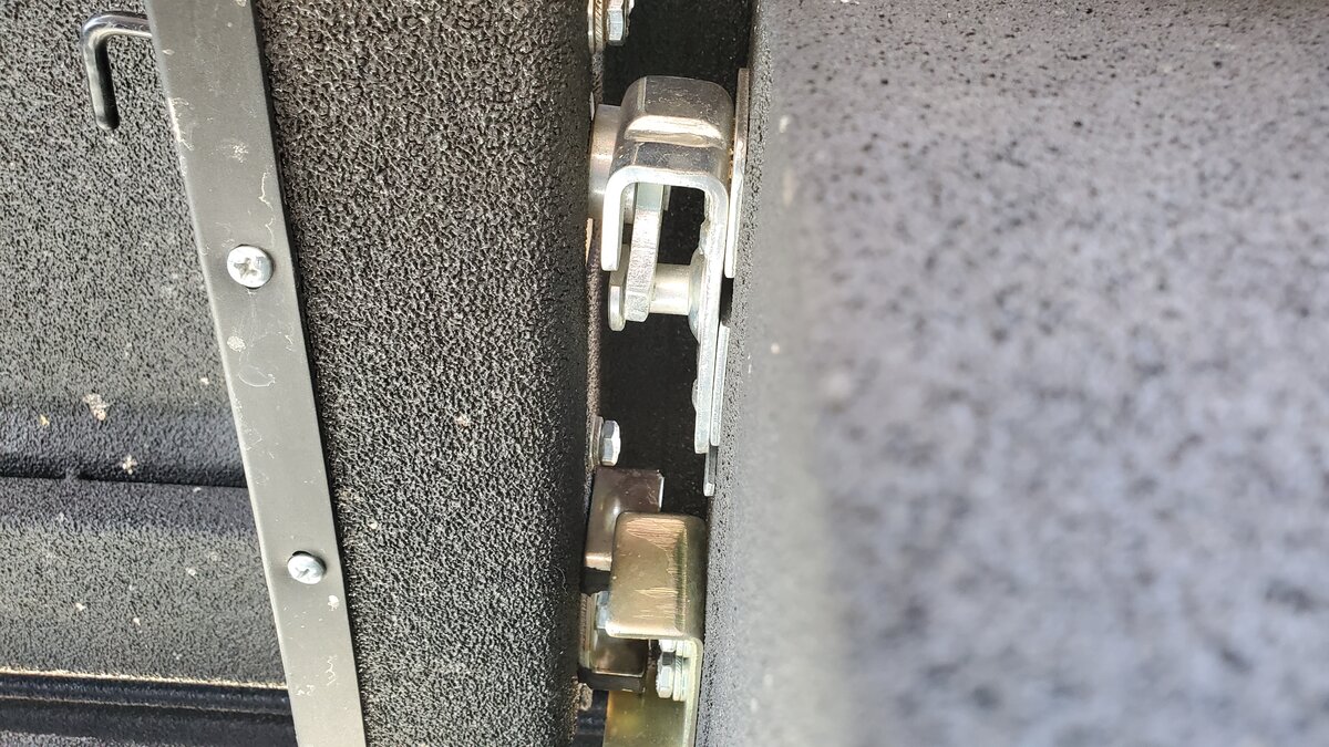

Morning everyone. Just took delivery on a 2019, and these things are pretty rad. I do have an issue that I'm hoping to get some help with.
When I close the tailgate, it only closes to the first click (latch rotates down one position), but even if I apply a large amount of force I cant get it the latch to rotate to the second closed position.
I took the plastic cover off (three screws) to take a look at the mechanism. Im not seeing the ability to adjust anything, and am wondering if there's a trick someone can throw my way.

Also, the lock seems to be stuck in the unlock position. Does thr tailgate have to literally be closed to woek this?

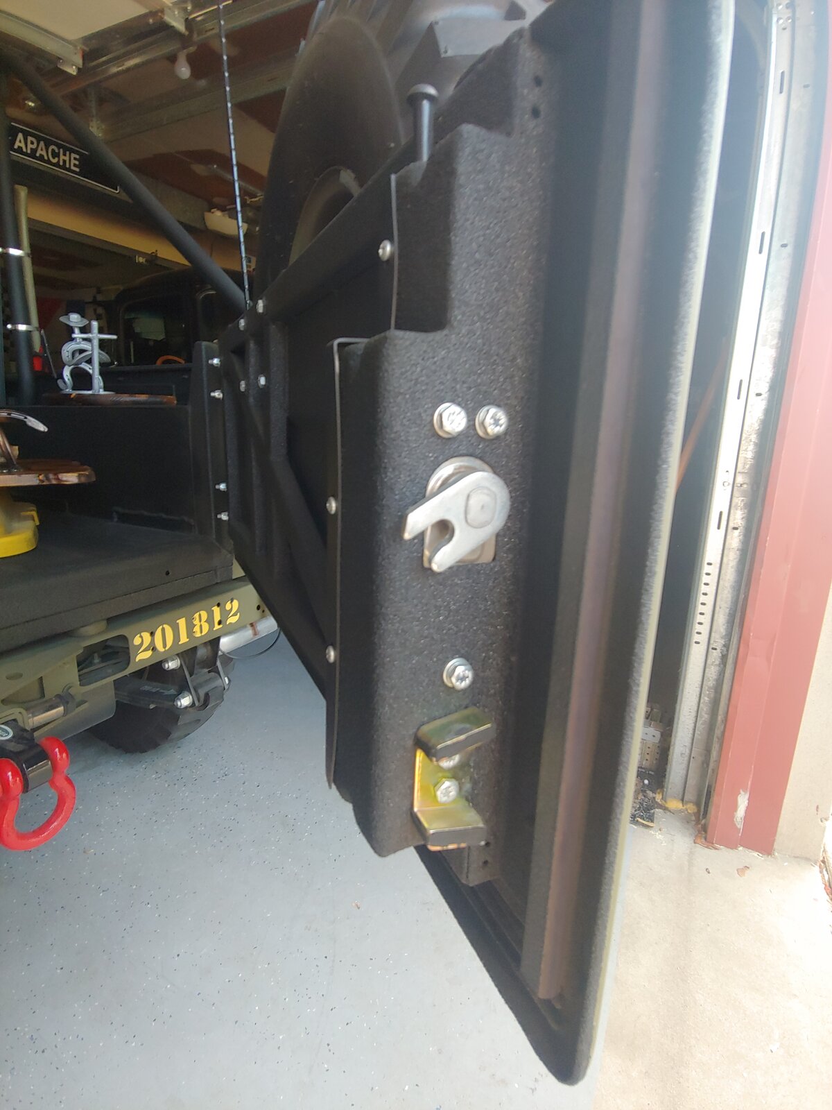

I did slam the *hit out of mine. Just make sure the latch is not in the lock position. Mine works great, ill take a pic and post it so you can compare.

The striker is too far in on the left fender, the latch is not reaching it, loosen the studs in the wheel well of the left fender and move it out slightly so the latch can reach it.

I don't think it's shims. Just slide it closer to the back of the Roxor so the second click can grab it and it's probably just a slight movement. Too far and you'll rattle even on the second latch.
What I meant by 'too far in', I meant towards the front of the Roxor.

I noticed mine didn't shut tight also. When I put the spare on it closed right. The weather stip just needs squeezing and the weight of the spare gives the gate more weight to make a firm close
