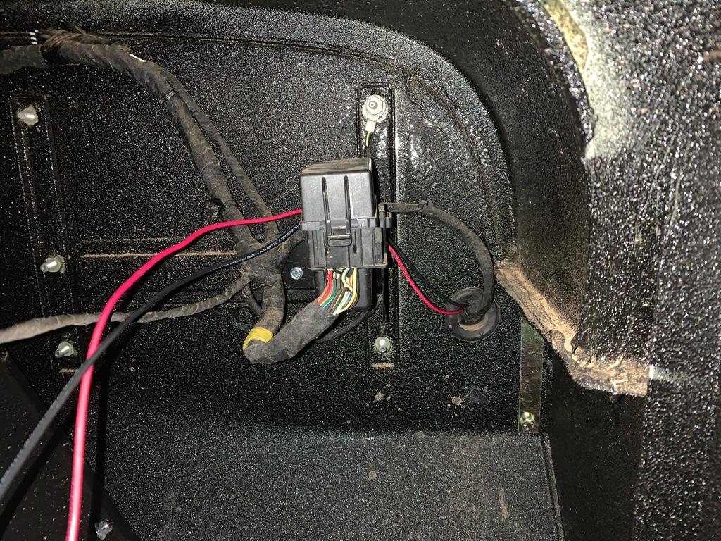

The only switched source that is available is under the dash, passenger side. It's the 6 pin connector. There are 2 switched power pins, and 1 constant hot.

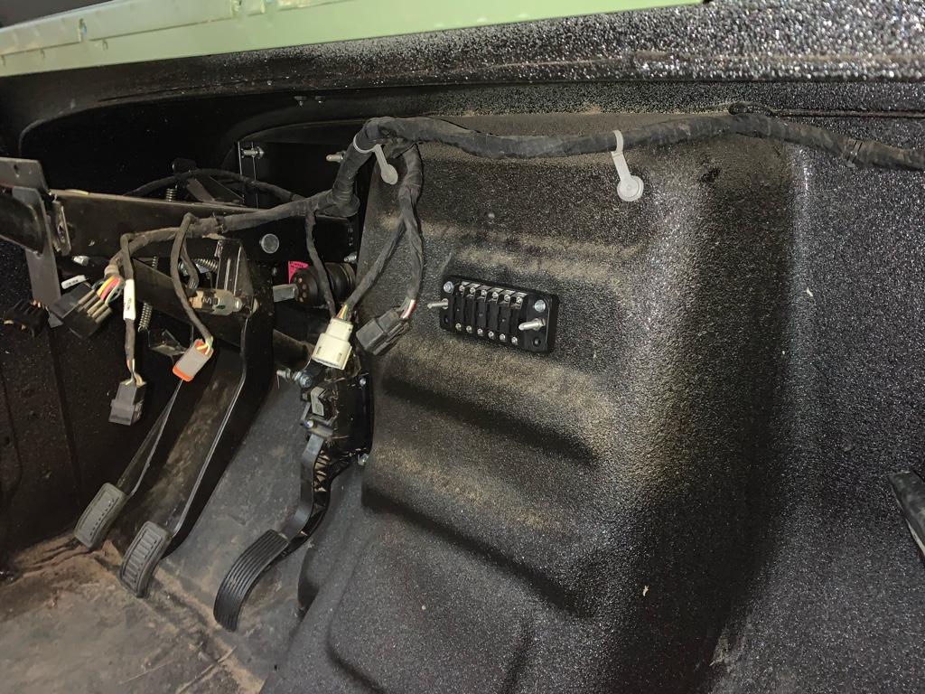

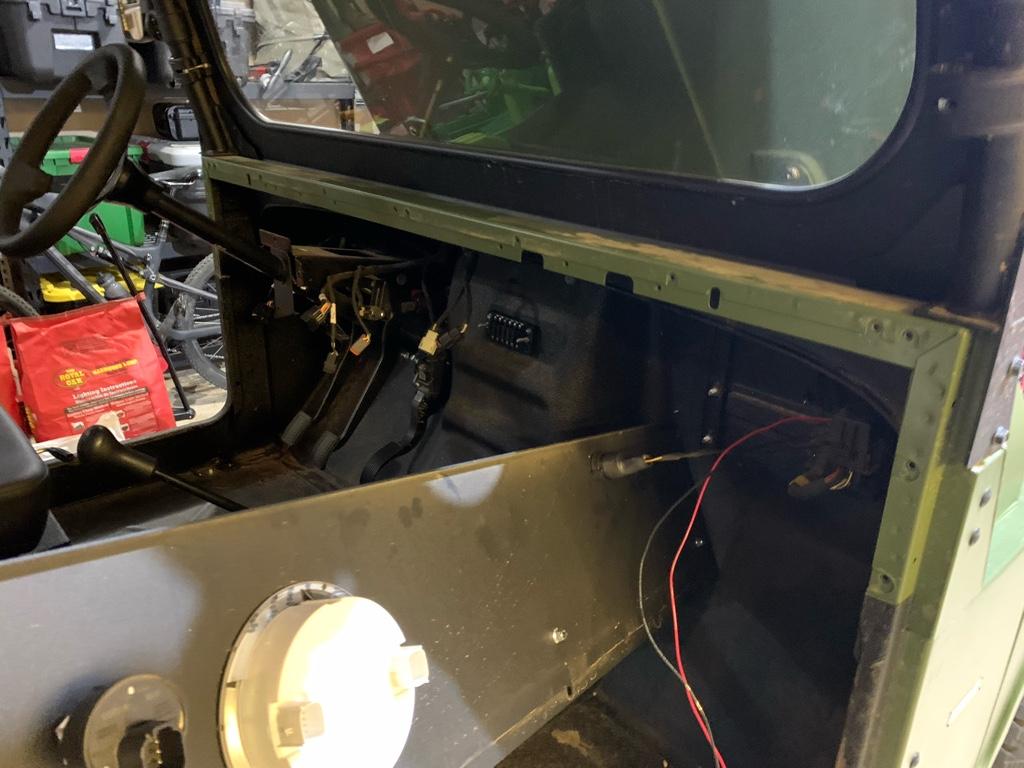

I wired in an extra relay, triggered by tying into the power point wire, to power an extra fuse box. Then I use that fuse box for small stuff or to trigger another relay if needed.
I wired the relay off the cigarette lighter which is switched by the key. the switched side of the relay connects to the battery and then to my new fuse block.
Yep, That sounds exactly like what a bunch of us have done. It sure makes adding in extras a lot easier. I added in some driving/snow plow lights, a double USB port, interior light and sex lights (if you're old enough to know what they are) off the new block; not so dark in there at night now.
Do you remember which wire is hot? Black or brown/yellow? I would think brown due to the fuse being 5 amp brown.
