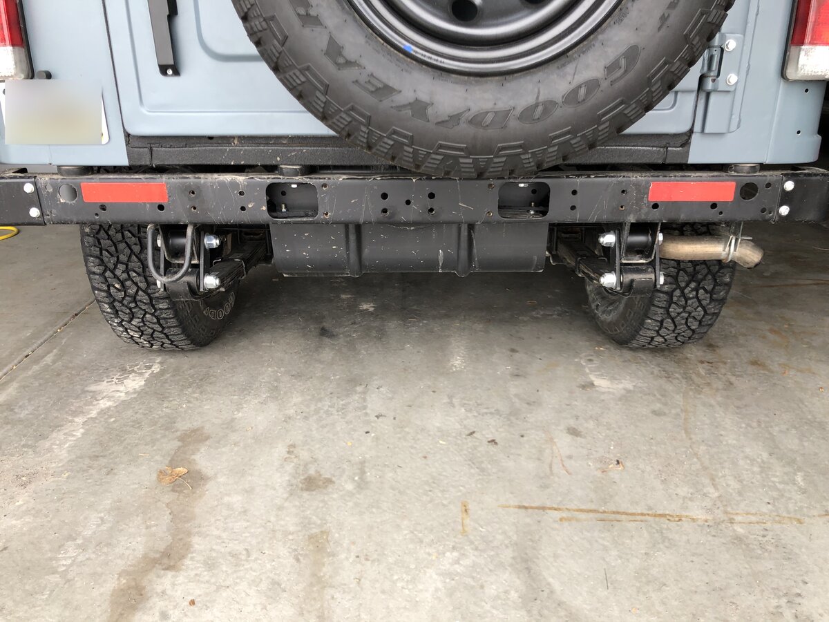

In addition to signals and mirrors, you technically also need a lamp to illuminate the license plate (that came with the signal kit I used) and red reflectors on the rear (I put some adhesive strips I got from Lowes on the bumper). When I got my inspection, the guy specifically looked for the red reflectors. If you don't have a windshield, you are required to wear eye protection. You can get the title and safety inspection at any place that does normal automotive safety/emissions inspections. There is no emissions inspection required (street-legal ATV's follow the emissions requirements of motorcycles, which don't require inspections).

Can you share what kind of reflectors?
There are plenty of ways to go about it, but I used a couple strips like these: https://www.lowes.com/pd/Hillman-6-in-Reflective-Red-Tape/1000939958.

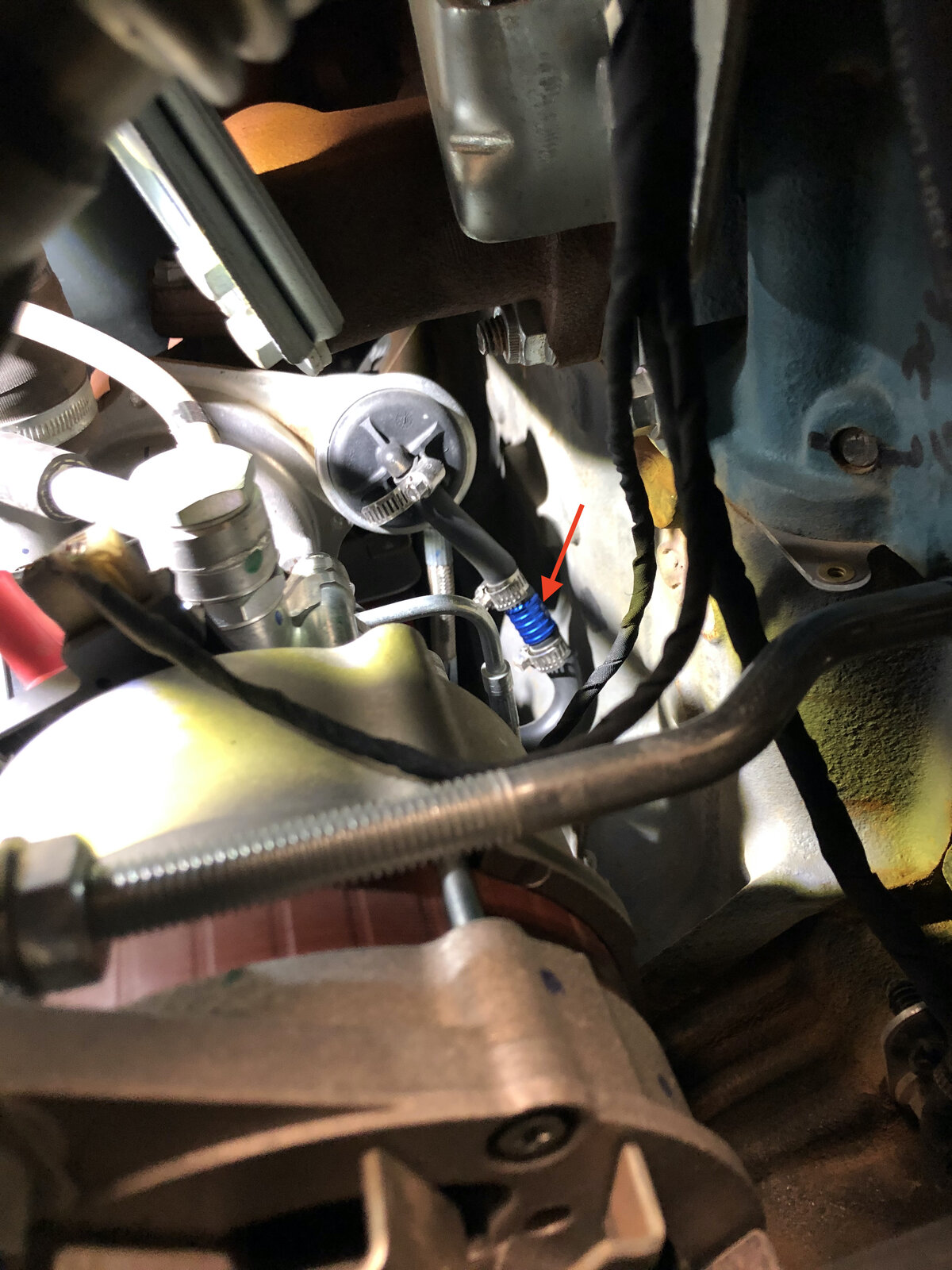

Some recommend a new intake connection kit, even without a tune (All roxors leak boost! - Team ROXOR Forum - Unofficial Mahindra ROXOR Off-road Community!). I haven't done this, though, since I don't have any signs of leaking (like the picture in the link).
