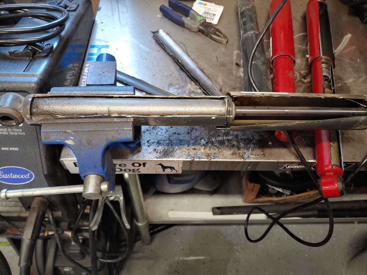

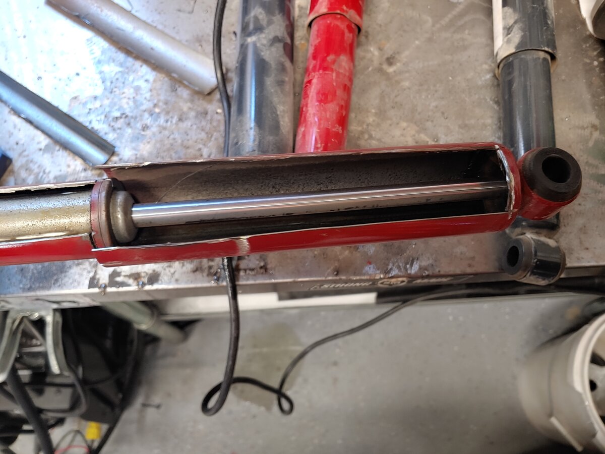

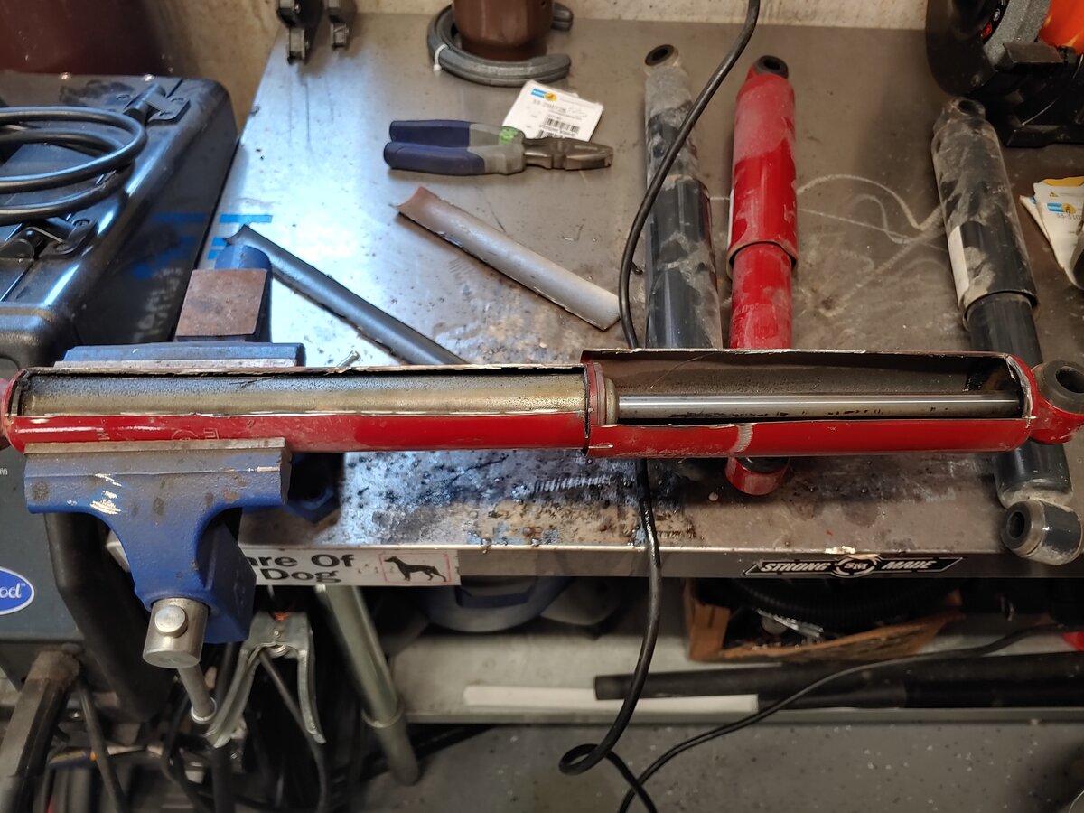

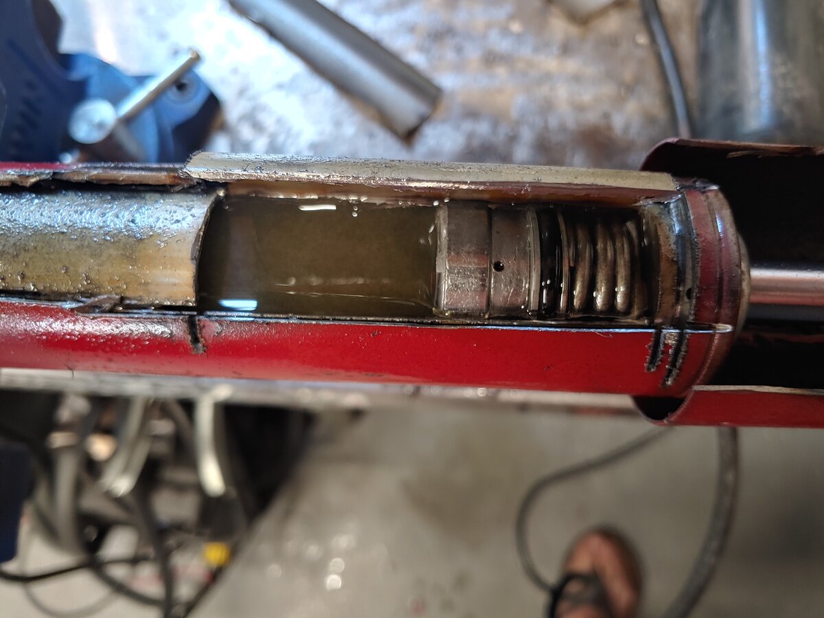

Those of you who have replaced the stock shocks. Have you cut one open to see if these things are hollow? I'm almost convinced the red body shocks are just for looks.

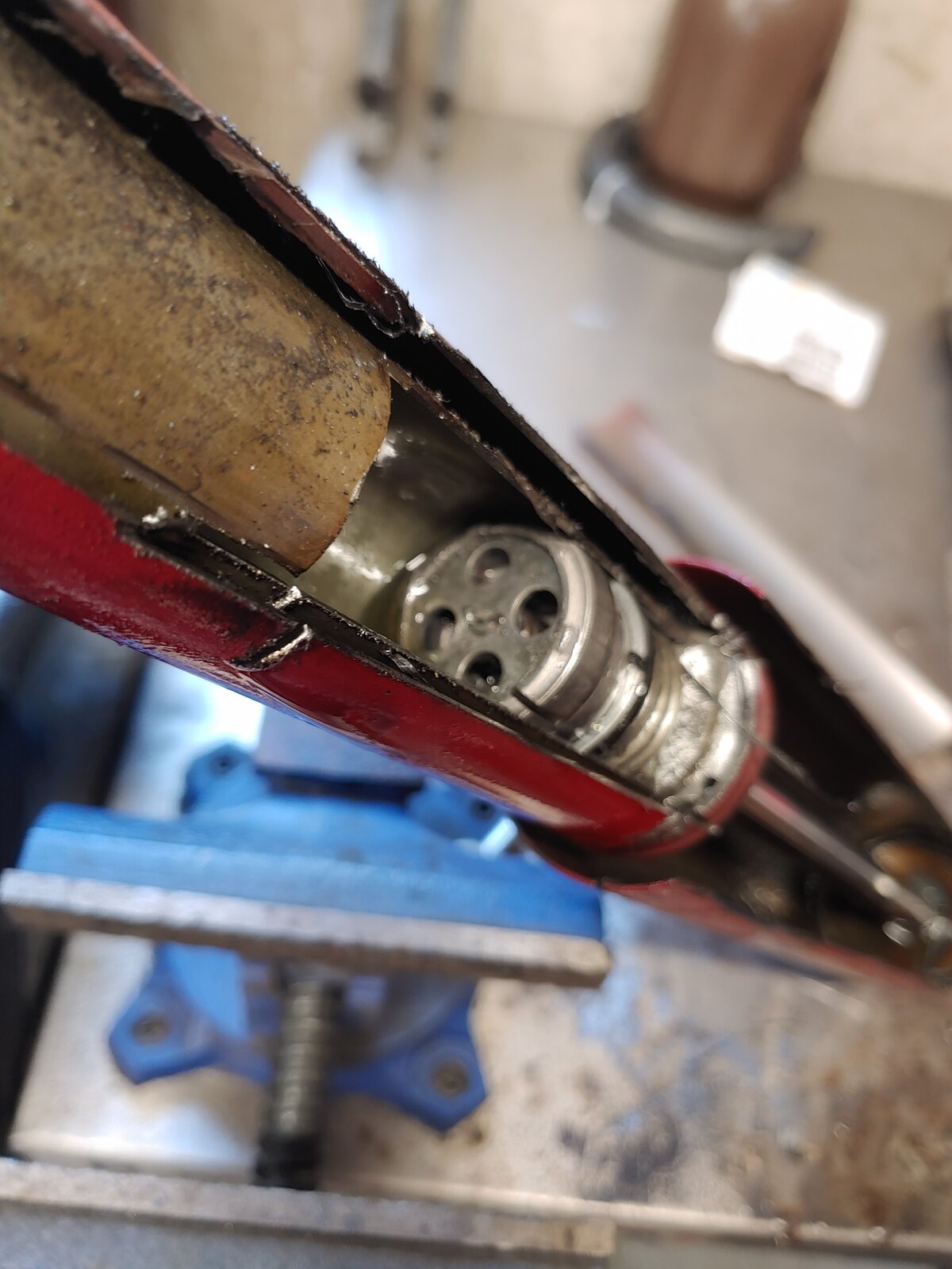

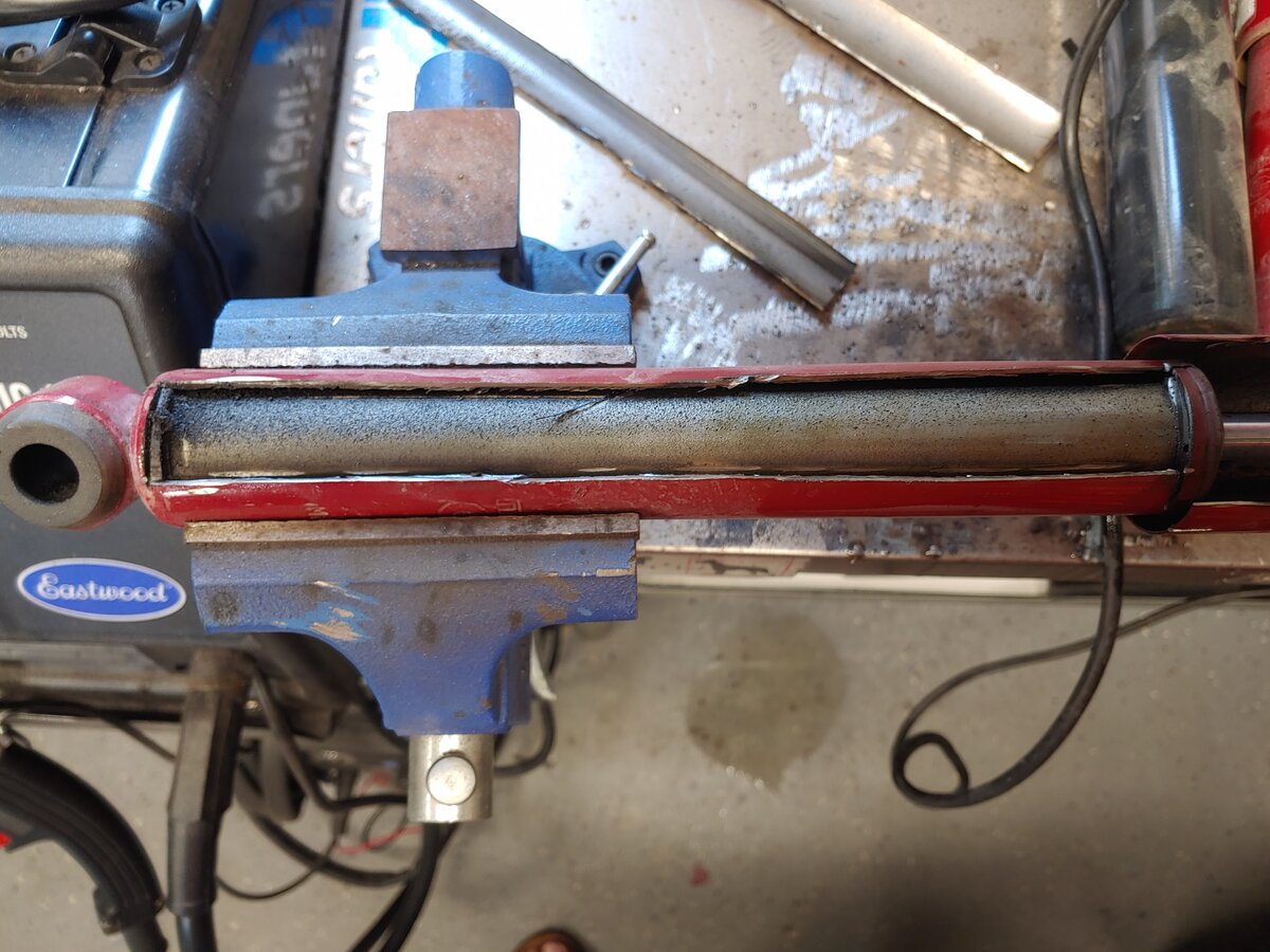

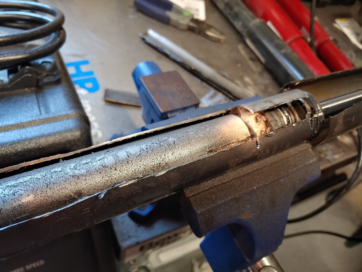

Apparently, it's a good shock, in theroy(still full of fluid. Gonna check the other one.
708
Very light valving I guess. Like a steering damper rather than a performing shock absorber

These are the shocks of yesterday. They are fluid filled and only react when pulled or pushed. Strictly to dampen shocks. Not like the charged shocks of today that are designed to help keep tire contact with ground as well as dampen. Oil filled shocks were standard until the 70s.
Woodsman74881
Sep 25, 2018
309
Wellston, OK, USA
000992
One good thing about the old style, they would last for years. As long as there wasn’t a leak and the valve (orifice hole) stayed clear it would work. Probably why they use them in India. Cheap, reliable, and acceptable performance. Gas charged shocks develope o ring leaks because of the pressure on them. Then they go flat. But have far better performance and much quicker response.
