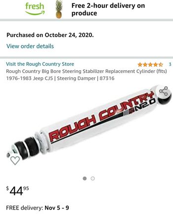

I know I saw someone on another forum installed a Rough Country part # 87316 and said it was a direct bolt in replacement and he was happy with it. Said it made a large difference to him. I have no experience with it but passing along what feedback I have seen.

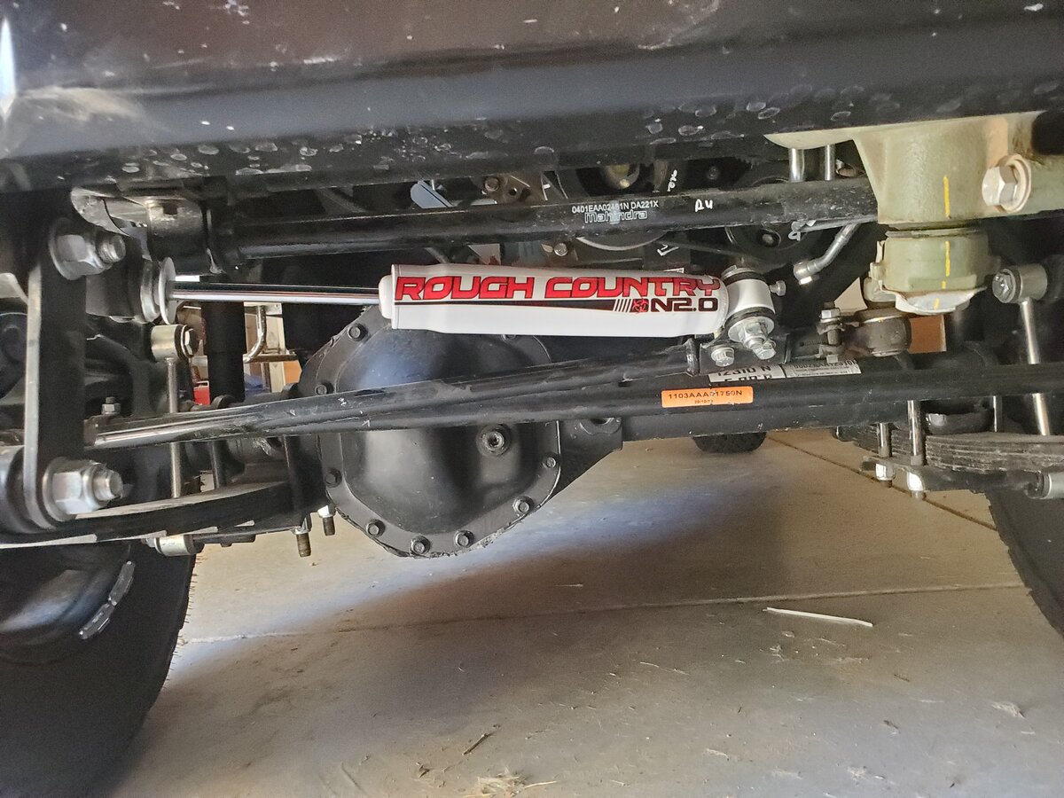

How did you guys make the Rough Country #87316 work? Did you make a full left, full right turn of the wheel to see if the stabilizer has enough stroke?
My experience: I got the stabilizer today. Removed the stock unit and got ready to install the Rough Country.
Before I installed the Rough Country stabilizer, I did a side by side with the stock unit. The Rough Country is about 2 inches shorter (fully extended) than the stock unit.
I went ahead and installed it anyway since it seemed to have worked for several guys on this forum.
After install, I did a full left, full right turn. The Rough Country stabilizer hits bottom (left turn) before the steer stops (unadjusted!) touch.
Any one using another steering damper than Rough Country 87316?

The rough country fits perfect and is an upgrade over Mahindras design.

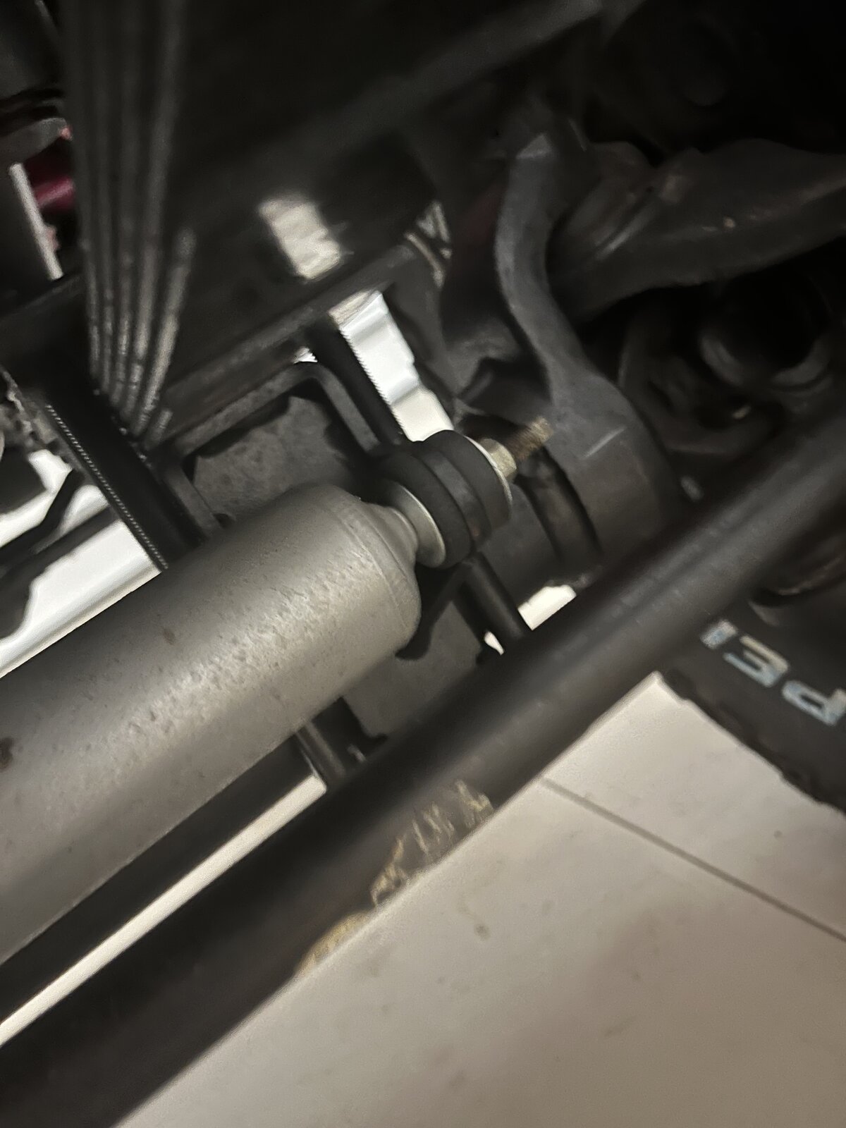

Hi, this looks different than what is on my 2022 Roxor (the end part). I’m not super mechanical so I could be pointing out something that I should understand. Do you think this will fit my 2022? I have a rough country 5” lift on it.
2,098
Looks right! What does the other side look like? That side looks food
