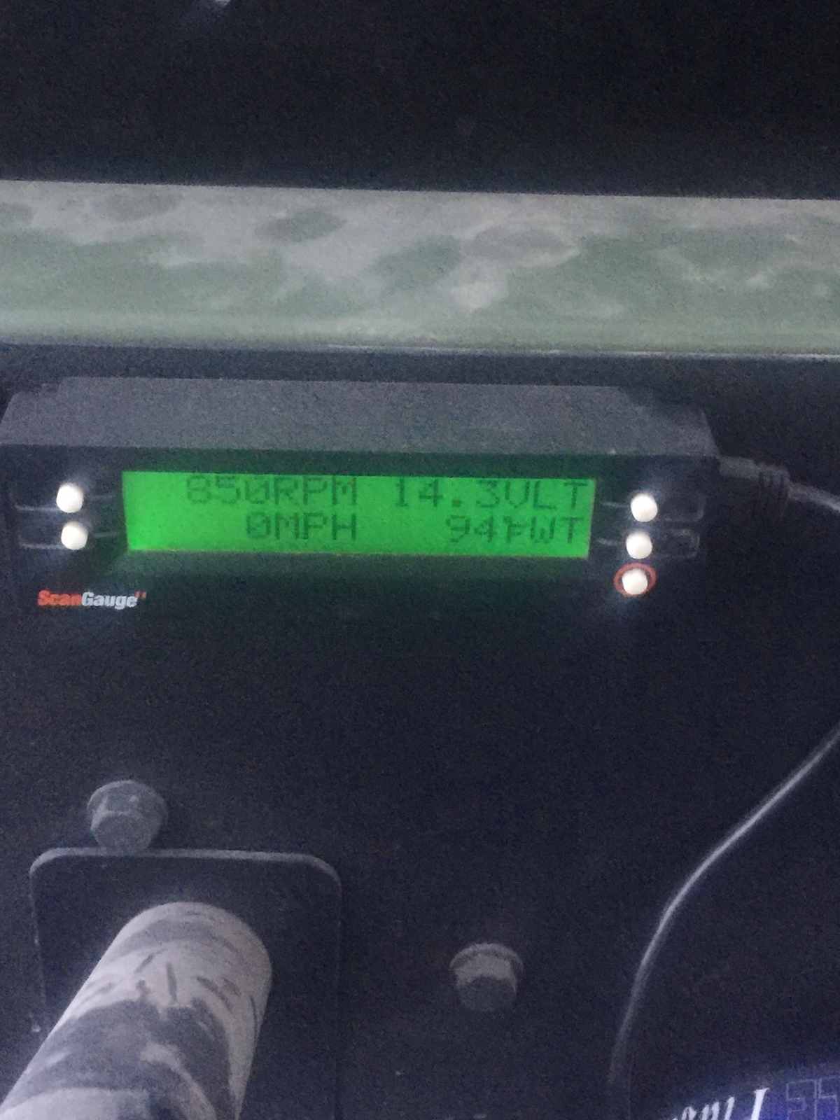

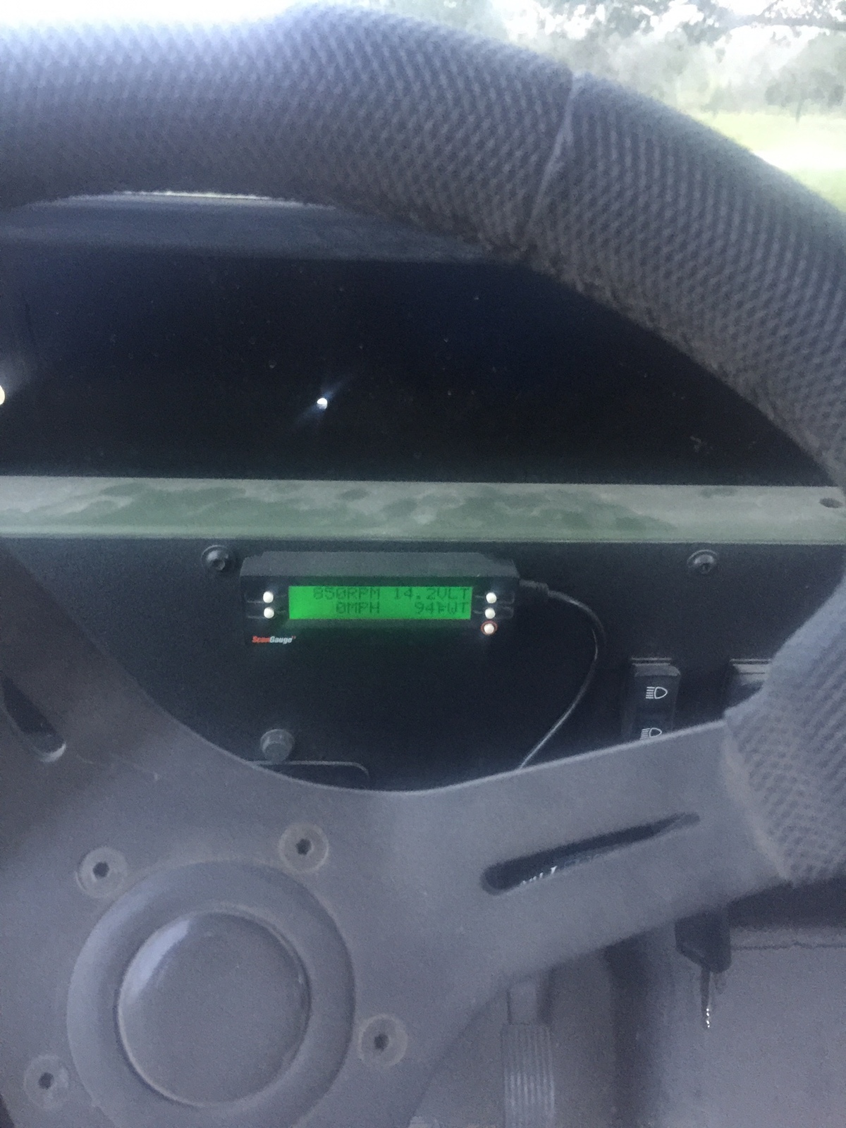

I’ve had a scanguage2 in my old Jeep and kept it when I sold it. Great tool to have to read and clear codes as well as read data. I decided to hook it up to the Roxor. I used the adapter cable from dirt legal and velcroed the scanguage to the dash. Right now I can read rpm, mph, voltage, water temp and intake air temp. I figured once I put bigger tires I’ll use the mph feature on it where you can calibrate to actual mph. Need to also see if there are any other things I can program it to read.

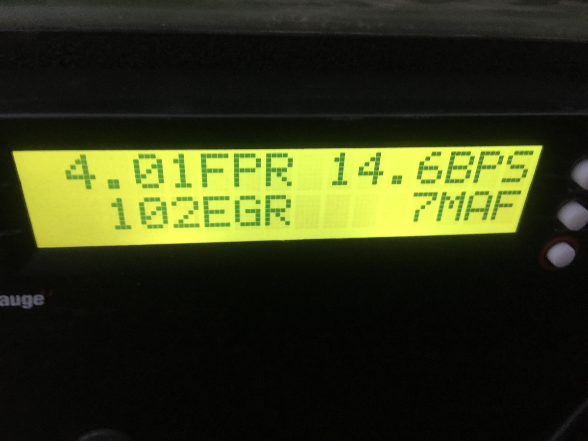

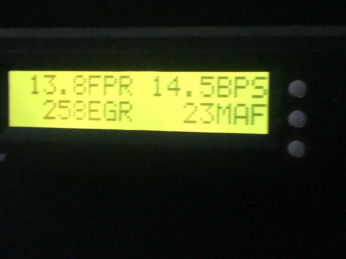

I sent my scanguage back to them and they updated it with the latest firmware. They also sent out a datalogger to see what kind of X gauges they could do with the Roxor. They sent me back what appears to be a completely new scanguage which I was not expecting. I was expecting it to be loaded with the new X gauges which it was. So far it seems great.
Roxor at idle
Roxor going down the road in 3rd or 4th gear at 40-45

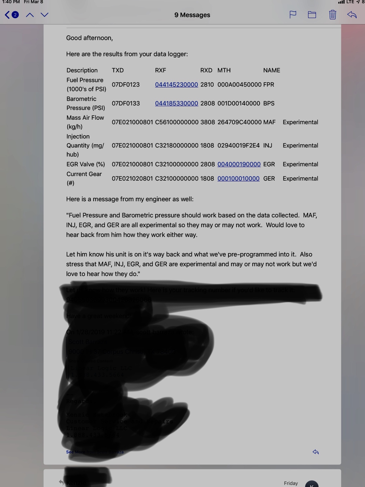

The email I received from them with the X gauges on it. Anyone with an scanguage might want to input these X gauge codes in it.
