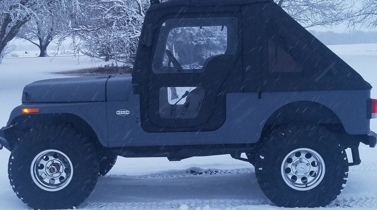

Ready for snow !

3 in lift, 12.5 35 tires on 15in mods , RxR bumpers and side steps, Stealth turbo, Full flow exhaust, 5.13 gears with lockers, 115hp tune, Ceramic clutch, Cold air intake

empty wallet (as a product of the 70's, I had to go with the polished wheels)

I bought the spartan locker/gear kit from dirt legal, I have had no problems
chadwyatt
Feb 13, 2019
Muscle Shoals, AL, USA
Very nice setup. I'm looking into lifts and 35s myself. I've seen a few pics of lifts with 35s and the rear doesn't seem to have a lot of clearance with the 2 inch rear and 35s. Is this okay on yours or can it touch wheelwell?
Also, did you use 2.5 spacers?
Thanks
