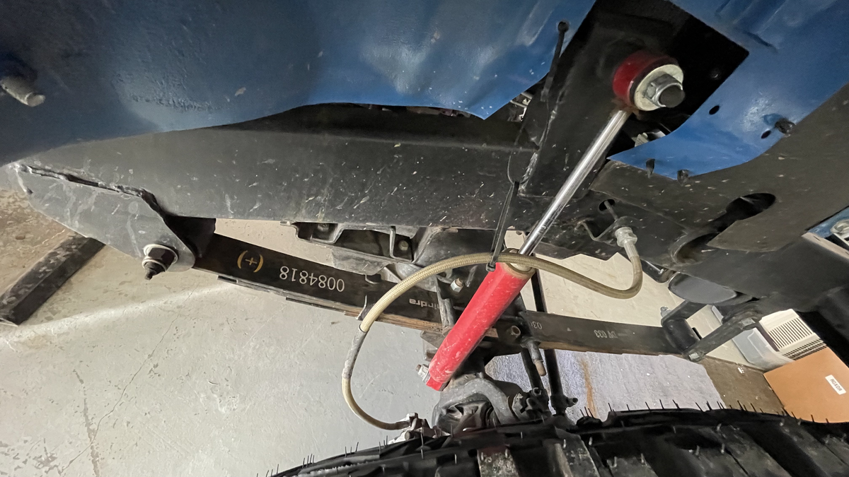

I am really confused on my lift, it is the spring over axels and I think they are the factory shocks still even with the silver showing on the front ones. I need to measure them so I can order new ones, the ride is terrible on the road but not to bad on trails but I have not been able to really test it. thanks for all your help. also my from and back are always locked so I need to figure out how to unlock the front so I have the choice when I want it locked and unlicked.

Your lift looks to be a custom spring over. The ones on the market all are bolt on brackets that relocate the springs to the top. It appears someone welded new perches. Probably had a 4x4 shop do it. I seriously doubt you have stock shocks as they wouldn’t be long enough to mount near the original location in the front as the pics appear to show. You can always pop one end off and see how long they extend to verify. For the lockers I’m wondering if they put a lunch box in. They stay locked all the time but unlock and “ratchet” around corners. Best way to see what you have would be to pull the diff covers and see if theres a lunch box inside or if they welded the spiders up.
