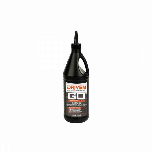

Just get what's available in a gl4 in the weight range the manual recommends.
I used a gl4 by company "Driven" in transmission and transfer case in my two machines. Summit Racing and others carry that brand.
In my 1950s Willys, I use the gl4 by Sta Lube brand.
The nice thing about Amasoil is the oil comes in a pouche and you don't need ro use a pump.
One more thing: get an 8mm square drain plug wrench for $6.99. Its either the transfer case or tranny that has that size plug.
I'm attaching some info I found on 5 options, a couple are thanks to you. Thanks again. utrzjiozfygxl5byxioo.jpg Driven GL-4 gear oil.jpg
