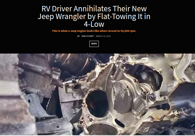

example of flat towing with transfer case in 4-stupid
RV Driver Annihilates Their New Jeep Wrangler by Flat-Towing It in 4-Low
