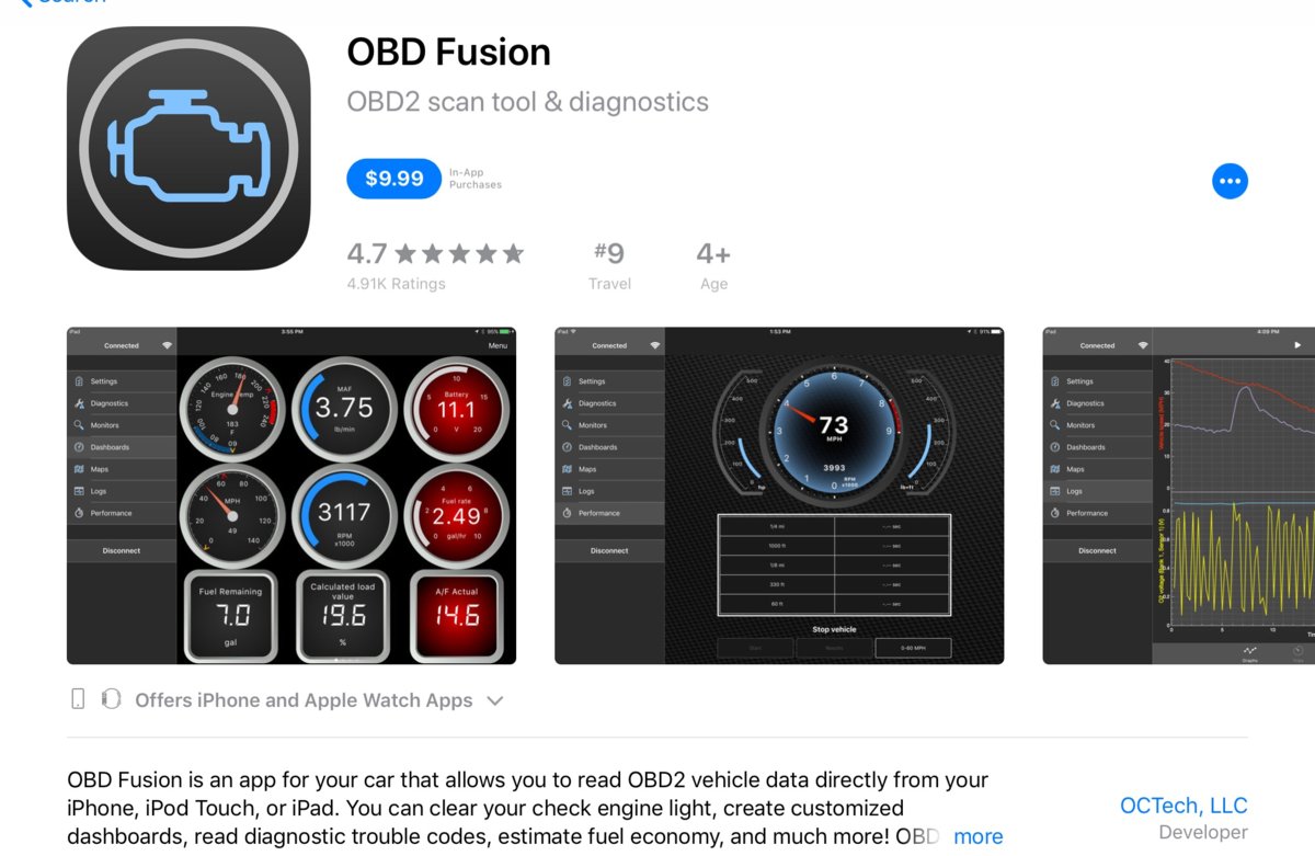

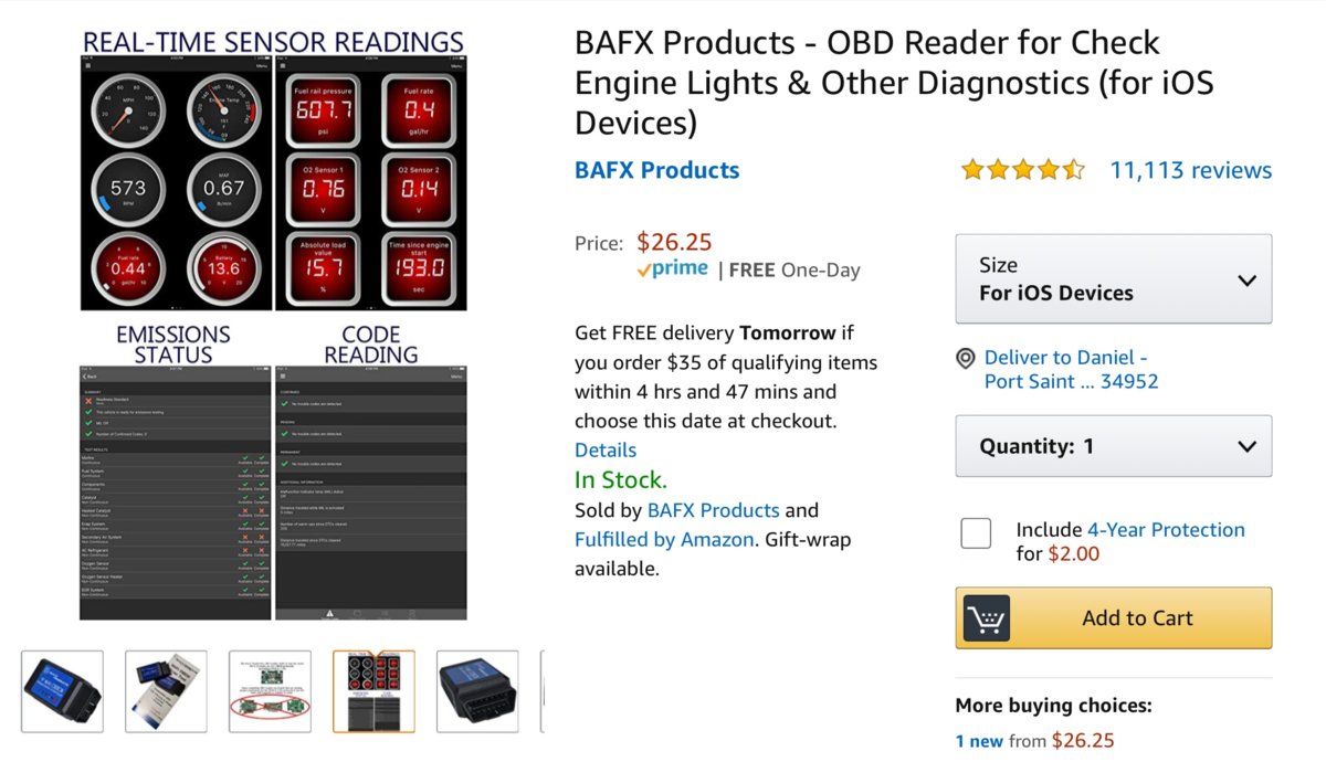

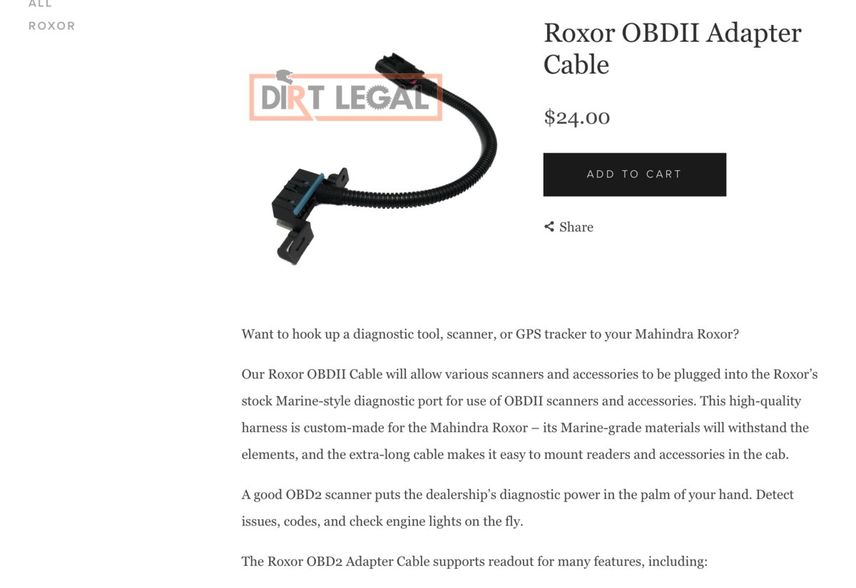

New toys, gadgets, and apps open up with this adapter. With an old Iphone, Ipad, tablet, you got yourself a large digital display for less than $100 bucks theoretically. The display has many gauges, fuel, temp, rpms, mph. Im going to try to give this set up a go, and post update. These pics are of the ODB Roxor adapter, ODB Bluetooth/wireless device, and ODB fusion app.

Roxor has a marine ODBII connector, and yes to convert to auto the two wires need to be switched, RxR performance sells them as well for twice the money.

I had to move pin 5 to pin 4 on the dirt legal odbll to make it work.On the odb side.
I heard about this but assumed Dirt Legal would have done this when they made the cable. I haven't had a chance to install my cable yet but will keep this in mind if it doesn't work.

I have a 2019 roxor will my wires have to be swapped? Which wires is it? Colors? Any pictures?
