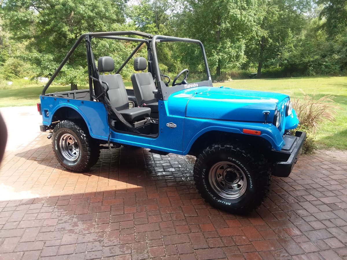

No question about the Roxor's ability... well... after lockers and tires were added...
BigDaddy
Aug 11, 2018
29
Oxford Charter Township, MI, USA
1292
When I first got the roxor I was really unimpressed with the open differentials and small tires. I bought it for off road. The open differential just baffles me honestly.
So, I installed 32-11.5-15 bfg Mud terrains and spartan lockers front and back.
The last two days I have really have put the roxor through its paces off road, hill climbing, over obstacles like downed trees, boulders, through muddy streams...
It performs beyond my expectations and the turbo diesel really pulls in the right gear up hills.
