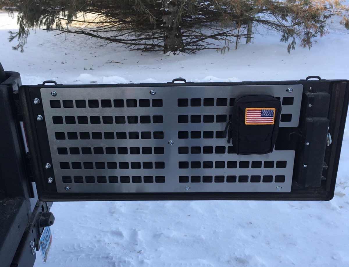

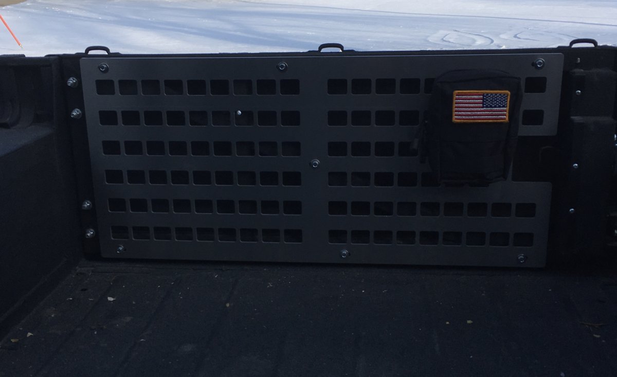

Made molle panel for my tailgate .125 aluminum. Used spacers to set it off the tailgate so molle gear is easy to attach.

Tell us more- what material did you use- looks like stainless? Also, how did you fabricate it? It looks top notch!
Doug
MNROXOR
Jul 19, 2019
86
Wabasso, MN, USA
2724
The panel is .125 aluminum, I drew it up in AutoCAD and then laser cut it out. It is set off the tailgate by 10.0mm spacer. I will still be able to mount spare tire bracket. I updated my drawing so the spare tire bracket will be able to be install or remove with the tailgate molle panel being installed. If anyone is interested in one let me know. I have a few other molle panels drawn that mount to the bulkhead panels I make.

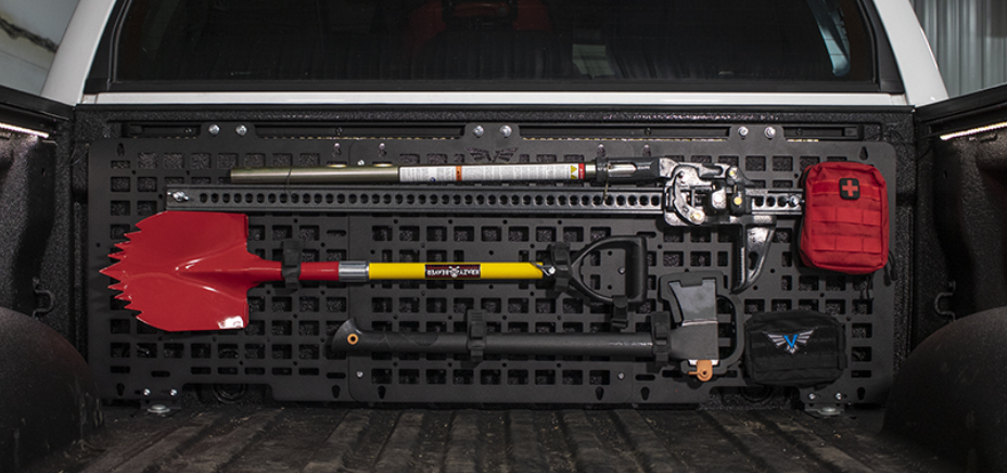

Molle question: I am a member of another forum and they are doing something there that I think would work well here on the Roxor. Why not do a bulkhead Molle wall that mounts to the floor and side walls to hold the HiLift jack and shovel as well as other misc. items.
picture attached for an example

I actually have several molle panels designed for the bulkhead. I just haven’t received much interest. I could easily design one that would mount to floor and sides. Would you be interested in it?
I might be, I put this same post in one of the Roxor groups on FB and it is already picking up some steam there.
What price range do you think a bulk head would bring?

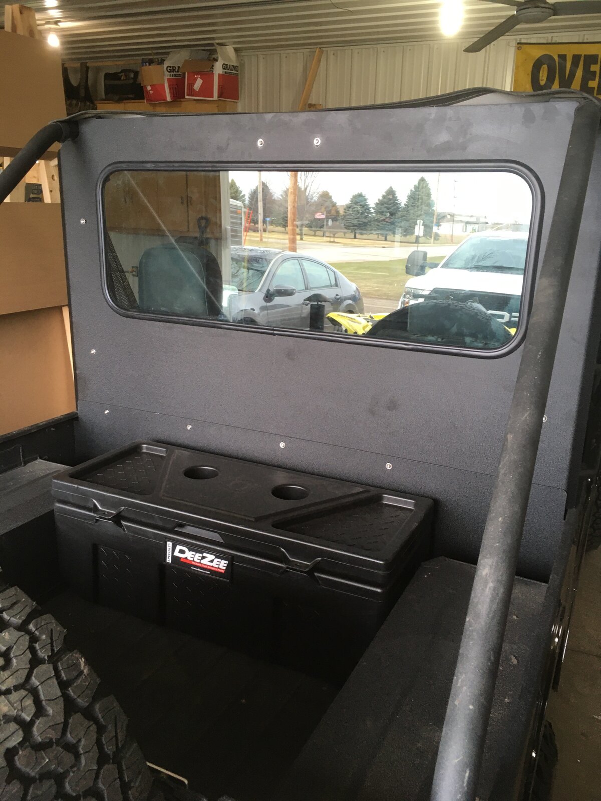

Bulkhead molle panel cost I will look tomorrow. I had figured cost on a large and some bulkhead molle panel. That i could mount to the back of the bulkhead I make. Never made do that I put this storage box in.

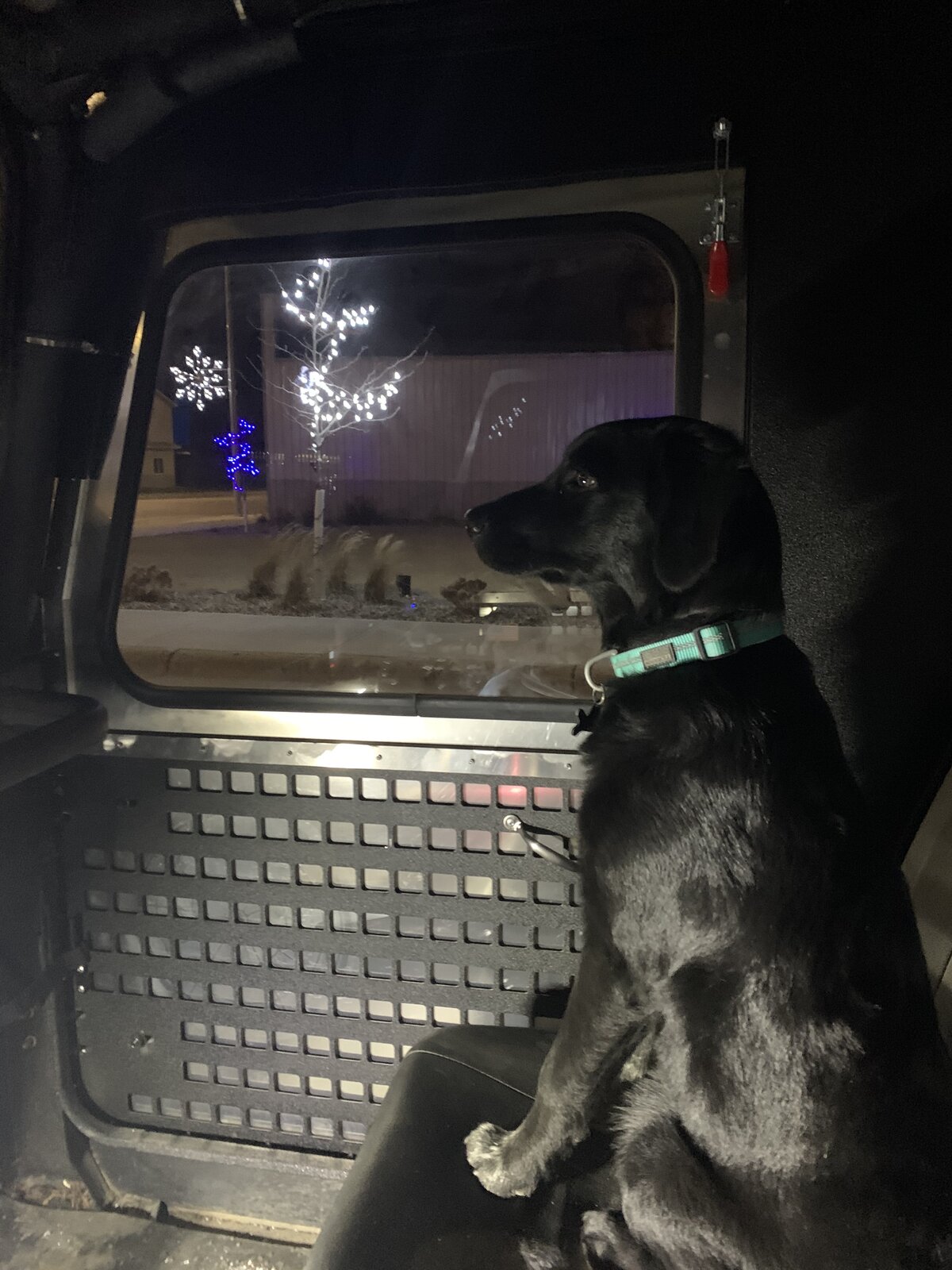

Down the road I will add a box, but currently I have a 120lb lab that loves to ride in the back. LOL
This would help keep him back there when not off-roading, maybe even a quick release option.

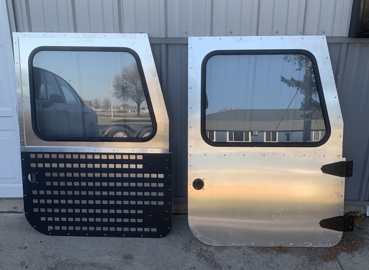

Door is 1/8” aluminum door molle panel is 18ga steel. Material for laser shop
