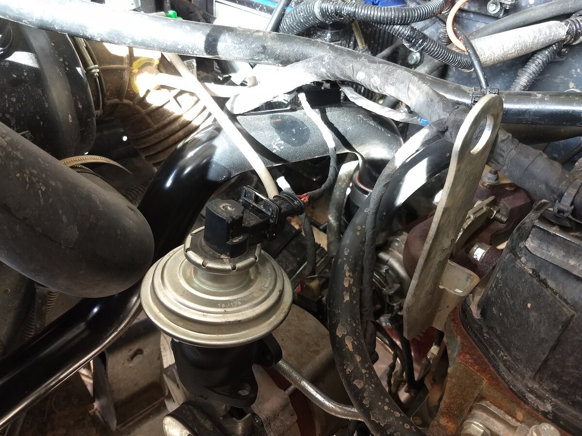

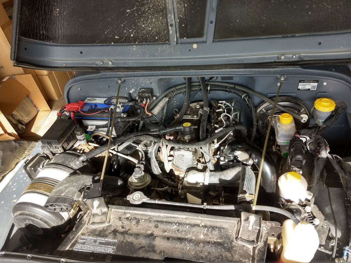

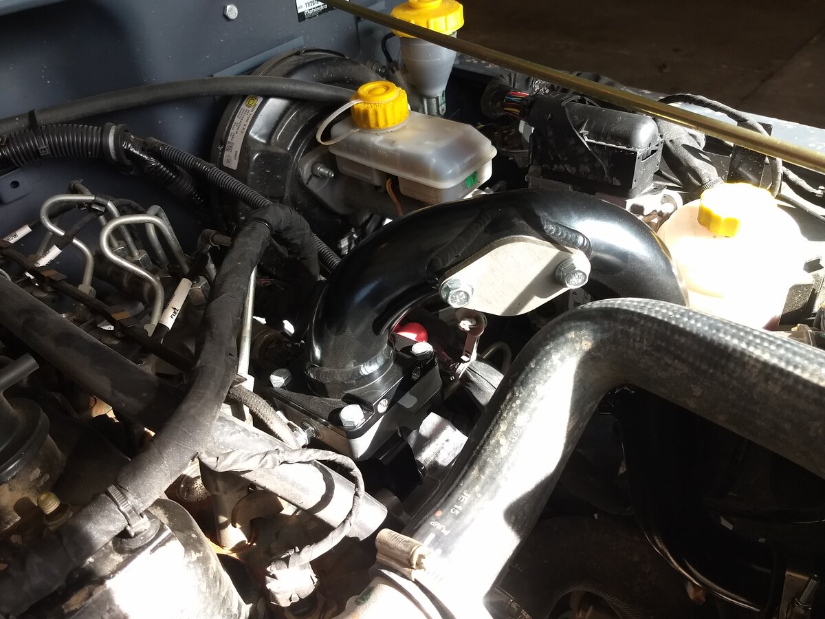

Here's how it looks as of this evening, it's dirty and I need to wash it. I'm happy with how the cooler piping turned out. CPS doesn't disable EGR in their tunes, so I bolted the EGR valve to the angle bracket on top of the alternator. It's the perfect spot for the vacuum and electric connectors to reach. The valve actuates and the ECU is happy, and my intake stays soot free.
