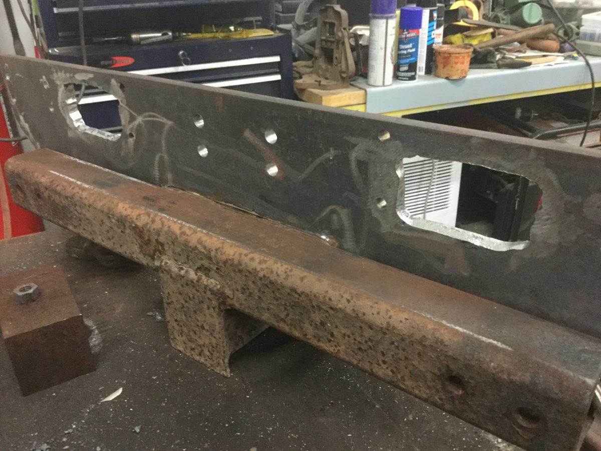

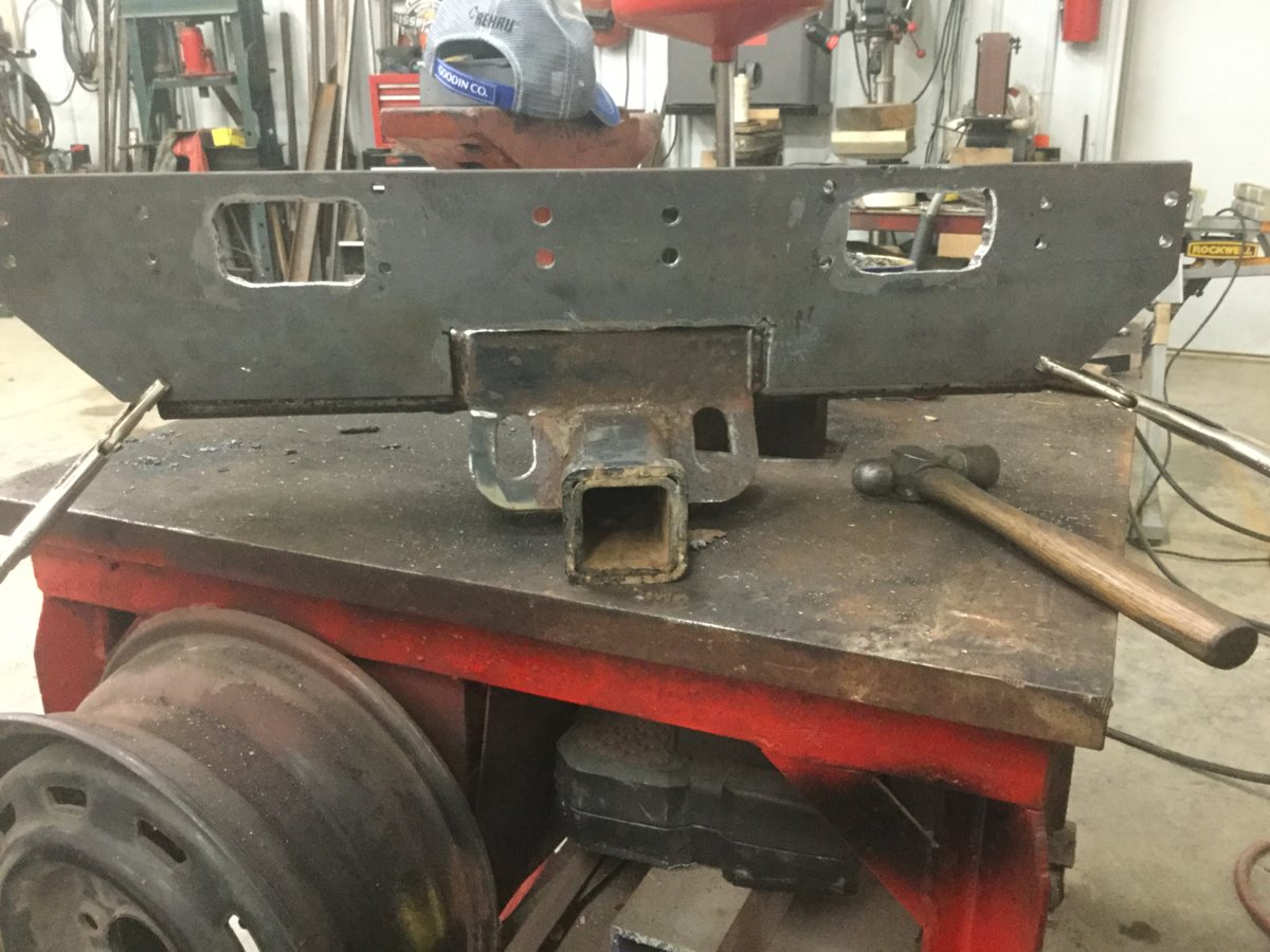

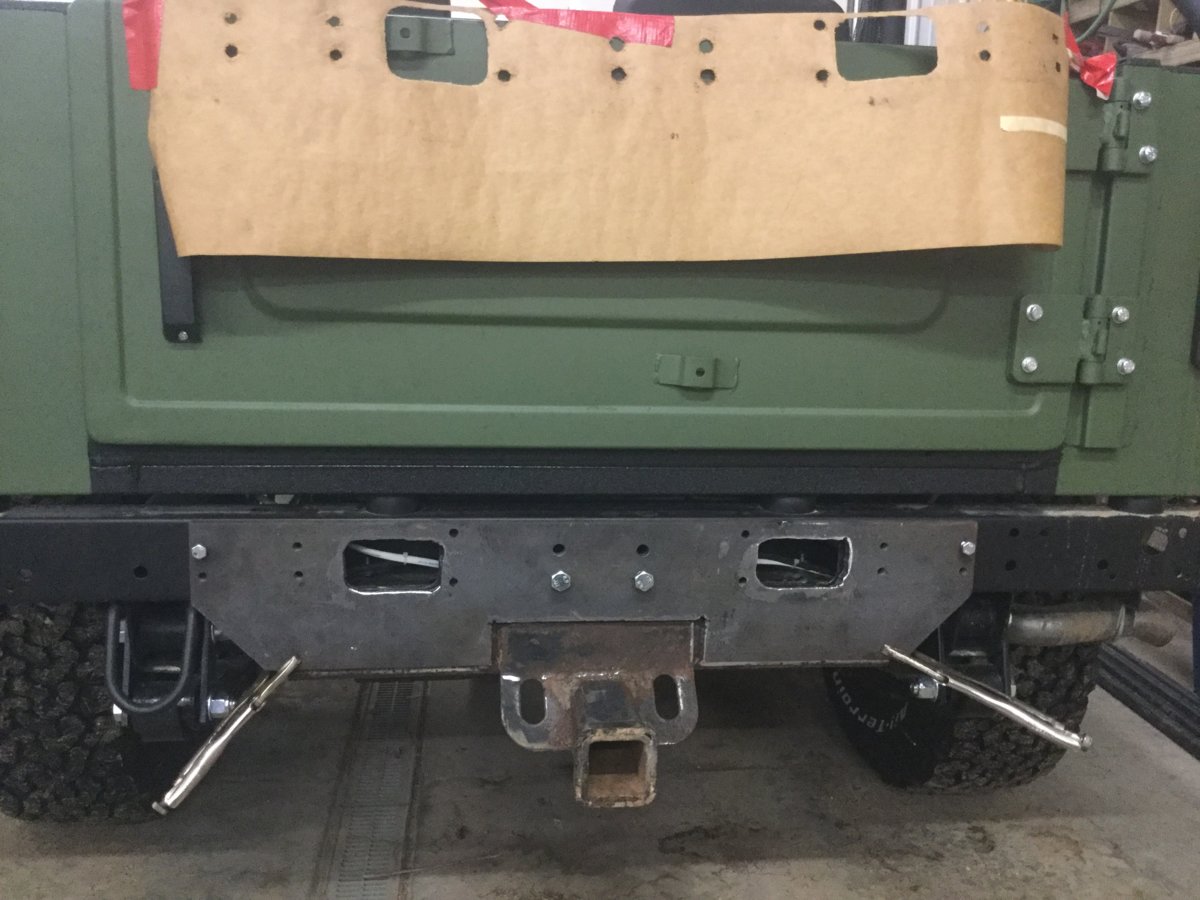

Lots of time in there. Glad Santa brought me the Mahidra hitch. I do not have your patience! How far off the ground is it?
Campyman
467
Bellevue, WA
Well it looks like you just have it being held to the base plate with the 2 bolts that are about an inch above the hitch. It'll need more reinforcement If you want it to hold better and not flex. I can't brag because I just got a hitch off Amazon for 23 bucks that had a flange which I just bolted to the frame. It's fine for light duty but I wouldn't dream of attaching anything very heavy to it. Yours could end up being just as good as the factory hitch with some more effort.

Hang some 6010 on it for a root pass then cap it with 7018, she won't got anywhere if you use grade 8 bolts.....
