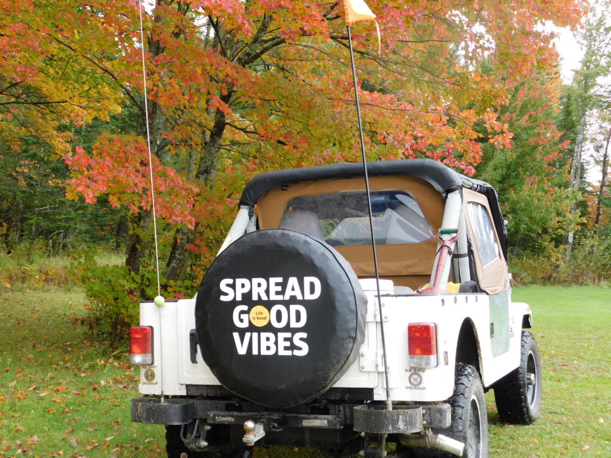

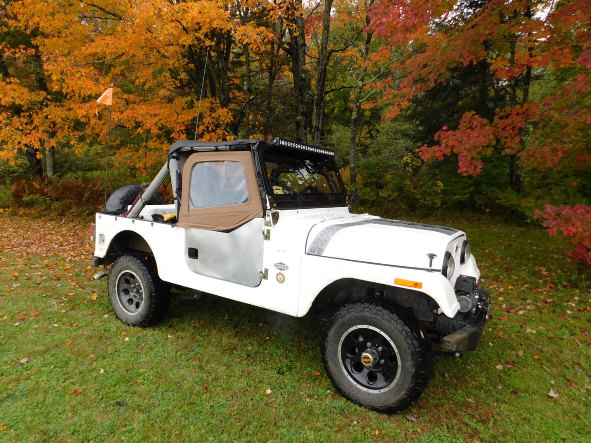

No simple solution. Anything Jeep was repurposed to fit and tweaked just right. Wrangler windshield, roll bar, seats, doors with a windscreen. Added an aftermarket Jeggs heater, not air tight but plenty warm and the only zippers are for window operation. Doors open and closes like a vehicle.

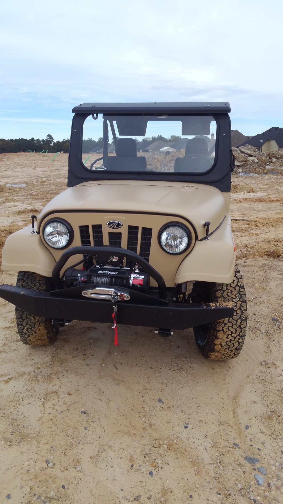

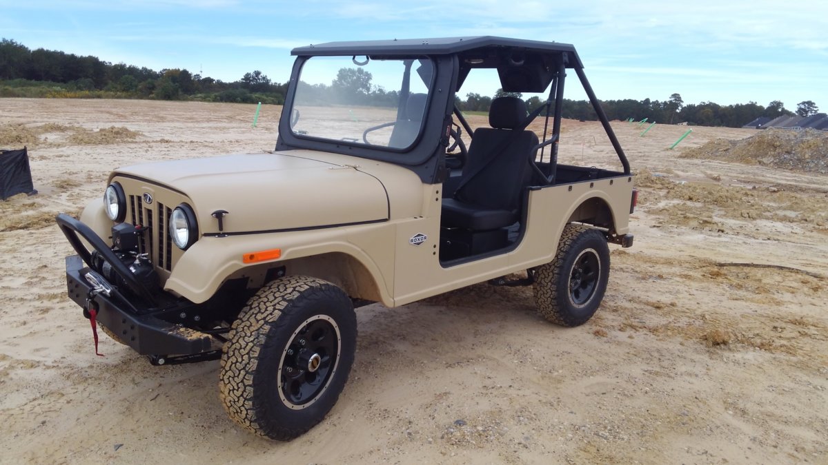

I bought a Fortress Steel Top and windshield for my Roxor. Very well built. I paid around $1000. Windshield Tilts and has hole in frame for wiper.

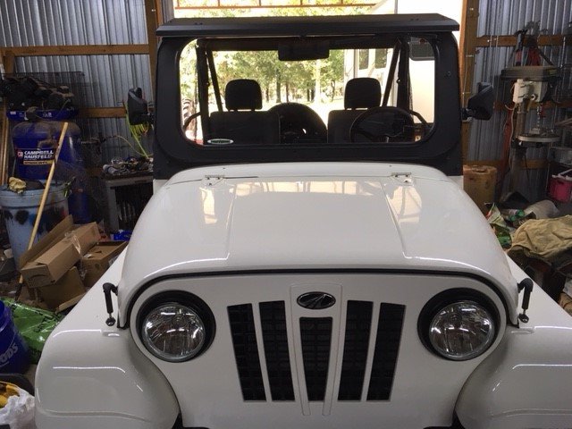

Here's a pic of the Fortress top and Windshield! It was very easy to install and excellent quality.

Here's a pic of the Fortress top and Windshield! It was very easy to install and excellent quality. View attachment 1610

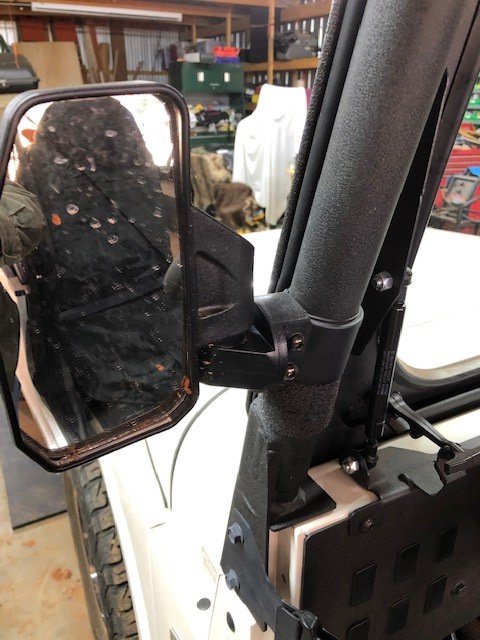

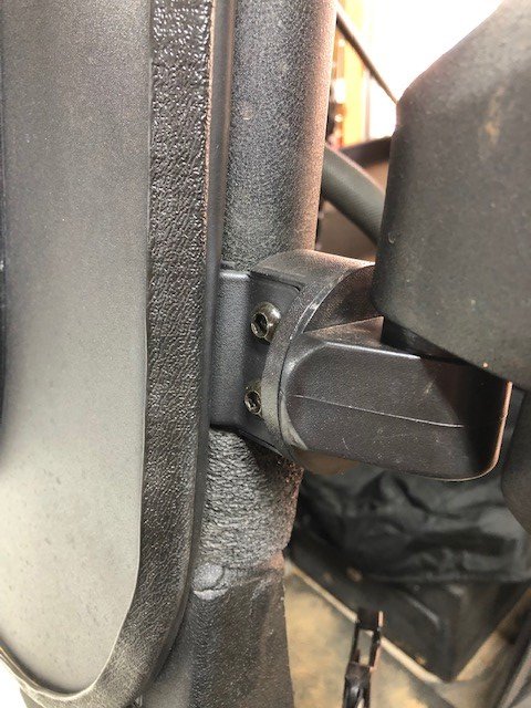

Nice! Can you tell me whether the Fortress windshield precludes the use of side view mirrors like Siezmik makes where the clamp wraps around the roll cage tubing. Also do you feel the roof would preclude using the grab handles that also wrap around the role cage.

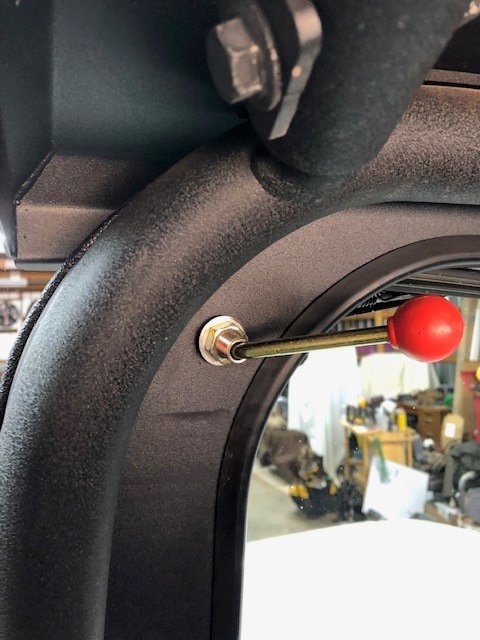

I have clamp on mirrors. It fits fine. Fortress has an ample seal that mooshes around the clamp for the side mirrors. I will get a picture for you when I get a chance. I'll post it sometime tomorrow.
Awesome! I’m getting ready to move on mirrors, this helps a ton.

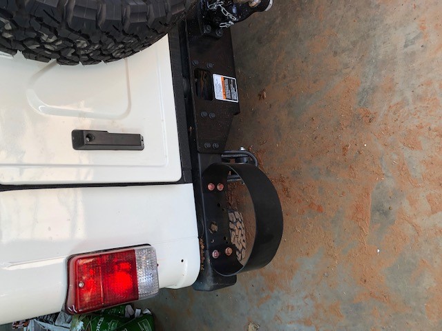

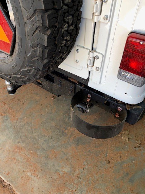

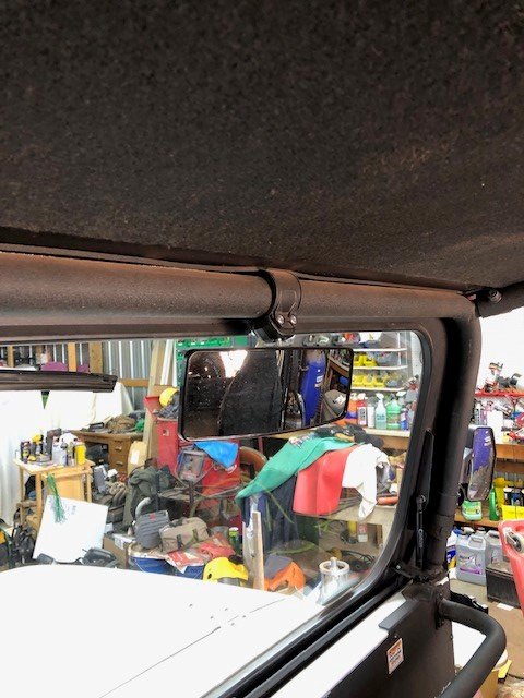

Here are the pictures I promised on the mirrors with the fortress top. Also a couple others with things I have done. I put a manual wiper on . Don't need it much. Rain X does a pretty good job. The wiper comes with a 1/2" shaft, the windshield with a 5/8" hole. I put a O ring around shaft and it took up the slack. Roxor 7.jpgRoxor 7.jpgRoxor 8.jpgRoxor 9.jpgRoxor 12.jpgRoxor 13.jpgRoxor 14.jpgRoxor 15.jpgRoxor1.jpgRoxor2.jpgRoxor3.jpg

Here are the pictures I promised on the mirrors with the fortress top. Also a couple others with things I have done. I put a manual wiper on . Don't need it much. Rain X does a pretty good job. The wiper comes with a 1/2" shaft, the windshield with a 5/8" hole. I put a O ring around shaft and it took up the slack. View attachment 1910View attachment 1910View attachment 1911View attachment 1912View attachment 1913View attachment 1914View attachment 1915View attachment 1916View attachment 1917View attachment 1918View attachment 1919
Thanks for the pics! The bumpers, where did you find them.......nice!

000992
Amazon crown automotive. $69. Had to drill 2 holes in bumper and offset 1 hole in bumpette. Rugged ridge makes some also for about the same price. I’ve heard their holes line up better. Cj5 bumpettes. Took about an hour to install
