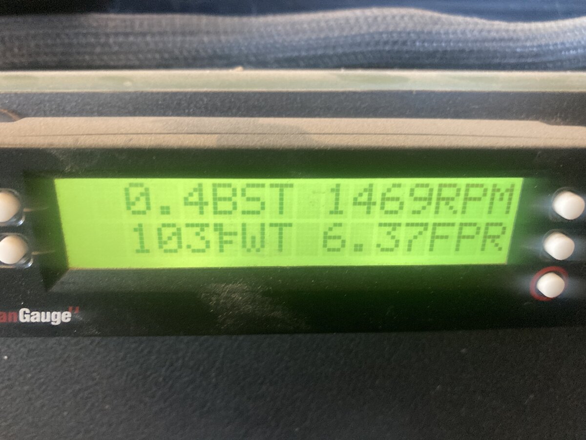

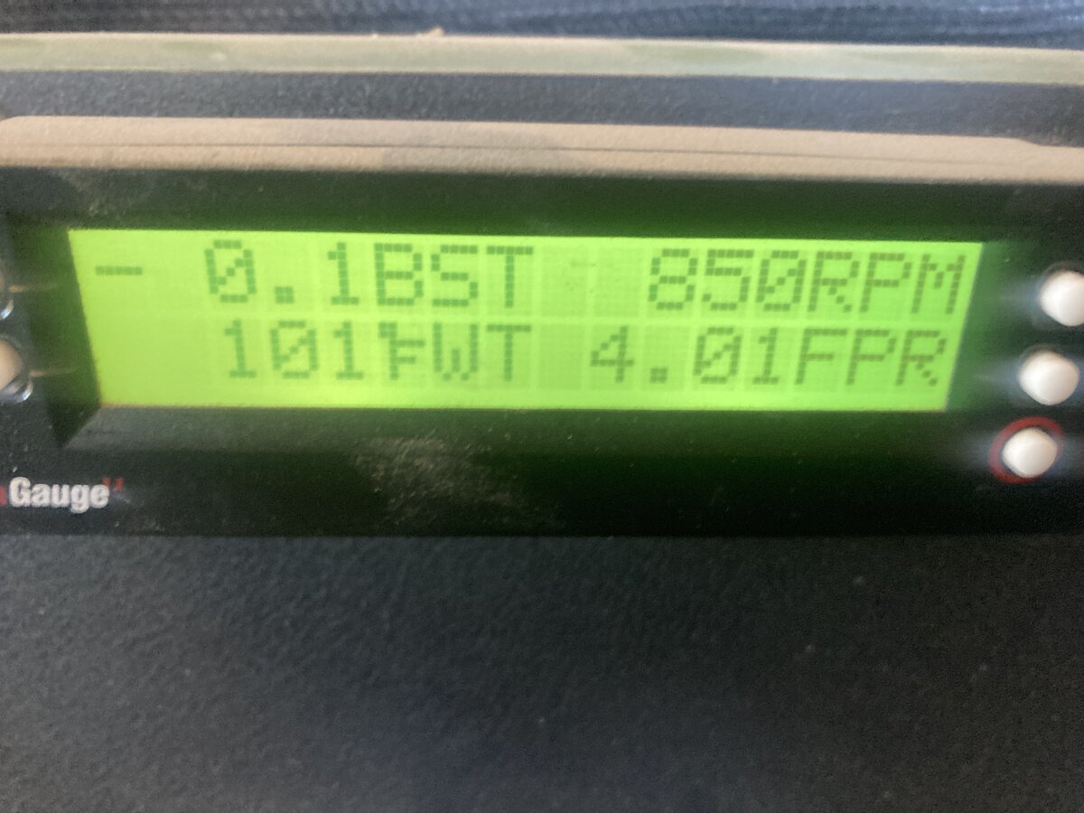

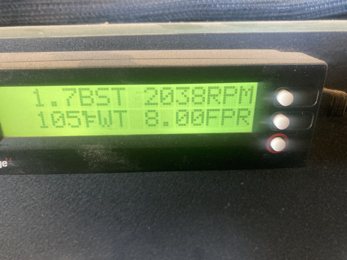

1,109
You can see the rpms and fpr. All readings sitting still. I tried checking pressure with key on and engine off and the pressures were slowing dropping to 0. Hope this helps.
