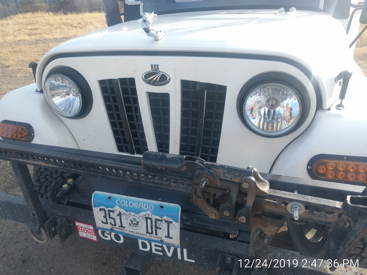

Front bumper is very light. Replaced it all with a piece of 4 inch channel iron and welded receiver hitch to bottom, Good Enough. Also attached D-Rings to front of 4 inch, can pull any thing.

I like the idea of the front receiver and d rings on the bumper.👍

Working ell Ford me,(farmer,) rc
