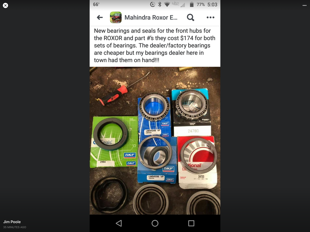

1,123
This was posted on Facebook as good parts for the Roxor. Have not verified any firsthand
