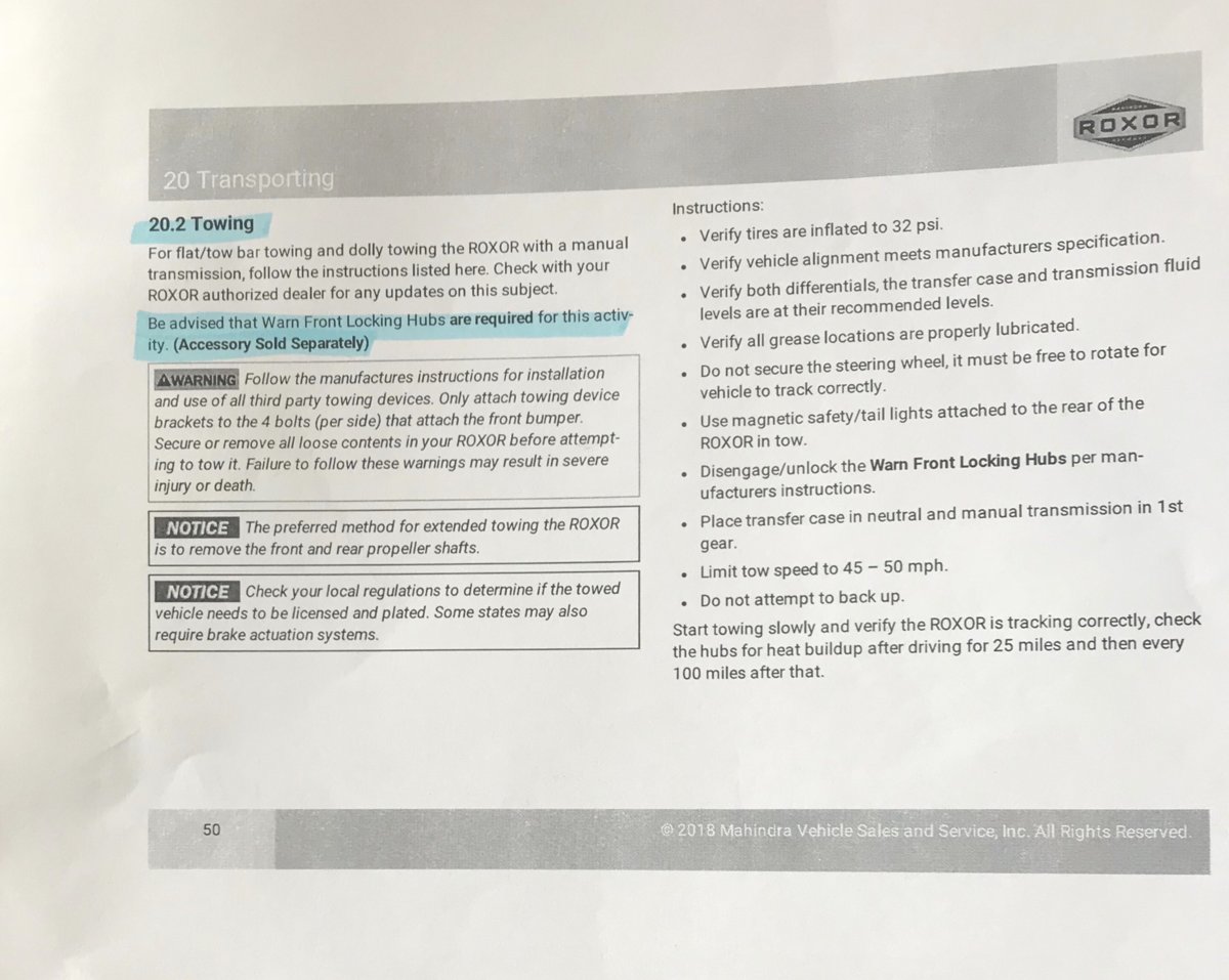

I have asked if with the addition of Warn Locking Hubs, and of course all transmissions in the neutral position will we be able to flat or dolly tow. I was told they expect so but engineers haven’t tested yet and no official statement. I look forward to the answer.

I picked up my WARN hubs and hitch assembly from my Performance Sports folks here in Seneca Saturday afternoon. I have an appointment Tuesday to have both installed by Clemson 4wheel drive. Installation of both above my mechanical ability. I will resubmit the flat tow/ dolly tow question and advise. Again when I asked the Mahindra rep he said they had not engineered it out yet and advise.

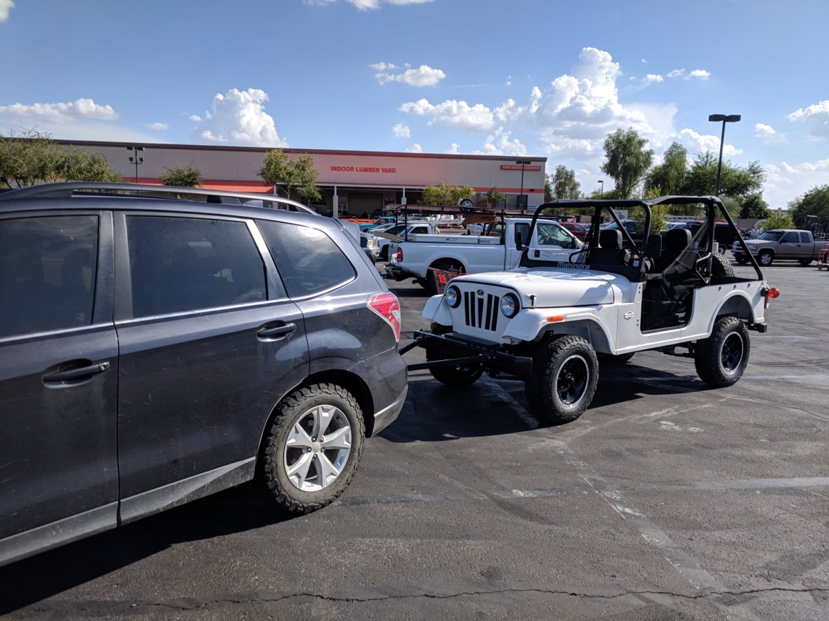

Flat towed from Phoenix up the hill to Prescott. No issues. Installed the tower bar in the dealership parking lot. Used one of the bumper bolts and drilled a second. Tow bar was $60 on Amazon and I also got a set of tow lights for the trip home.
