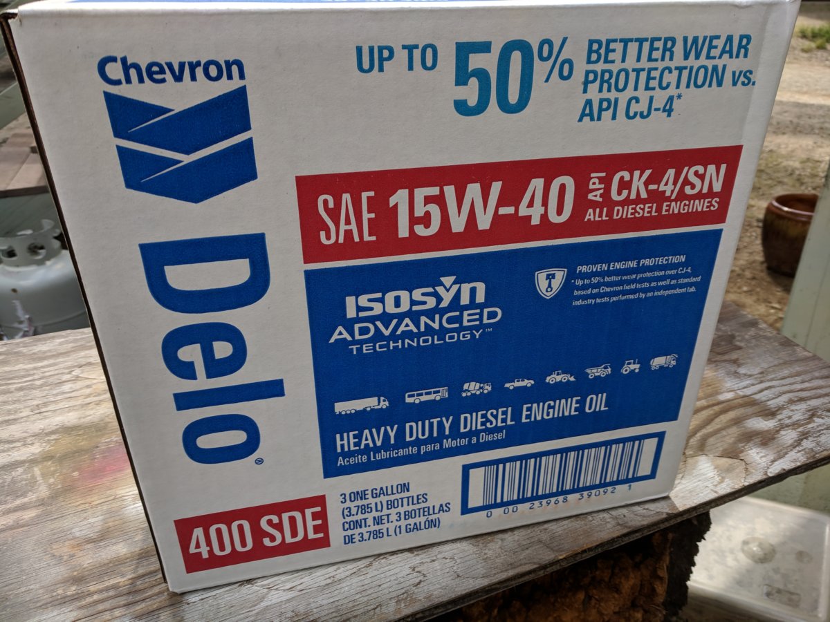

Hey guys, I am about to do my first oil change after the break-in period (300 miles) and was at Costco picking some stuff up so I decided to look at their oil selection they did not have the recommended 5W40 full synthetic but they did have diesel specific 15W40. This case of oil was $30 after a $10 off rebate at the register.
I am a noob when it comes to diesel engines so I am interested in what you guys think. Thanks!

Prob best to use the recommended oil. 5w40. API CJ-4 certified. For warrantee sake. After that is expired. And if your in a southern climate. I would have no prob running that oil.

That oil is OK to use in the summer.
The reason they spec 5W40 is for ease of starting in cold weather.
I would recommend Shell Rotella T6 5W-40. It is a great oil! That’s what I’m using.

Same! Rotella has probable seen more disel rigs past the million mile mark than any other oil.

Thanks for the input guys! I will head to the fleet shop tomorrow to get some 5W40.

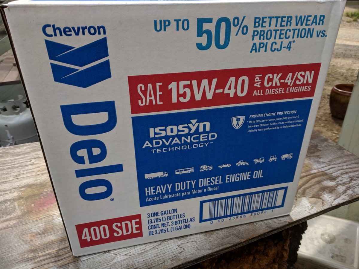

I am a noob when it comes to diesel engines so I am interested in what you guys think. Thanks! View attachment 1261
I’ll buy dealer recommended oil until warranty expires. No excuses for so few $.
