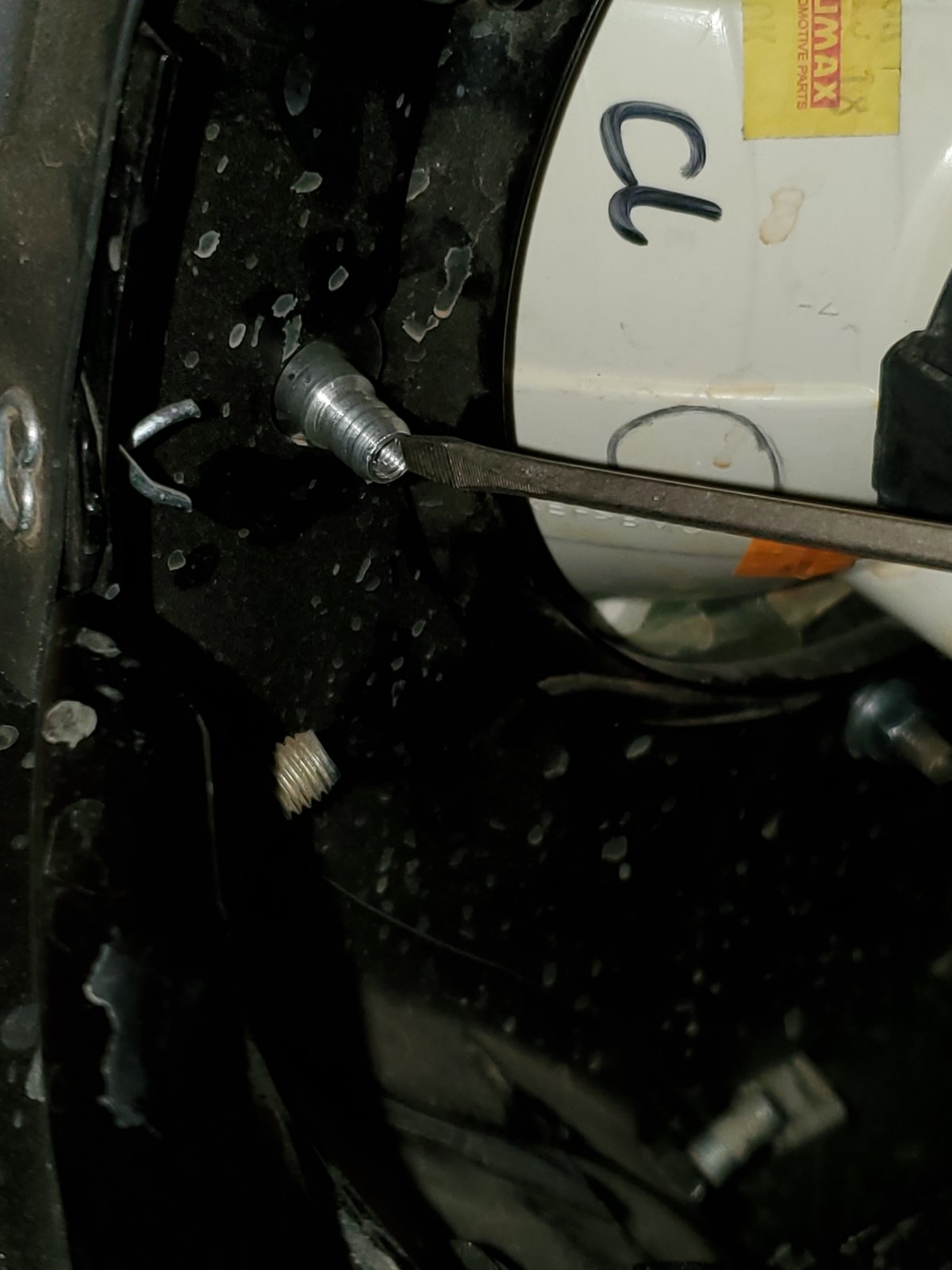

Is there a special trick to adjusting the factory headlights? I'm trying to lower mine, and the 2 adjustment screws on either side of the headlights don't seem do do anything. Am I missing something?

5mm socket on the back of that electric thing that's not plugged in on the top back of the headlight.

Turn the rear 5mm screw clockwise (as viewed from the driver's seat, I think) three times, and you'll see the lights move. It's easiest to shine your lights against a garage door or something so you can measure the amount the light lowered, 1 degree or an inch or whatever. Then road test it, and re-adjust if necessary.
