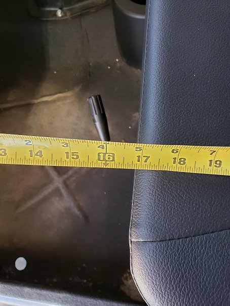

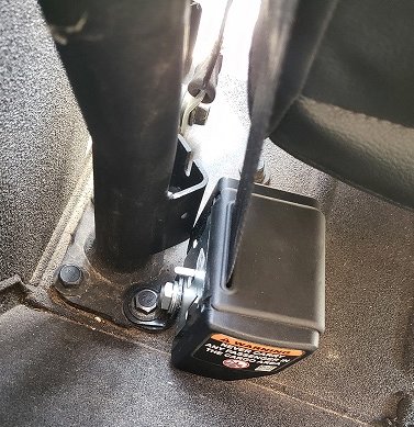

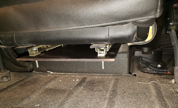

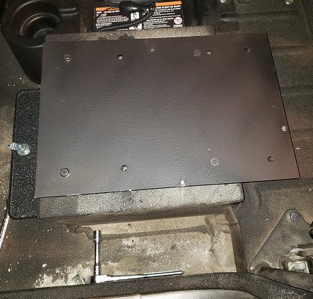

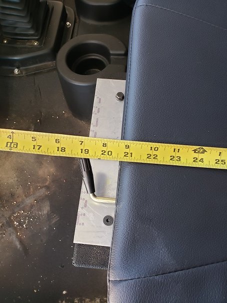

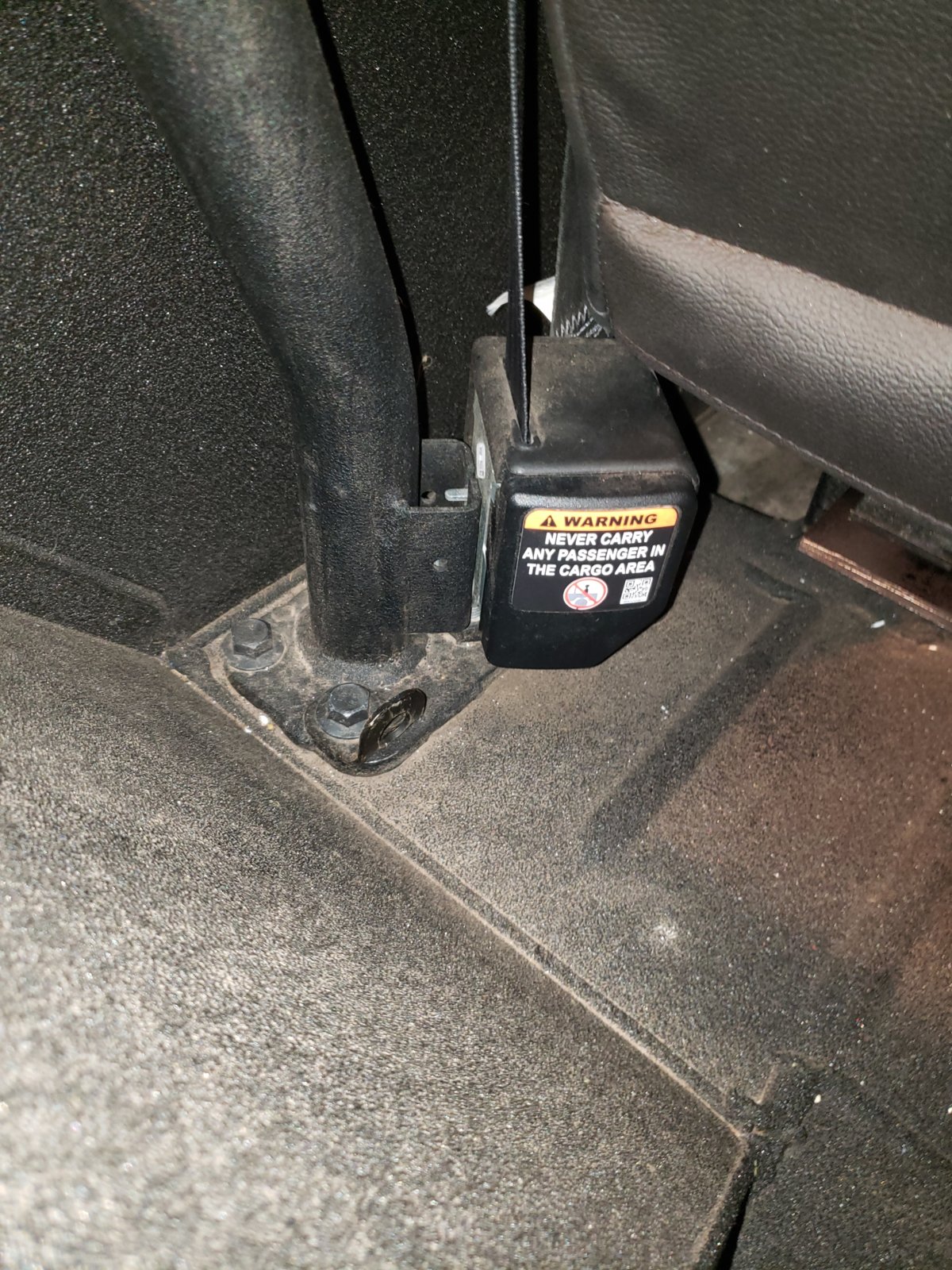

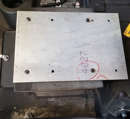

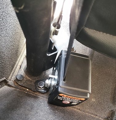

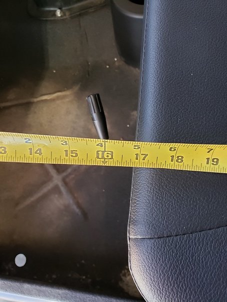

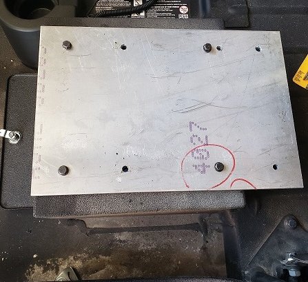

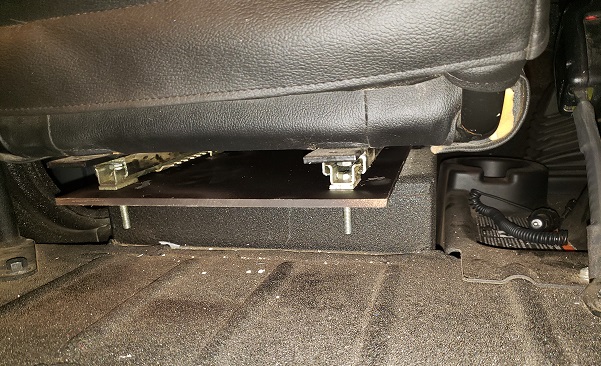

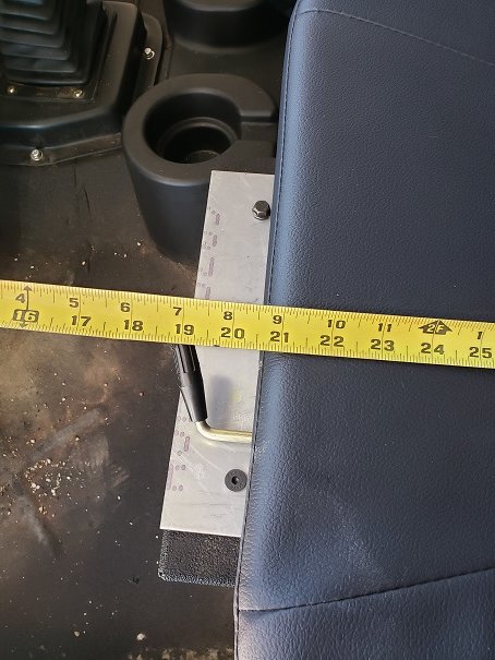

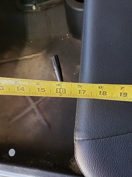

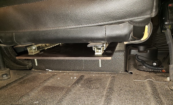

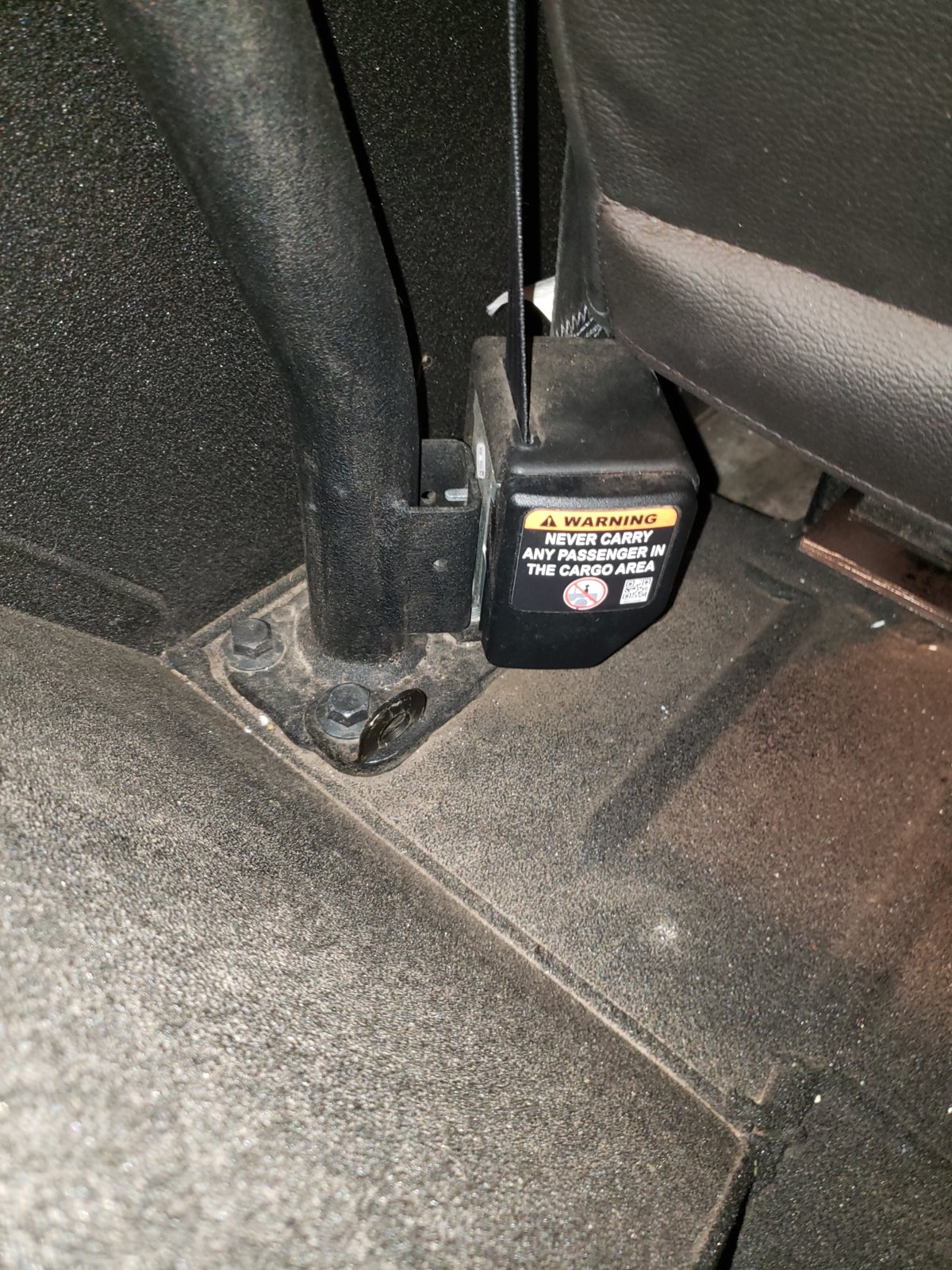

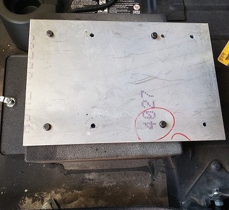

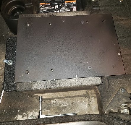

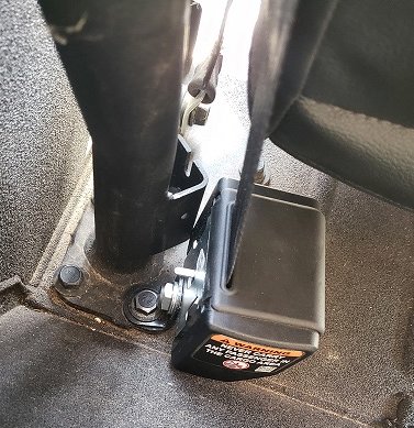

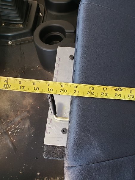

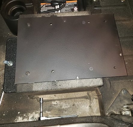

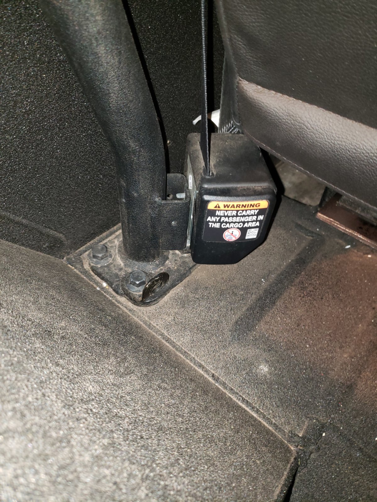

Well I now have enough room in the drivers seat. I took a 12x18 piece of T6 6160 and bolted it to the storage box. I then drilled the seat brace holes 4" back. The seat moving back hit the seat belt re-winder so I used an existing bracket, bent it up 90 degrees and hooked to it. Went for a drive today and it was great!

View attachment 5082View attachment 5083View attachment 5084View attachment 5085View attachment 5086View attachment 5087View attachment 5088
Bob, this is a great idea. I'm 6'4" and will probably need to do the same thing. I have some 2 inch wide, 1/4 inch thick steel strips. Could those be used on both sides instead of a big plate?

I used the plate for the extra stability because I am a fat @ss also. The plate will not bend like the strips in my opinion. If you use the strips you may want some sort of bushing to go from strip to floor.

Bob, I forgot to ask. Is the plate aluminum? How thick is it? Thanks
