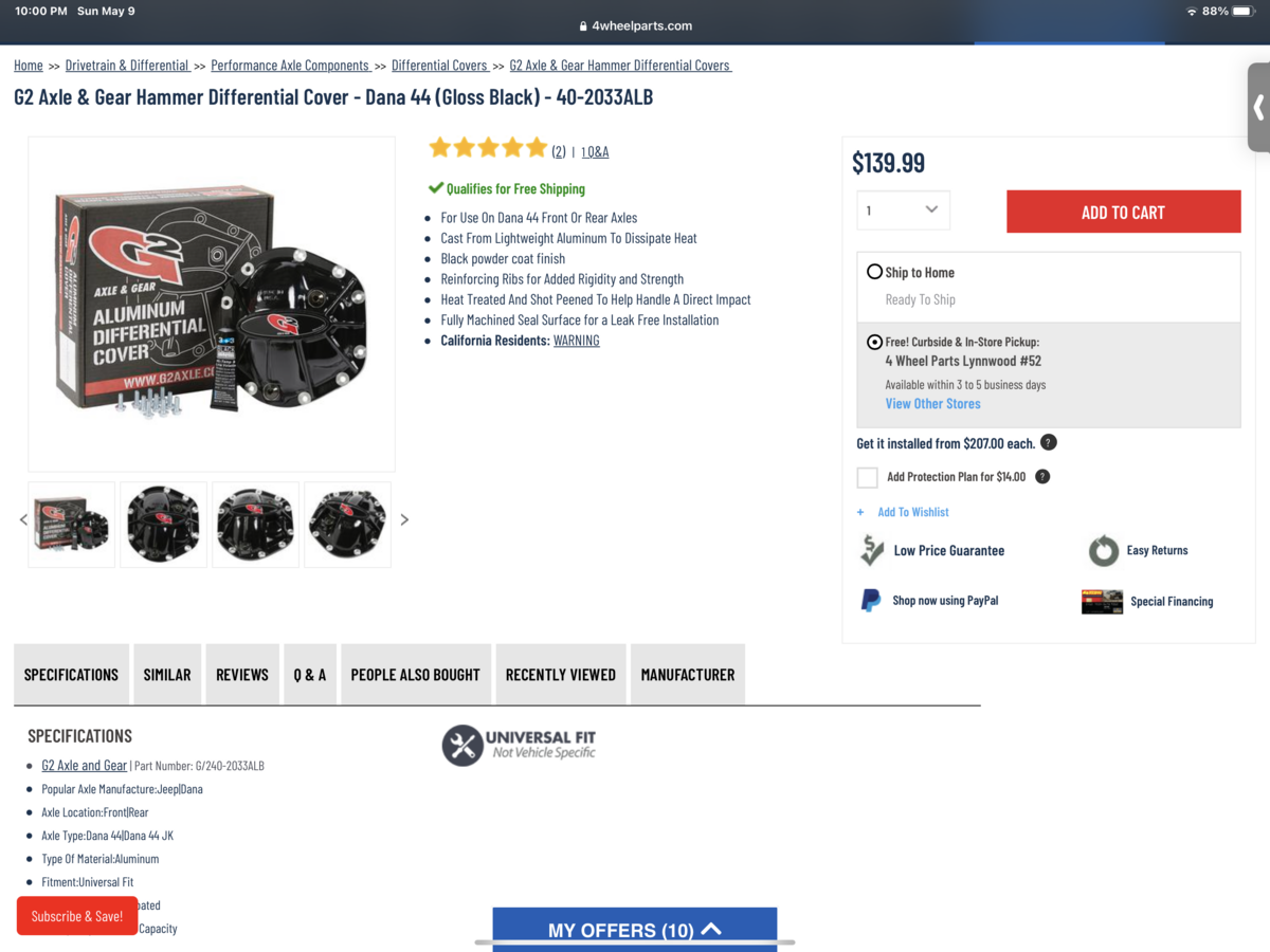

ive read that the roxor differentials are basically Dana 44’s ? Has anyone tried one of these after market covers ? I like the g2 brand do you think this would fit the rear diff ?

I went ahead and pulled the trigger on this and it fit perfect took a little more gear oil but the fit and finish is great super happy. With it. I’ll post some picks soon. Thanks
