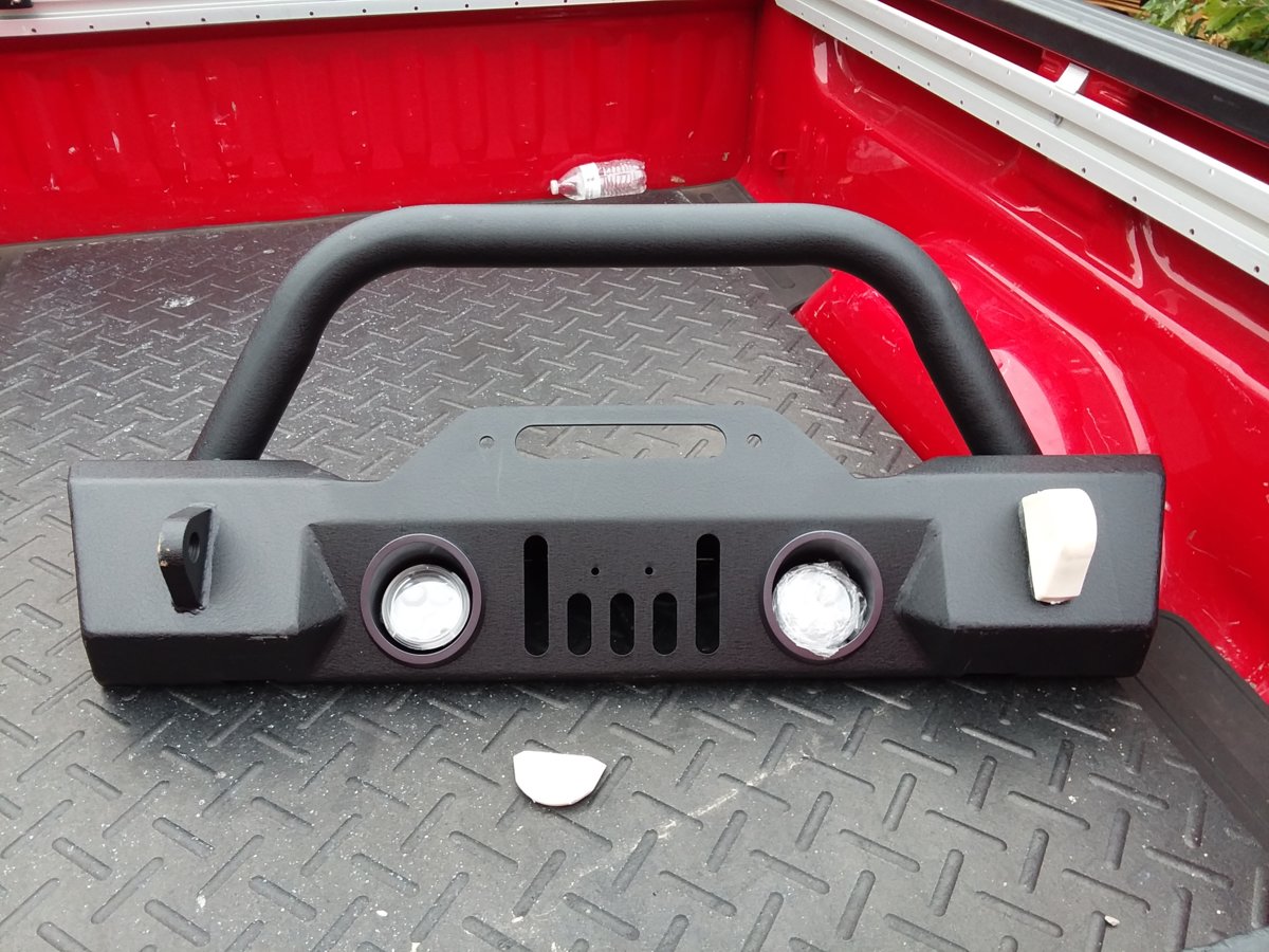

I just ordered a CJ7 bumper and it doesn't fit :{. It was an EAC from Amazon. We need stubby bumpers so bad.

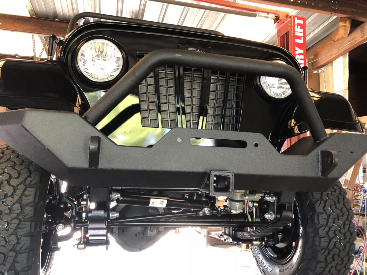

I pulled my bumper, its just light guage sheetmetal, like the body thickness.
I am installing the bumper shown below - they are like 250. I just have to make 2 brackets to adapt it - very straight forward, but I have a shop.

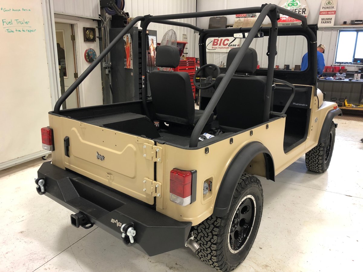

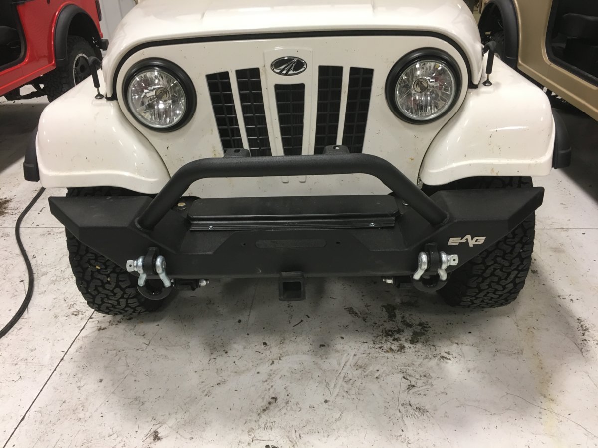

189
I installed a Tj winch bumper with the supplied u bolts but I wouldn’t feel comfortable mounting a winch on it and using it. I looked at the measurements for all of the Jeep models from 48-current. The Tj matched the closest. A non winch mount Tj bumper would work fine using the winch plate already mounted on the LE models.

How many mods were needed for attachment of this bumper?
Who did you get it from?

Where did you get this bumper?
The bumper is EAG, no modifications. It clamps on with some thin u bolts. Looks good but the cheap mount makes it almost unusable

Thinking about getting one and building a modified attachment so it is usable...

It would work great if you made some actual mounts for it. It shouldn’t be to hard

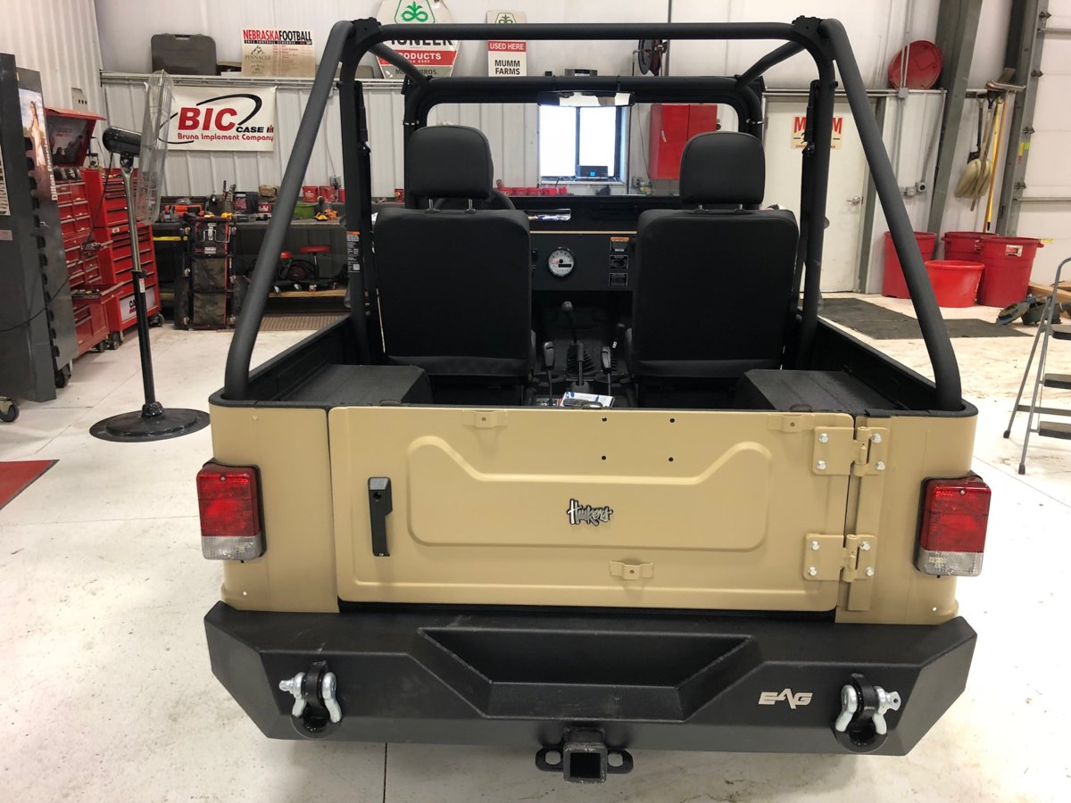

Sorry for all the questions but will the Spare tire and holder from Roxor work still and be able to fit into that slot on the rear bumper?

Yes, depends somewhat on how you mount the bumper, but there is room there for the tire.
