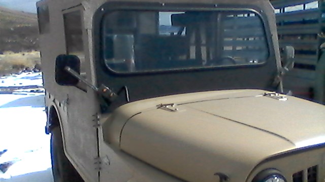

Bought a On the Rox windshield frame for $650 plus $125 for glass.

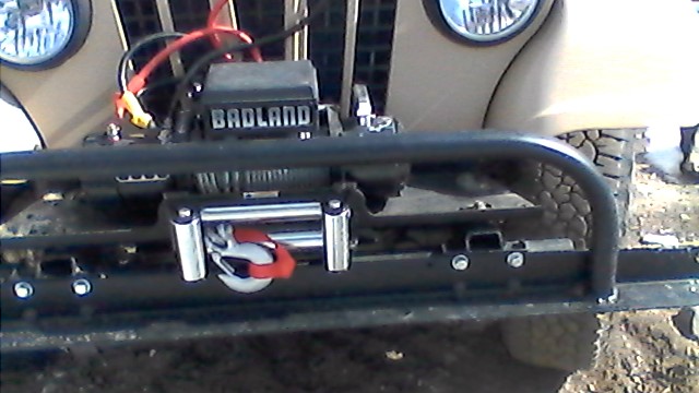

Harbor Freight 9000lb winch and modified their mount to fit the frame. Used a tractor battery disconnect switch right off the battery to protect the positive cable from shorting out in case of an accident. $300
Bought a 10' stick of 1/4" wall 3" x 3" angle iron and built front and rear bumpers. 2" receiver on the back and a loop on the front to protect the winch. $100

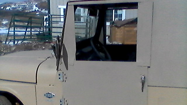

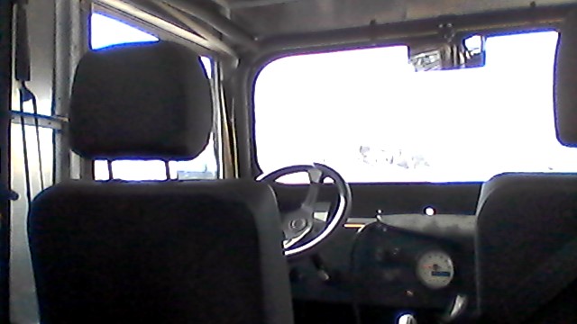

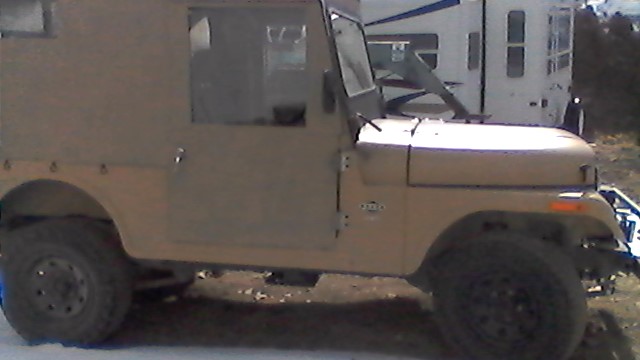

Then came the fun part, using 1/8" wall metal, 1" square tubing, 1" angle and 1" flat bar I welded up a full hard top cab. Angle iron to make a lip on the tub and square for the corners and top bars. Just cut and tack welded on the body until it was a skeleton then pulled it off and welded it up. Had several 2' x 4' sheets of aluminum from another project. Pop riveted them to the frame. Door hinges are fixed pin house door type from Ace hardware. Door handles all keyed alike from Amazon. Primed everything with Rustoleum self etching primer. Then sprayed everything with a gallon of Raptor bed liner tinted to match. 6 bolts hold the top to the tub. I'm tall so the roof is about 6" higher than the windshield. A 1" piece of flatbar rests in the groove on the windshield. 1/4" plexiglass is used on all windows. The door windows slide up and down in a U track from Ace hardware. Still working on a system to pin them in the up and halfway open position.
