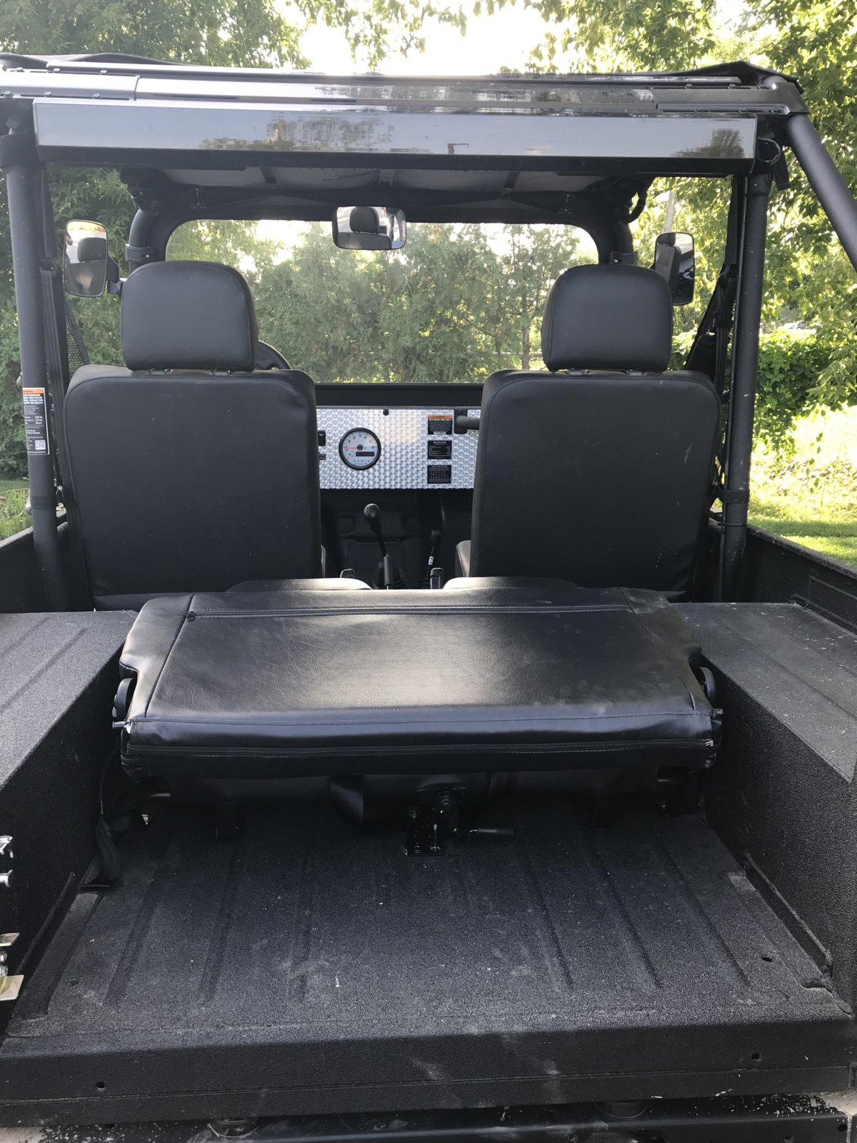

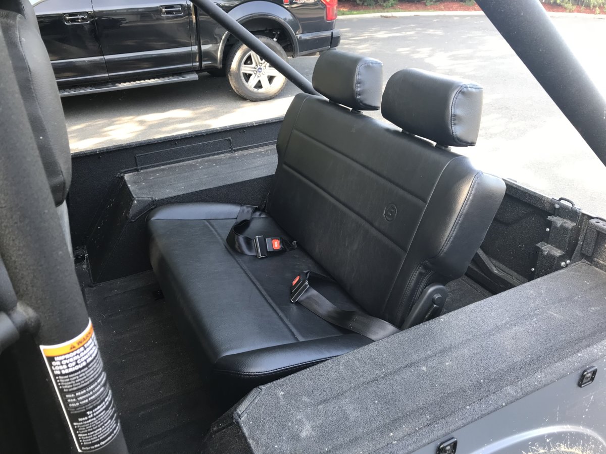

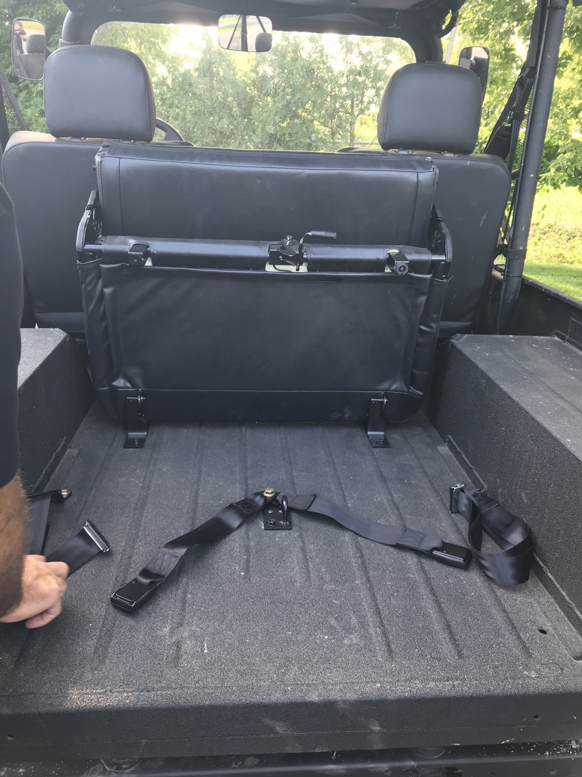

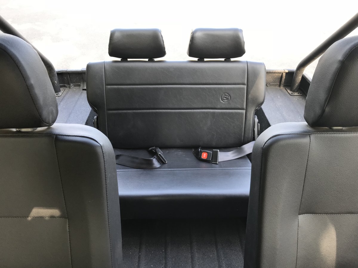

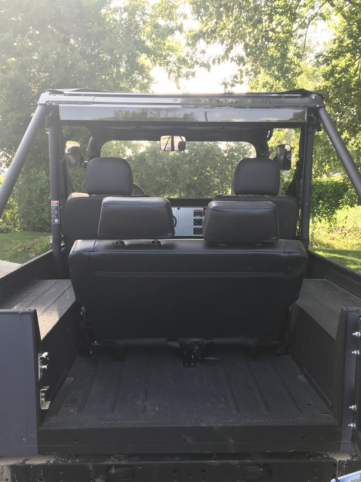

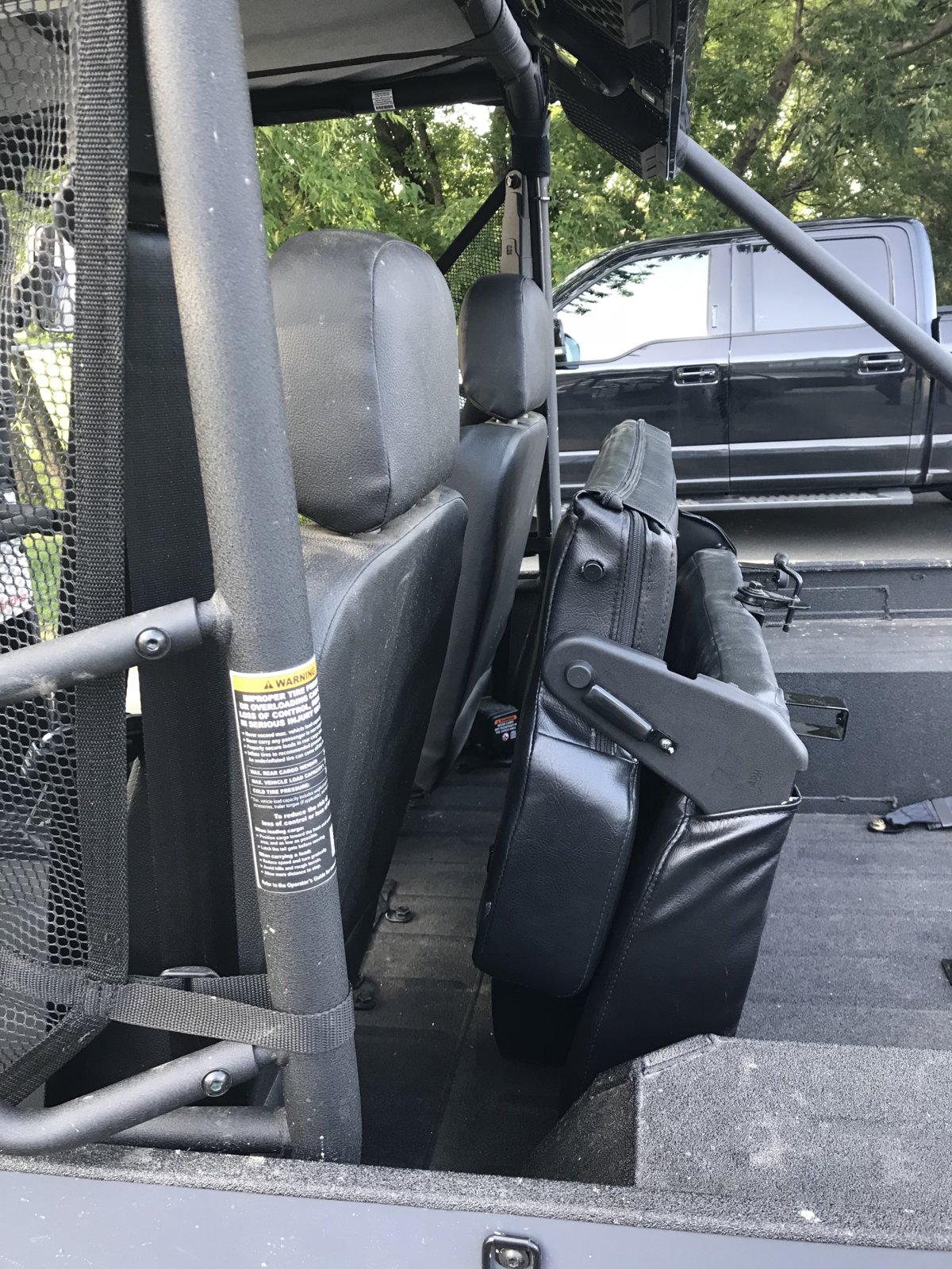

Here’s a few pics of Bestop Trail Max II (Part# 30440.15) and crown seat belts (Part# BELT1B)

Install was pretty straight forward. Directions are decent, but they are laid out for wrangler seat replacement.
We started with placement of the seat from top side. Where we thought it would be best for legroom as well as cargo space. Then we went underneath to determine if access was easy or appropriate location to drill and bolt. Seemed to work out pretty well. Overall I’d highly recommend. The vinyl is a different grade to oem Roxor seat, but it’s close enough (I’m a little fussy).
Seatbelts were a different story. No directions, but again install was pretty straight forward and common sense.

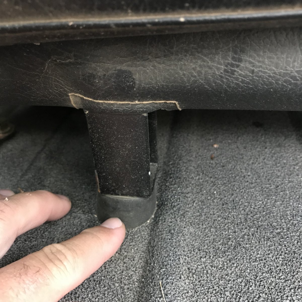

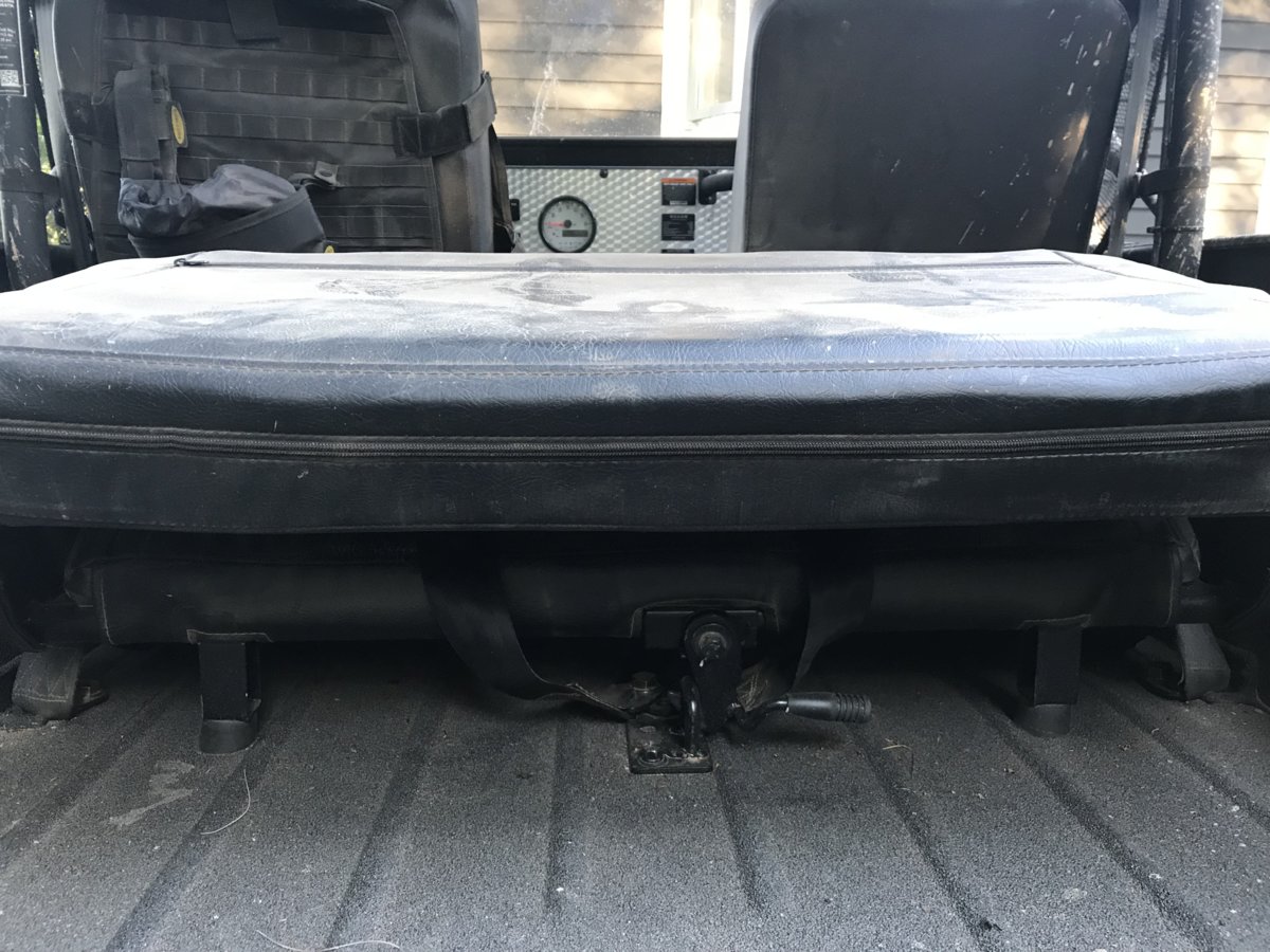

The only modification I had to do was for the seat stoppers on bottom side where the rear of the seat is anchored. We had to add larger rubber stops to get the seat to latch with a tight fit. (See pic below)
E9512881-94B0-4B06-AE4C-F7DC668B3C18.jpeg 95383428-CF81-4C91-9615-5FF145C55453.jpeg 885E1D15-4428-4289-8365-F7607ED8585D.jpeg

Yes. I agree. Also be careful some seats look the same, but not all include mounting brackets / hardware. They make the assumption you are replacing an old wrangler seat and that you will swap hardware. Good luck:)!

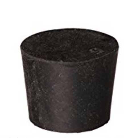

I’ve been asked what I used for seat stoppers on the rear seat install. Although I don’t have a part number. It was a plain rubber stopper from a local hardware store. Which I drilled out and used the bolt from the original stopper. See pic below. Hope this helps.

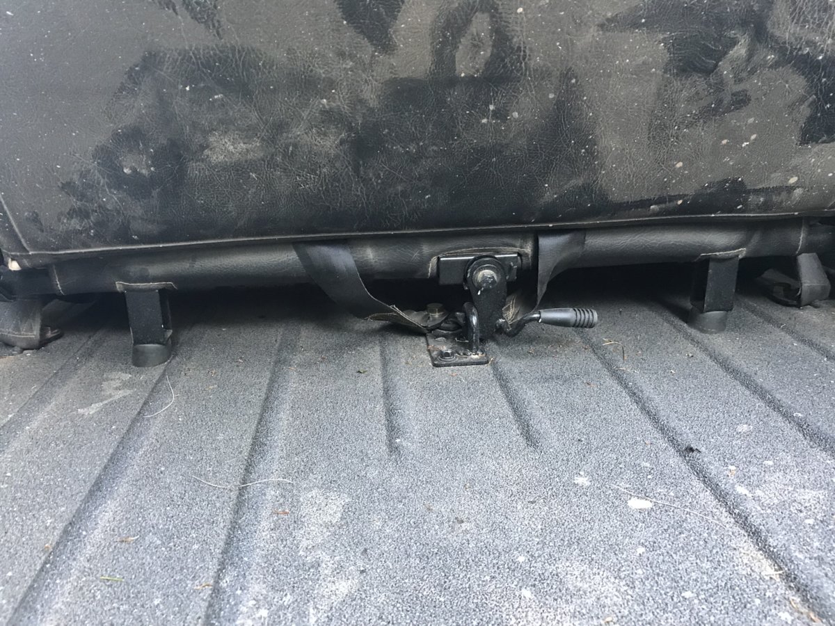

i didnt like the rear latch sticking up in the middle of the bed--- so took a small -u- clamp drilled holes added two springs under bed over threads and put crown nuts on---- lift up to latch seat solid and when not in use it stays down and doesnt get in the way
Pictures please
