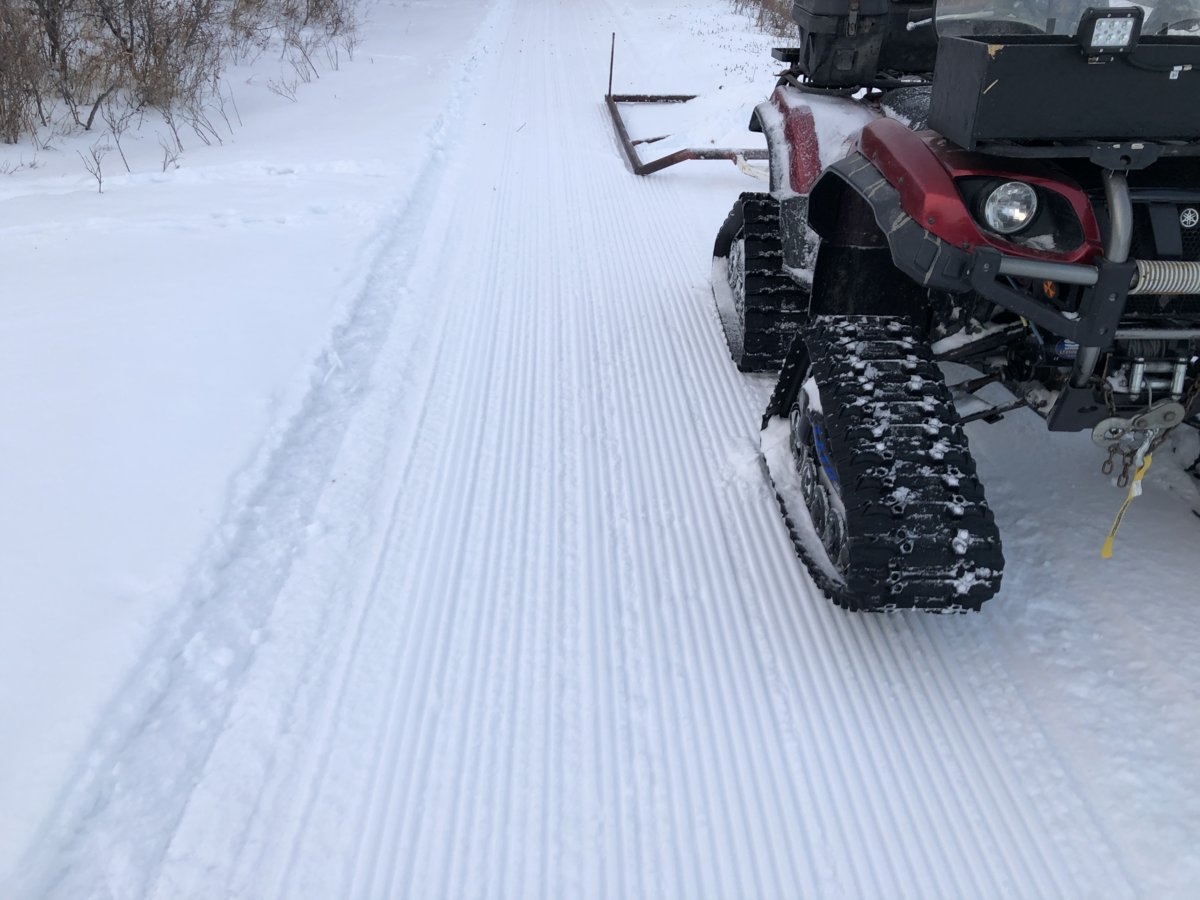

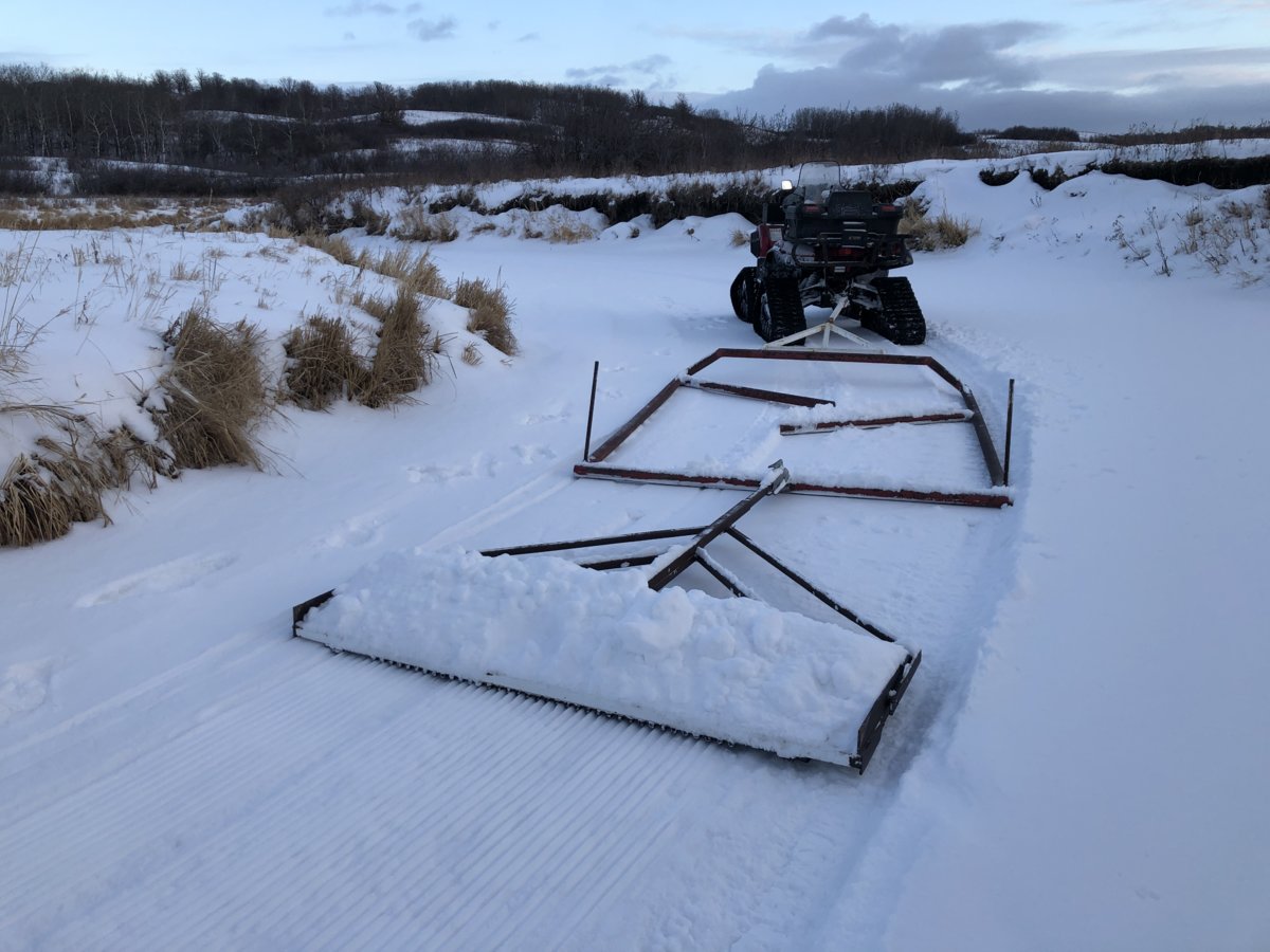

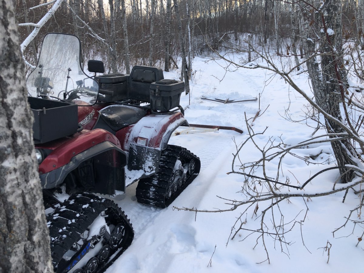

I looked a them, to pricy for me, but I said the same thing when I bought tracks for my Grizzly. It's my go anywhere machine. and groomer/drag puller.
The track system from Roxor says that you can't have lockers in the front, I have lunchbox but probably the OX would be OK, just don't engage it; so that would put me out of the market. But it's not something I really need around here anyway, but they would be awesome to use it as a groomer or in a snow resort, etc.

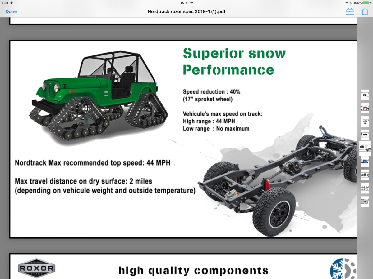

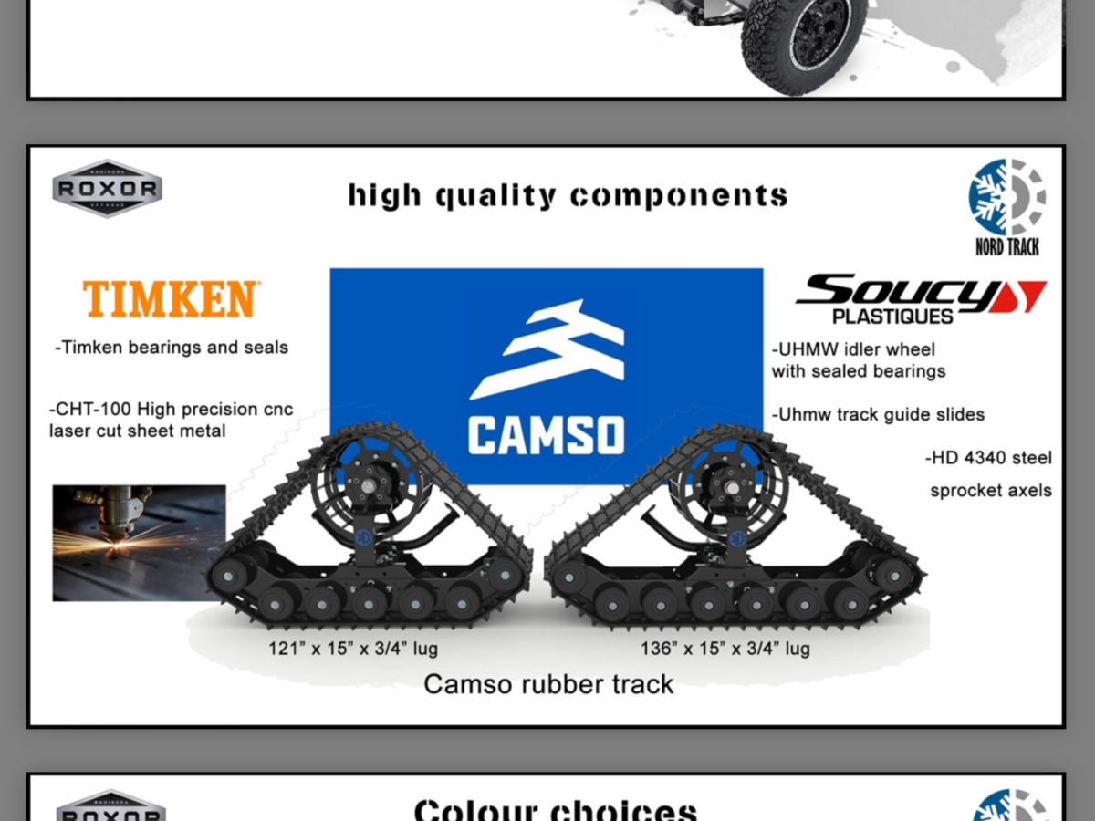

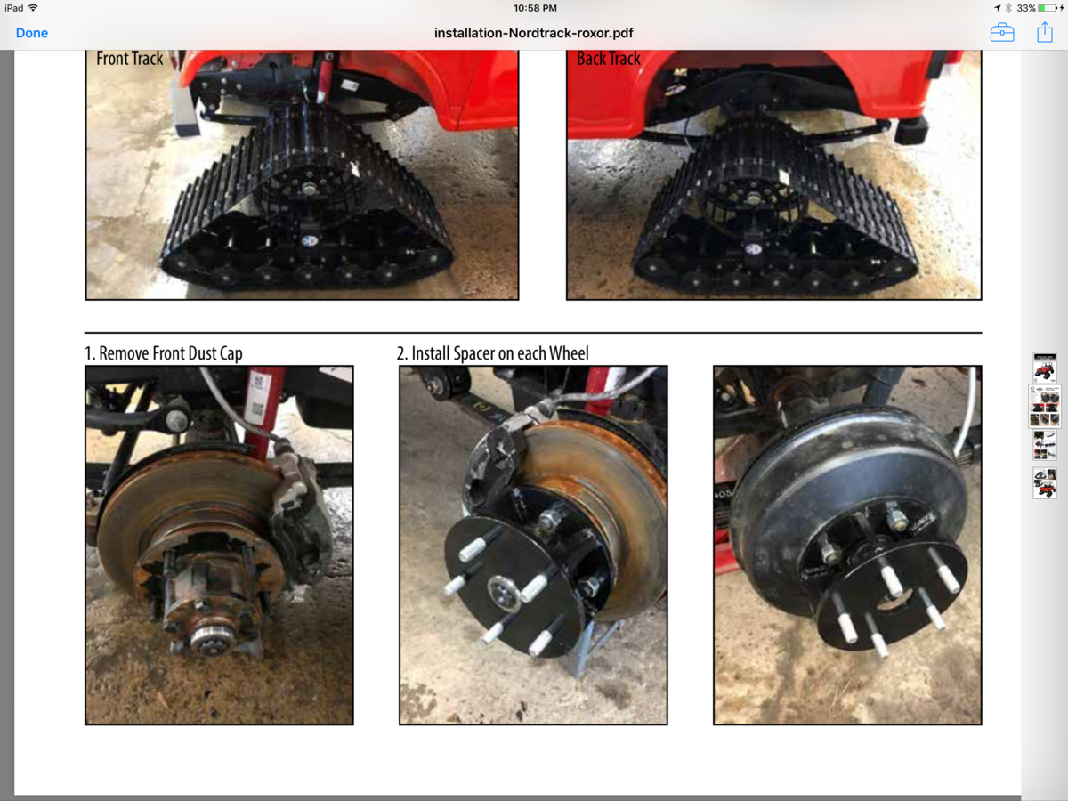

The Nordtrack you cannot have Warn unlocking hubs but lockers are fine.
Just about 1/2 price of the OEM Mattracks.
Would having the hubs be OK if you just leave them engaged? Anyone with lockers almost always have hubs also.

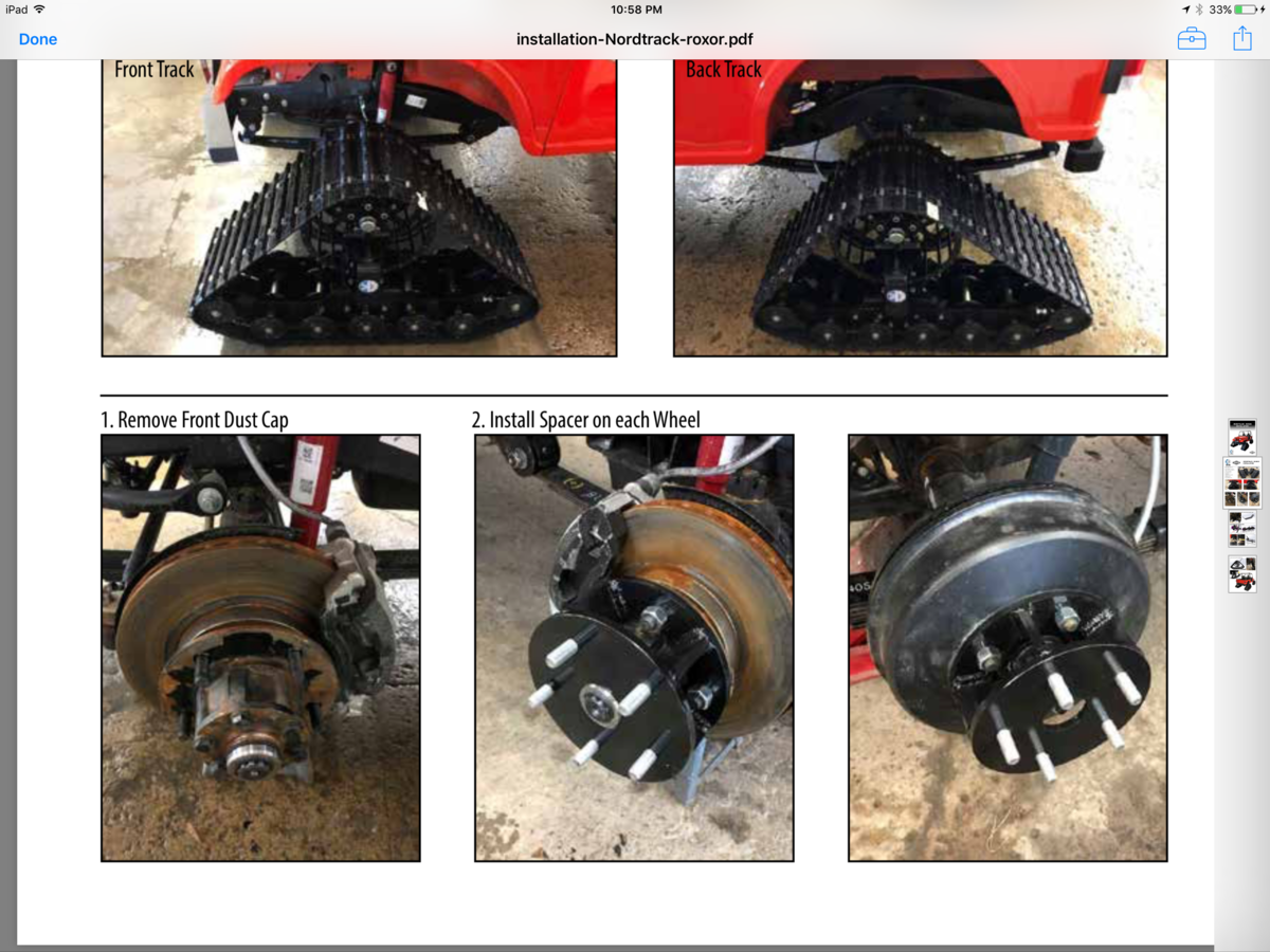

You need to remove them to fit the 3" wheel spacers. I bought a set of Warn but wont install them as I may go with these tracks.

You gonna do trail grooming with it?

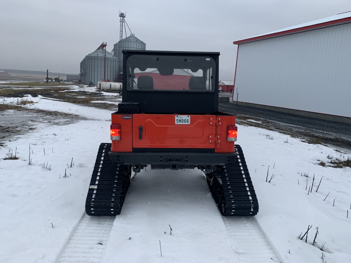

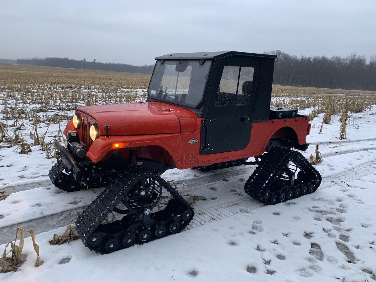

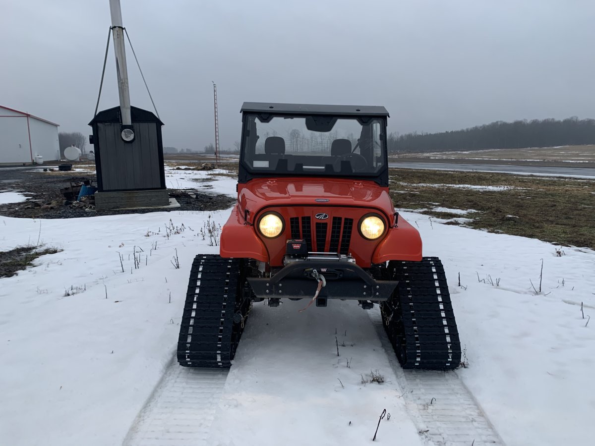

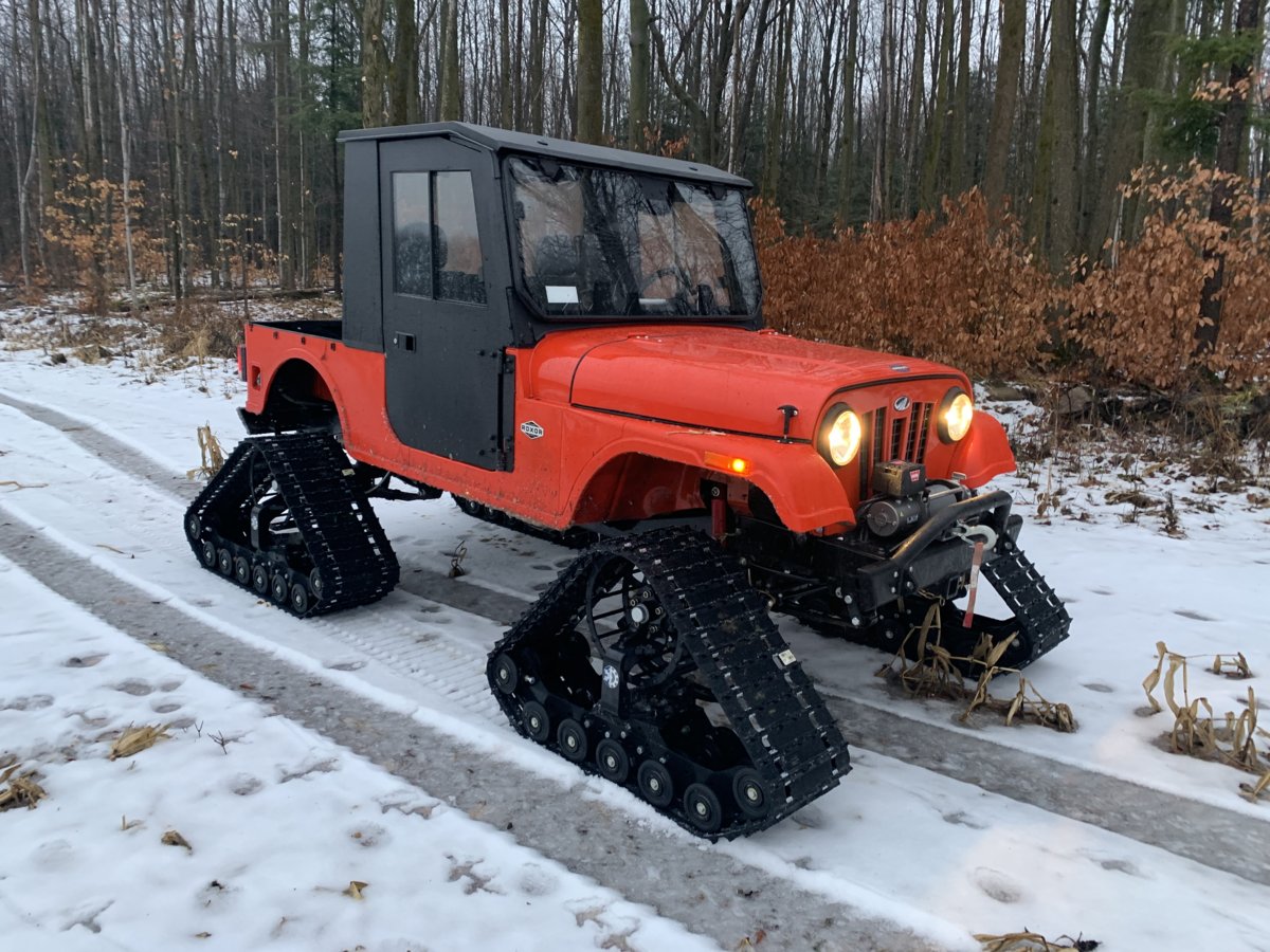

So we got more snow and got to ride yesterday. The snow was wet as it was around 0 degC and I could only get to 3rd gear.
Today was colder at -6C and I had no problem running in 4th gear. Speedometer was showing over 50 mph but I got suspicious and ran a gps app on my phone and it was showing 28-30 mph in 4th gear @2000 rpm. The highest I got was 33 mph. It was a lot smoother riding today with the colder temps and harder snow.
