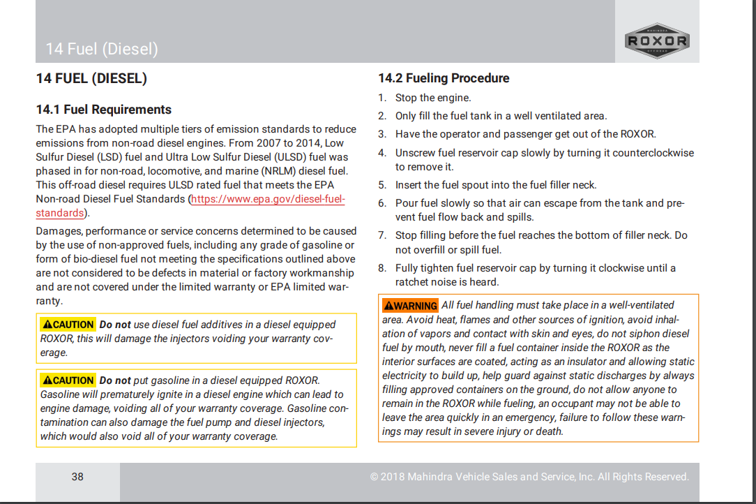

What do you guys think of using anti gel in these? I though I read in the owners manual that you should not use fuel additives. I left my manual at home and I brought the roxor to the mountains this weekend where it will stay. When I leave I thought I should put some in? What are your thoughts? I might make it up once more this year but not sure. Just want to dump some in before I go. I don’t think it would be a problem.

Section 14.
https://d3lwr7t4tsy765.cloudfront.net/ROXOR_Operators_Guide.pdf
Using Number 1 or winter Diesel (thats what we call it in Canada) fuel should be all you need, it should have all required additives for winter and I believe they switch over the pumps sometime in October up here (I think). Unless maybe you are driving in -40. I run my small John Deere tractor all winter and never have a problem, I don't see the Roxor being any different....
