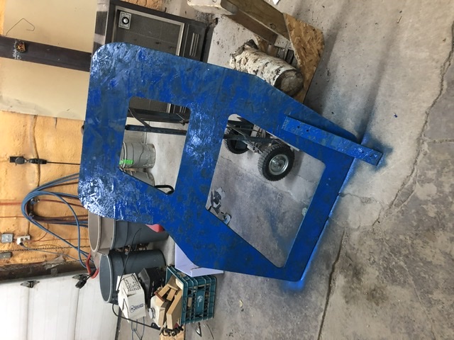

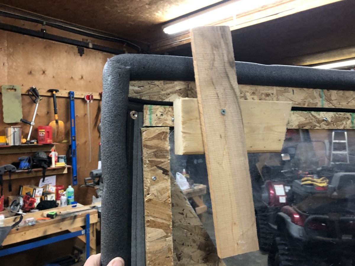

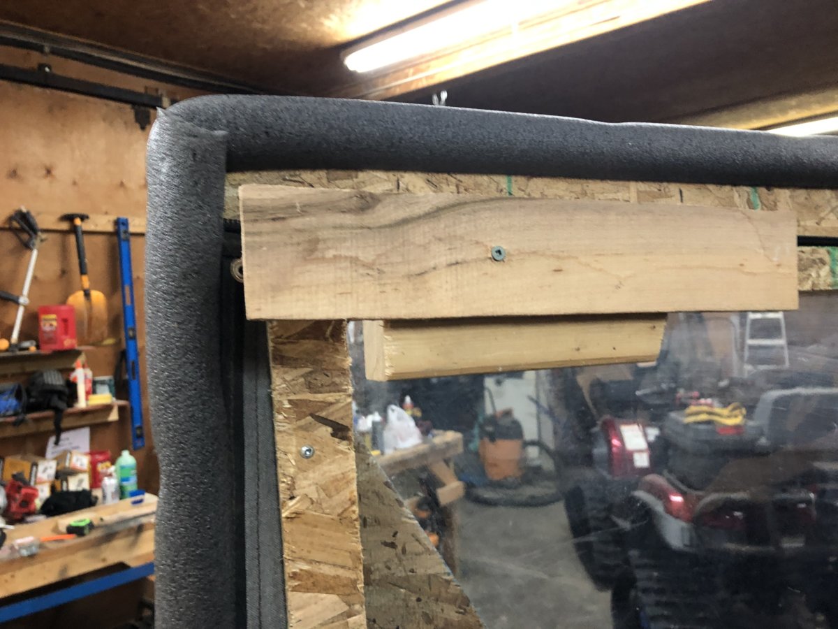

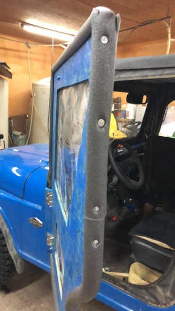

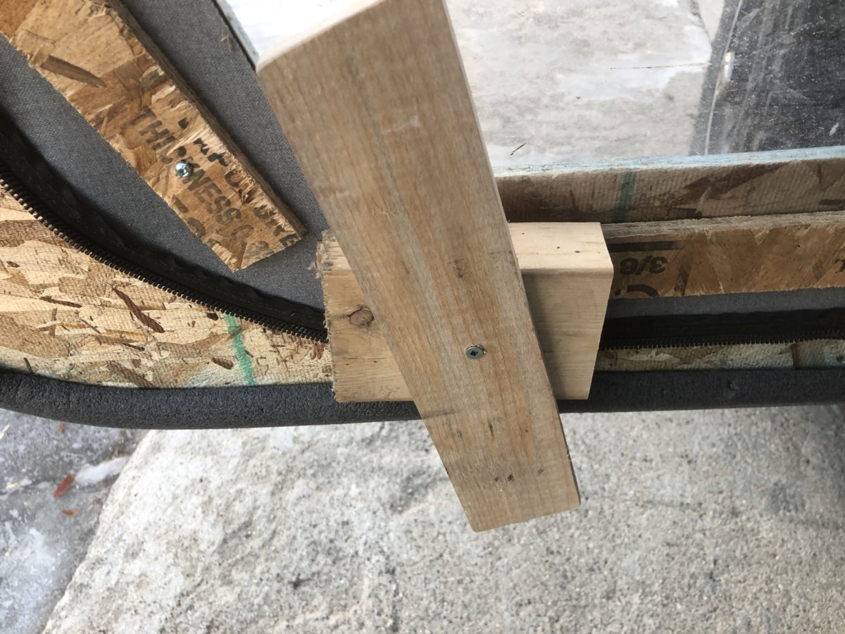

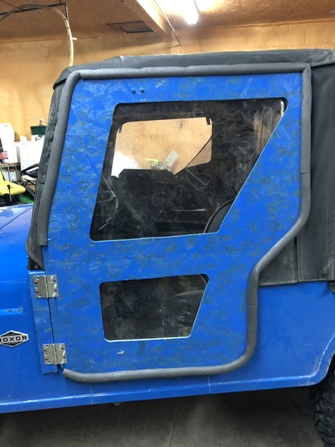

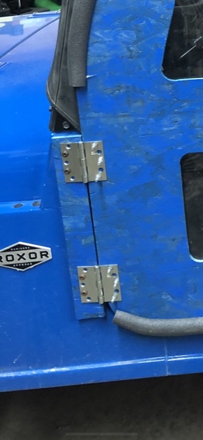

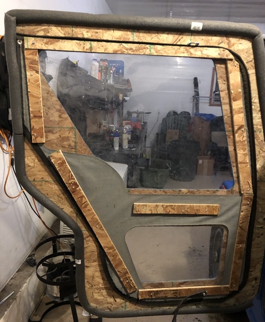

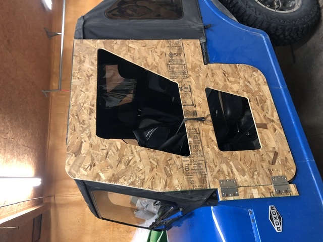

Whoa, did you make your own door or what's going on there?
Yeah. The zipper door failed twice, they sent me a third one under warranty, no questioned asked, but while I was waiting I needed my Roxor; so, I spent $13 on some OSB and a couple hinges and came up with a temporary fix, but now I like it. I put one of the failed doors on the inside with wood strips and I left the original out part on to keep it sealed. It works great as goofy as it looks. I’ll keep it till someone comes up with something affordable I like. I made some wood latches that grab the ROP that hold it shut, nice and snug. Absolutely nothing fancy, but “function over fashion”.
PS. That is pipe insulation around the outer edge. Cheap.

Wow, amazing! You give me so many ideas!
