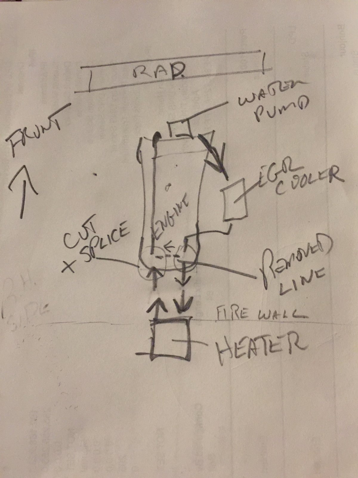

If you do install anything, you run direct from the hose coming from the EGR and then back to the hose on the left, that way you get the most heat possible out of any heater. You can't turn it off in the summer, but if you added a couple T's and valves in the right places you could. Lots just put in the T's or Y's without shut off valves, if you do that you only get half the volume of water. The air coming out of anything run direct should be about the same as mine which is 185F when it is working or driving. It drops some when idling. It will on any heater. Have a 3 speed resistor switch coming for mine to get rid of the single speed. It's $7.50 and should come that way from the factory. Like I said, they might be changing something to make it multi-speed, if they don't , they should . lol. I'm glad the heater I went with had a defrost kit available, not everyone needs that, I need that in Saskatchewan with a couple panting dogs and me after a walk.
Where do you get the new hose used as a tee after the water pump.
When I ran my hoses I had removed egr cooler, so I used the same engine ports the cooler used. No splices. Gate valve in heater dead heads the hot water at the inlet. So core does not heat up. Have not needed defrost down here. Open cab still. Heater is used mostly to warm cold hands.
My heater is on the same line, direct, but I can't dead head because I am still running an EGR cooler. The air is super warm with the direct method. I'm sure yours is Woodsman. If I wanted to turn off my heater, I would have to add valves an T's in the proper places to do so because I still run the EGR cooler. It would be easy and only cost 2 T's, 2 valves and 6-8 hose clamps; I would have to draw a map for the correct amount, but you could re-use the 4 that are there. lol
Here is the artists rendition to make things clear as mud. Lol
As Woodsman mentioned, he removed his EGR, so he can close the valve on his heater and dead head the line. I can’t. That is where valves and T’s come in if a person wants full heat in the winter and no coolant coming through the heater in the summer. I drive when the evenings are cool, so I always leave the heater available if needed without opening and closing valves. If needed I can be artistic and sketch it out, but it wouldn’t be no ‘van Gogh’.
I had cut the hose from the water pump and installed a tee. The factory hose is molded on mine
Ok, so you're splitting the coolant the EGR and heater, that might make it a bit cooler, might not. My air is 185ºF when the out side was about -10ºF. I assume you put a valve into your heater line and it can be turned off. I would have to add 2 T's and 2 valves to turn it off. I always left mine on on my old Rhino, lots of times I'm coming home after dark and it's a bit cool. If it is too hot under the dash in an open cab in the summer, I'll add them in later. Easy to do.
