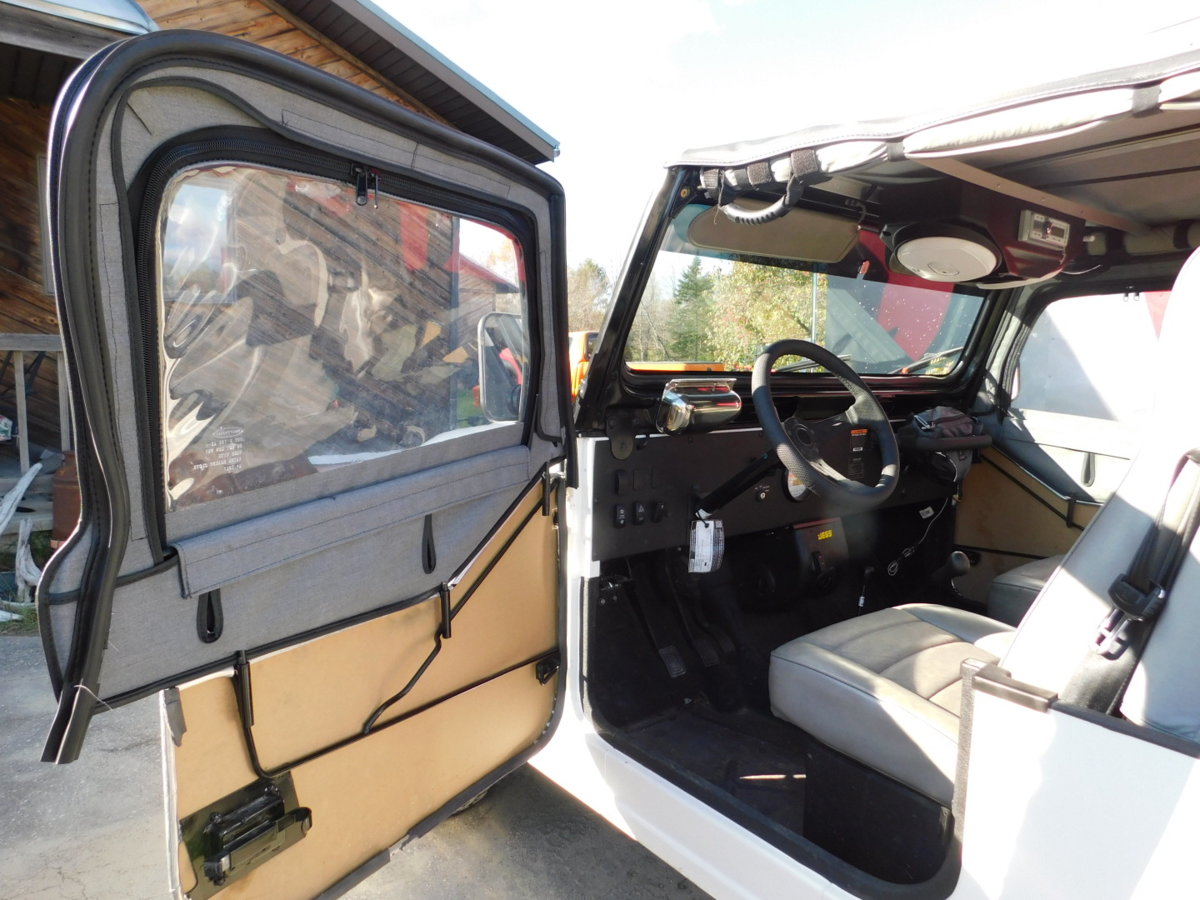

The frames were completely refitted to work with the Roxor tub, then the top needed adjustments to fit the reworked bottom. No matter what you start with it’s a custom creature.
The wind screen needed no adjustments, but we changed over to Jeep (windshield, interior, and roll bar) alternatives on many of the accessories.

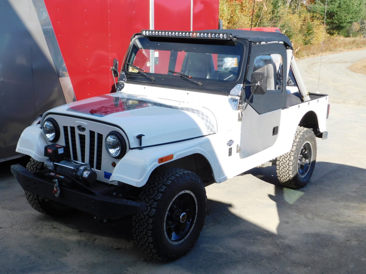

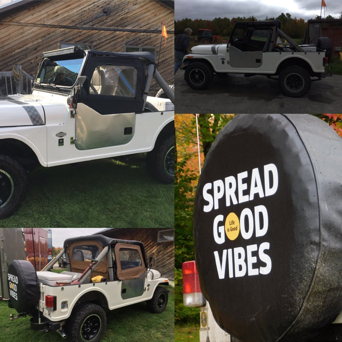

New Jeep bikini top $45 , windscreen $75, repurposed soft door bottoms $100 (aluminum covering), Jeep soft tops reworked $200 . Jeep windshield, roll bar and interior from donor vehicle. (Seats front & rear, roll bar padding, and tons of hardware) The saving is huge.
5CF6D6C7-47AF-46E4-9C0D-5E38D58D9CFD.jpeg A227D59B-2FF0-4CAE-8AC5-A48DAB1806D3.jpeg
View attachment 1611View attachment 1612
Now, this is the way to get things done....everyone needs a doner CJ ! I especially like the half doors and the removable upper soft section......they all should be made this way !
