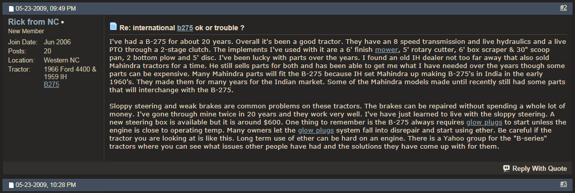

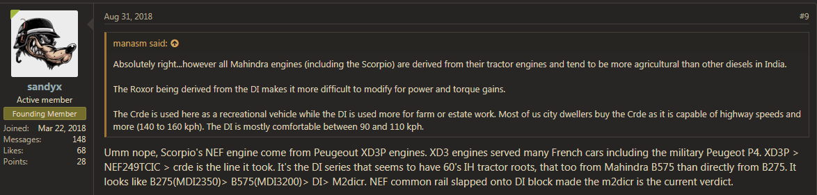

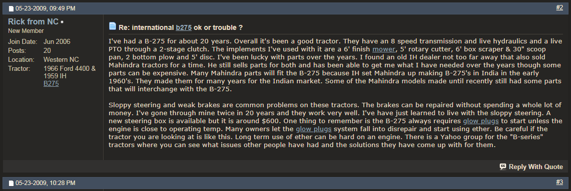

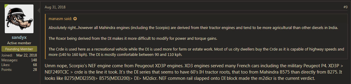

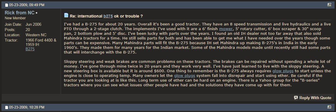

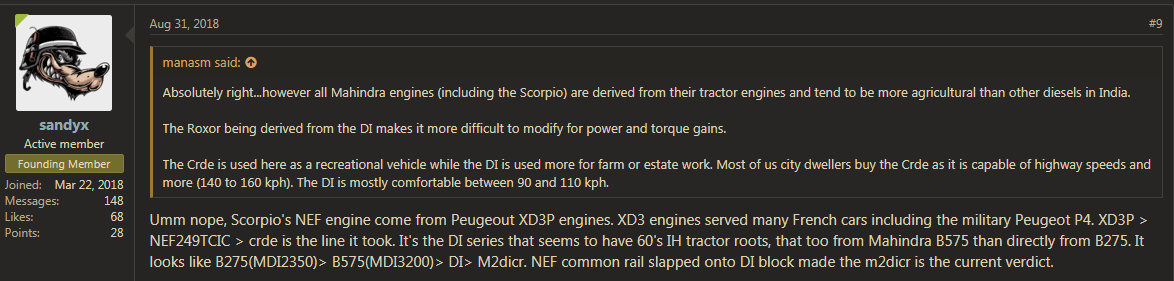

A lil bit of IH-Mahindra history.
838
You wouldn't happen to know the Bosch part # cross reference for the DIs injectors or pump would ya?

sandyx
Mar 22, 2018
247
I'm wondering the same. Too bad that the question got buried. (I'm coming from a VW TDi background and am hoping for some similarities)
Sadly I don't have that info. Even the people from India who show up in FB groups are mostly used to only Thar crde. Thar DI never really occur for most of them. You may still ask it there and see if anything comes of it.
