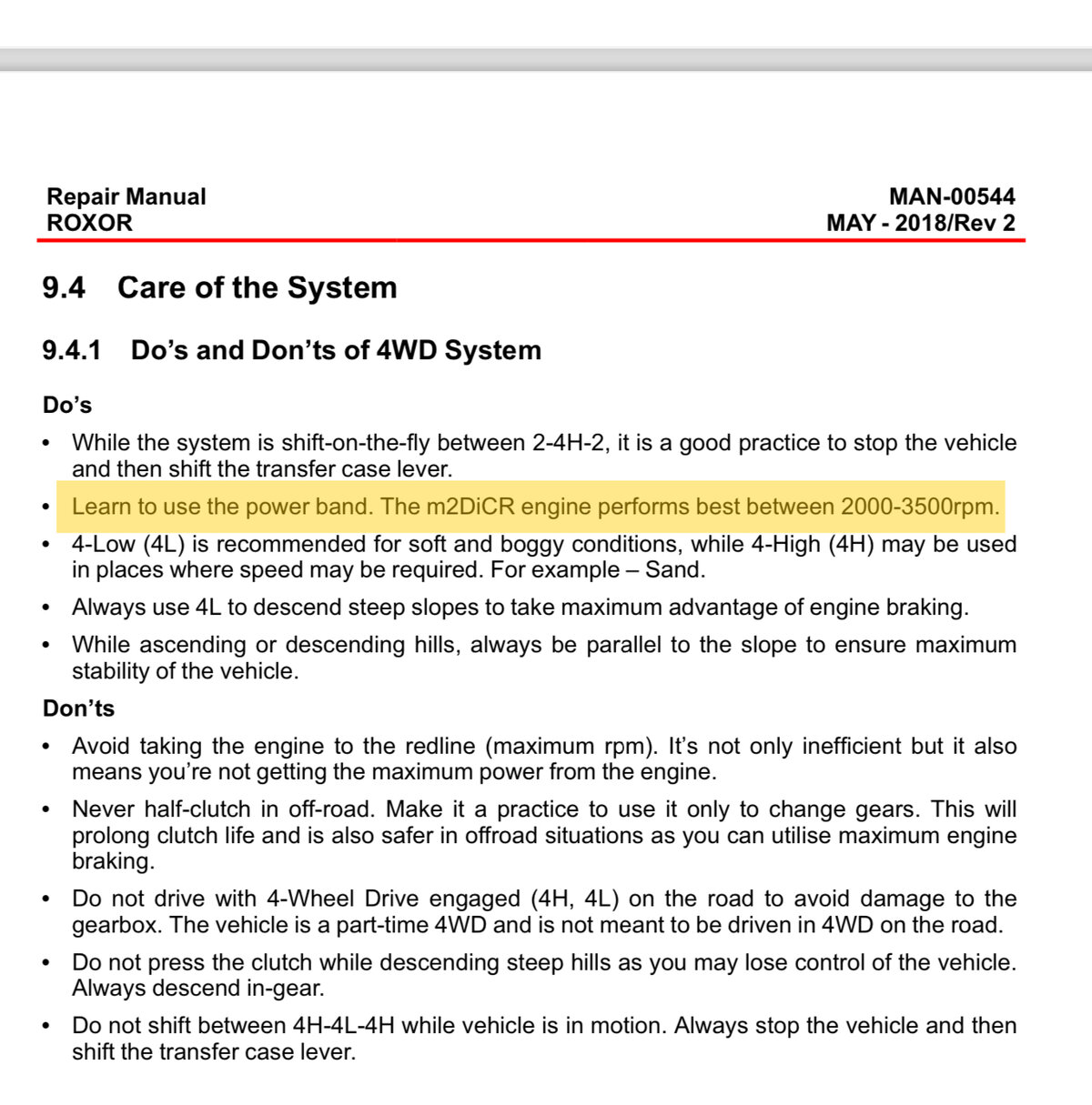

This is what is in the manual for the 2.5, I would guess similar for your 2.7.
