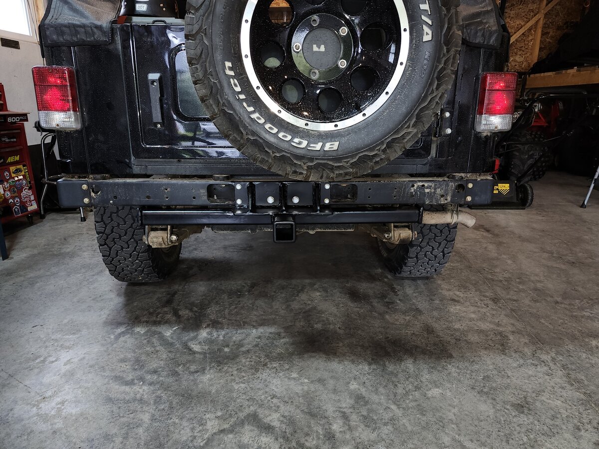

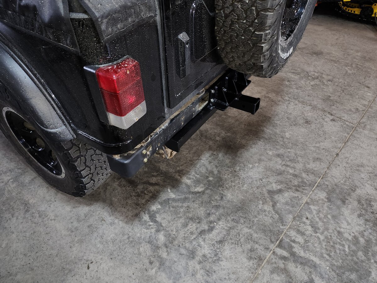

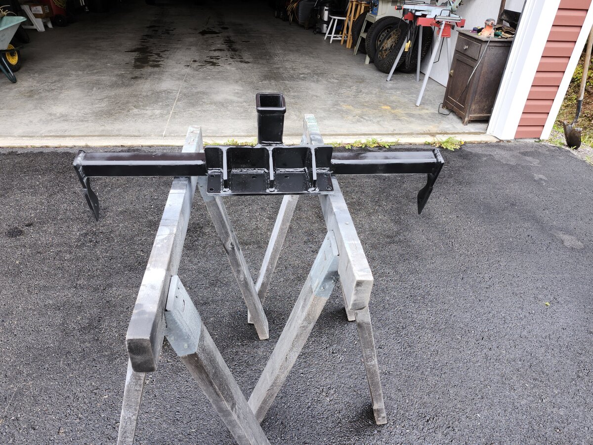

Found this one online , currently fabbing one up similar to this . I'll post pics when I have it done.
Finally warm enough / had some time to get back at it. Primed it and a light coat of paint then install.

Looks very much like the OEM one. I installed the OEM one, and getting the holes located to drill into the box frame to match the holes in the receiver was a PITA, and I made cardboard templates. It would be much easier if you did not create holes in your receiver wings, but instead bolted the center piece up and then pilot drilled your holes where you like on your frame, and going thru the wings, just making sure you have enough edge distance, then disassemble, bring the holes in the wings up to full size and weld on your nuts, then step up the pilot holes in the frame.

6 inch channel bolted to frame , class 2/3 welded on , buy just the stub or make one. Rc
Basically I done what you said 😀.
