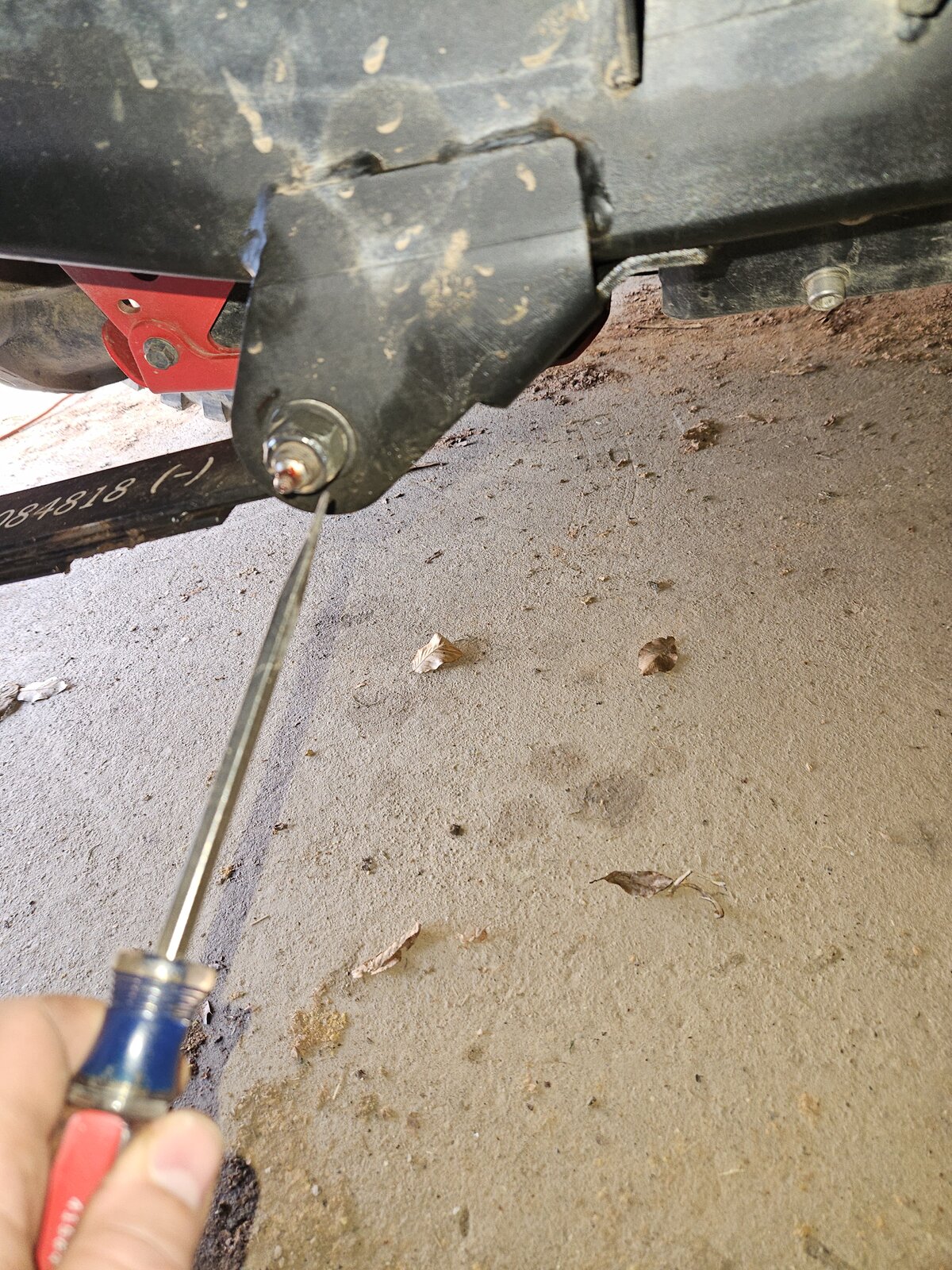

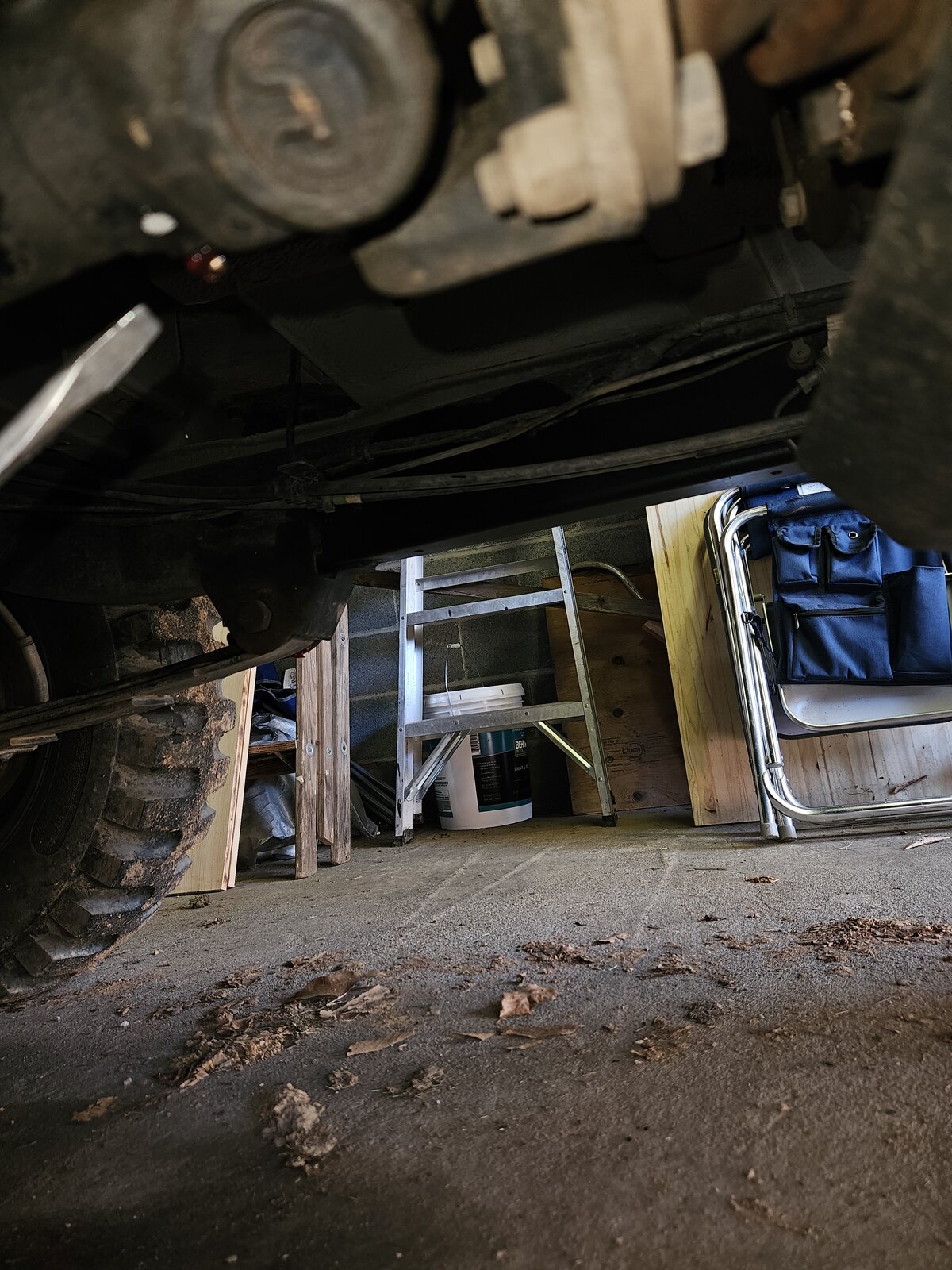

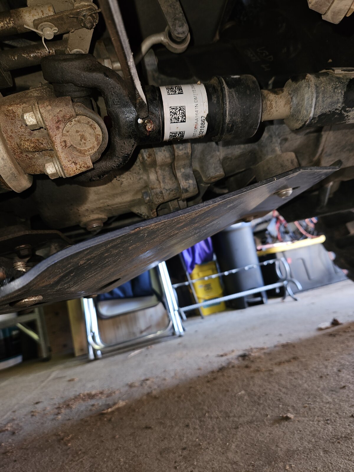

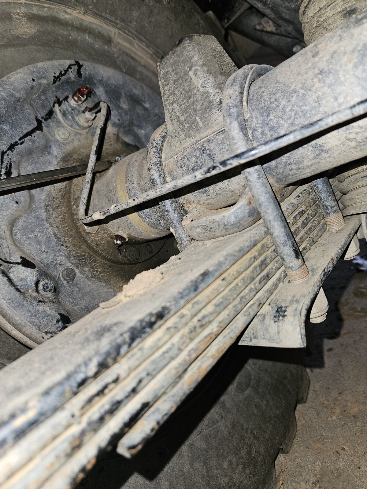

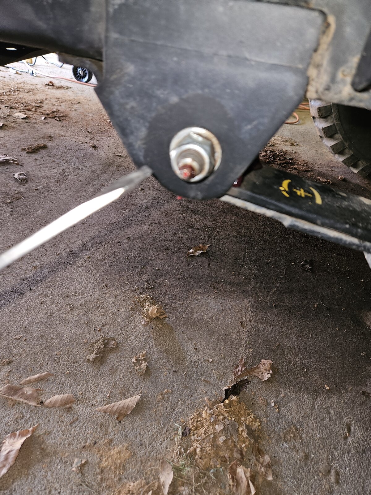

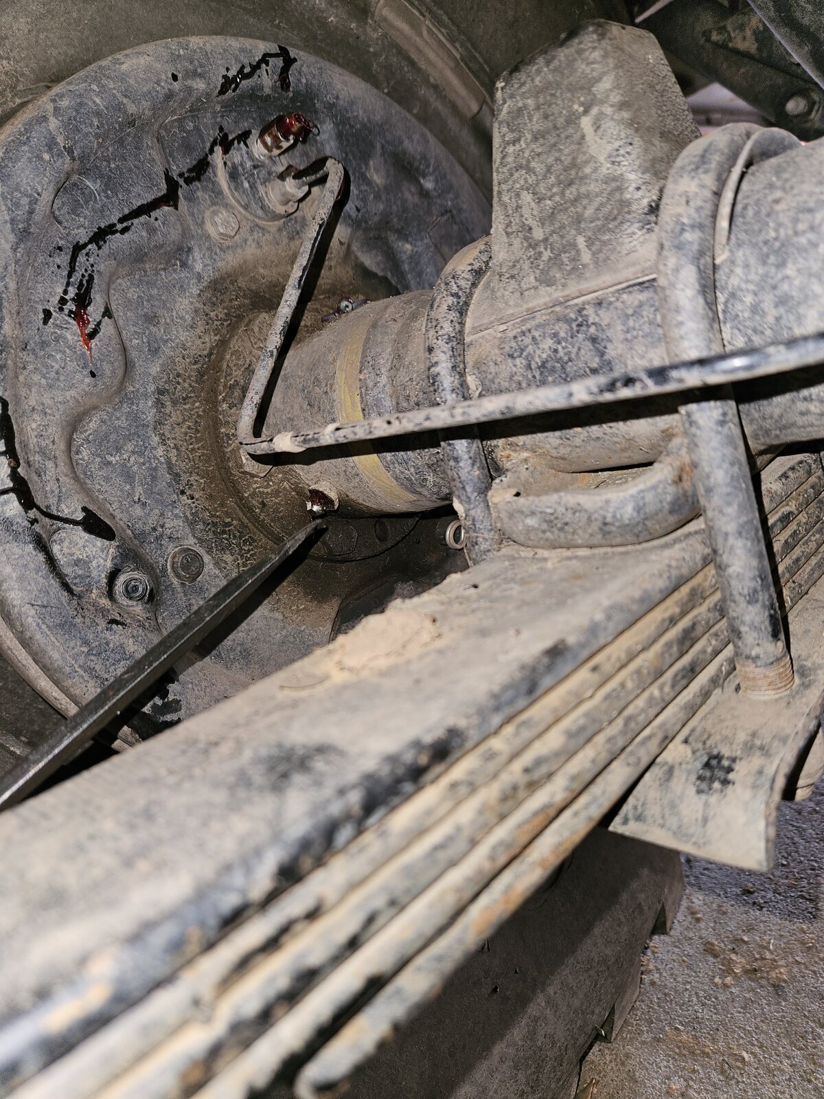

Did mine today, man were they dry🫣. Here are pics of the 8 spots, with screwdriver pointing to them. The rear axel has a tiny hole on the top on each side so you will know when it starts to come out.
20240204_142948.jpg 20240204_142958.jpg 20240204_143023.jpg 20240204_143031.jpg 20240204_143113.jpg 20240204_143120.jpg

Thanks for pointing out the zerks. Rear axle grease points took a bit to see grease come out of the weep hole. Shafts and leaf springs didn't take bur a quarter pump.
