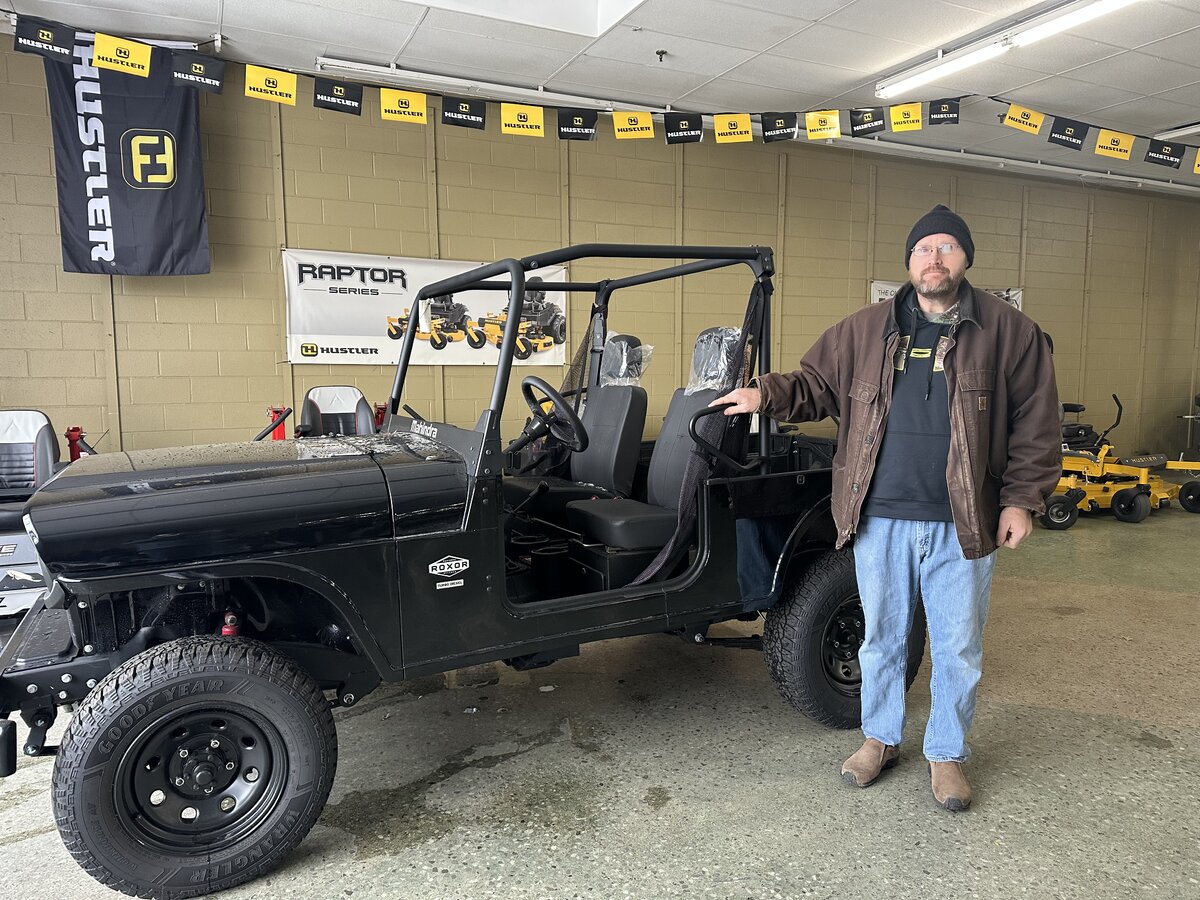

Hope the new one is as good as my old one has been

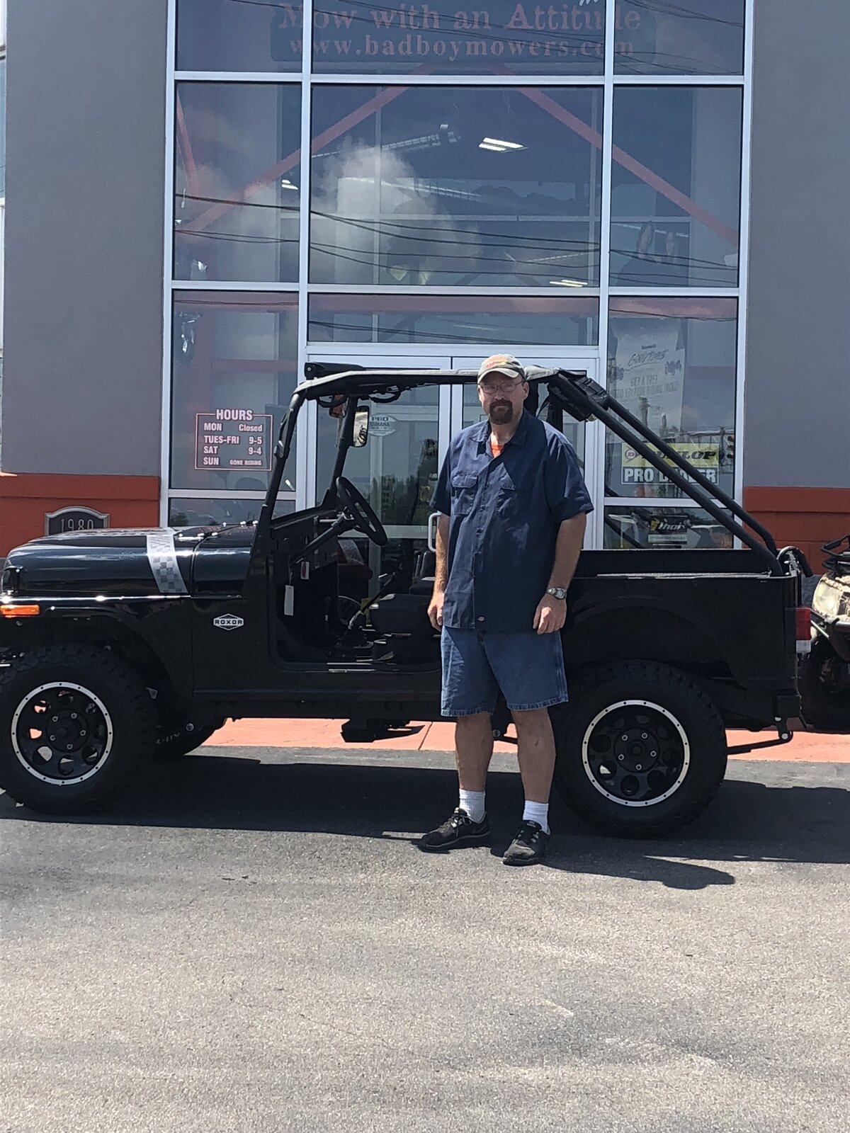

Hope my new one is as dependable as my old one

What happened to your old one
I still have it. I got messed up in Iraq, and I don’t drive on highways or full size vehicles because of my eyes. My Polaris ranger has over 16k miles and my 2018 Roxor is almost at 30k, I was going to get a new ranger, but they are so expensive. A place a couple hours from here is having a sale on the 2023’s, it was only 16,999. My other one has a hard cab on it and a heater, so it’ll be my winter /rainy day one and the new one will be my warm weather one.
