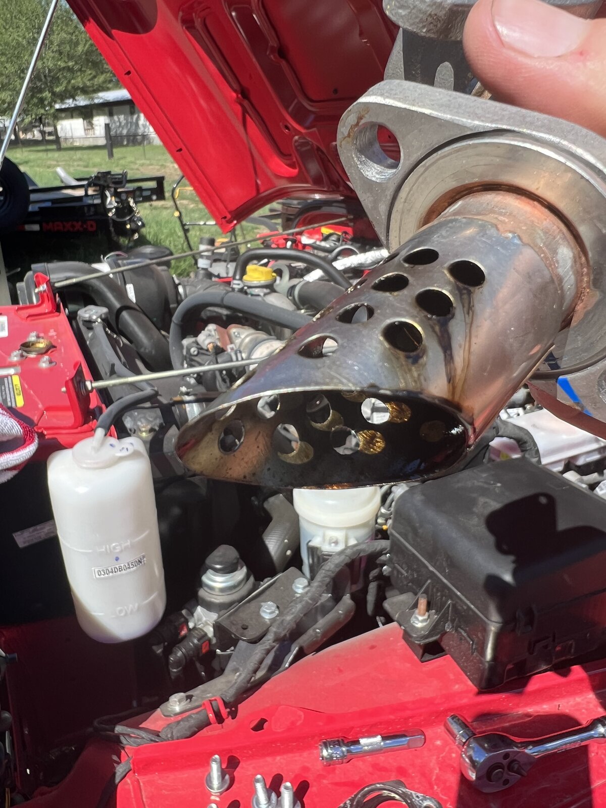

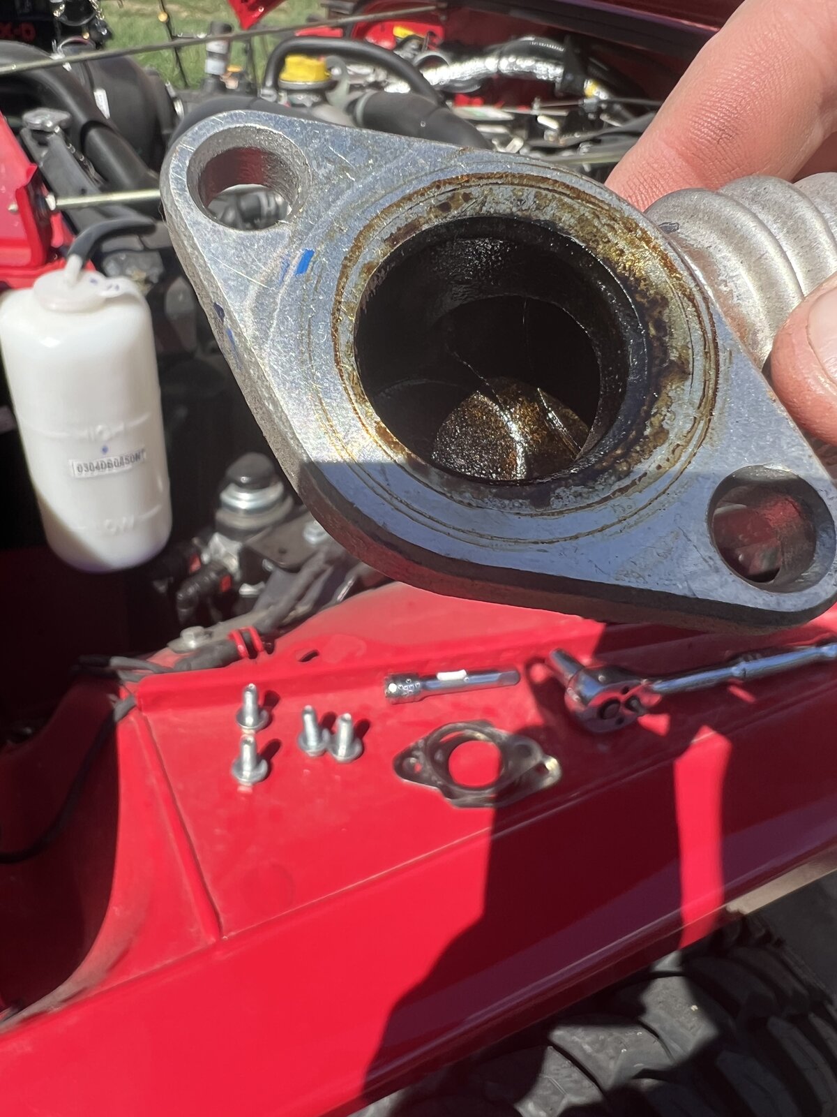

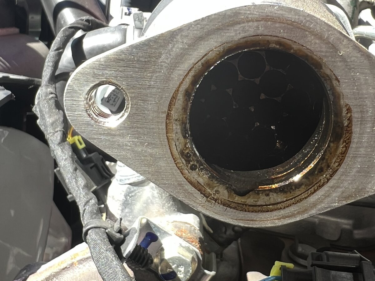

I picked the roxor back up from the dealer. They had to get some software and such from mahindra to scan it. No codes present which is what I found. The ball is still in mahindras court waiting on a reply. I went ahead and made a block off plate for the EGR. When I pulled it out, it looked like it was coated with creosote. No soot dust, all sticky. So far with the egr blocked off it seems to run slightly quieter and smoother. I’ll have to get it back up in the mountains to see if just blocking egr fixes the issue.
